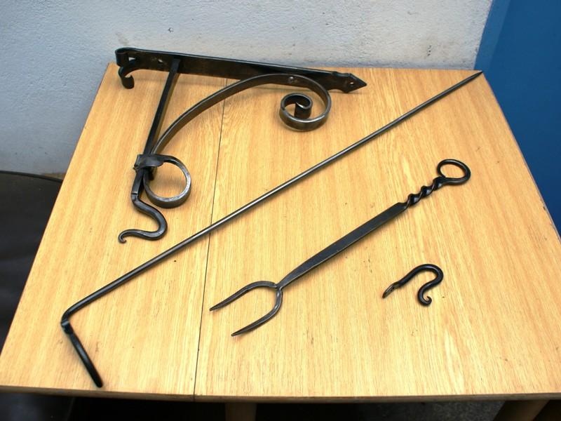

My "basic get them hooked intro class": 1 make an S hook; 2 make 2 nails, 3 make a chili pepper from pipe.  I expect this to all happen in about 4 hours with college age students.
The above is the product over three days of teaching basic skills, they just happen to produce the above items

Instructional content project. A simple J hook. It shows drawing out, scrolling, bending, twisting, shouldering, punching. You can do different scrolls, twists, and finials. You can even make a leaf finial and or chisel in the twists adding in some chiseling or fullering to the list of skills.
For a website instructional how about a simple project like that and show the variation twists, scrolls, finials, etc. Lot of different skills that way.
