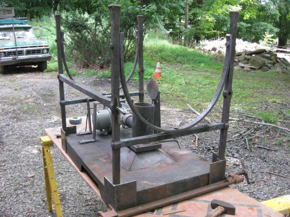

My forge is designed to do much of what you want. The biggest difference is my plate fire pot is welded to the table. If I was doing it again, I'd probably leave it loose to eliminate that weight from the table top. The original incarnation simply used steel folding saw horses for legs. That worked very well, but didn't look all that nice for demos. incarnation #2 used 1" solid steel forgings for the legs. The end pieces were solid, and connected by the cross bar  with tenons and wedges to allow easy dis assembly. The solid square stock fits in 1" OF square tube and are forged down to fit the ID. Eventually I'll either cut the plates that hold the square tube back on an angle to eliminate the sharp corner ( why I suggest not using pins as I've been stabbed a few times by mine) or add another piece that slopes back and better hides that connection.
Other than the table with attached fire pot/blower that is a bit on the heavy and awkward side for one person to move by themselves, they other pieces are very easy to move and assemble. If I had made the fire pot/ blower assembly removable that would have eliminated at least 1/2 the weight of the current table assembly. I have added some detachable wheels so I can move the fore assembled when I'm doing multiple day demos. That lets me move the forge out and out it where I want it, and roll it back near the anvil so I can chain it all up for security over night.

A knock down forge that comes apart will be much easier to move and setup tear down. You can make simple socket connections and let gravity hold it together. That way the heaviest piece will be the table and that's not so bad with the pot popped out.

That is one FINE looking forge, DSW. :) You put a lot of work into the legs and supports.
Makes my simple angle iron frame look kinda primitive (pout...).:(
Edited by arkie
Thanks guys. It took me 2 years of thinking to come up with a design I liked that  performed the function I wanted and had a good look. I thought about pipe legs but I didn't want that look. I still have plans for more upgrades at some point in the future. Right now the lever for the air gate is just a bent hanger hanging from an edge. I'm thinking about adding a 2nd cross bar on the side with the ash dump and air gate that will also hold the lever, but it will have to be arched to accommodate the length of the ash gate lever. Upgrading the clinker breaker is also on the list of upgrades. What I have works, but is inconsistent and jams often if not cleared regularly. Then there's some sort of removable handle for moving the forge, and wheel upgrades to something nicer than the mower wheels I'm using now. Then there's always a hood, tool racks etc and I saw a forge with great dragon legs on it somewhere, ball and claw feet would be neat... As my skills over the years improve, I'm sure I'll want to use my forge to help show case what I can do.
