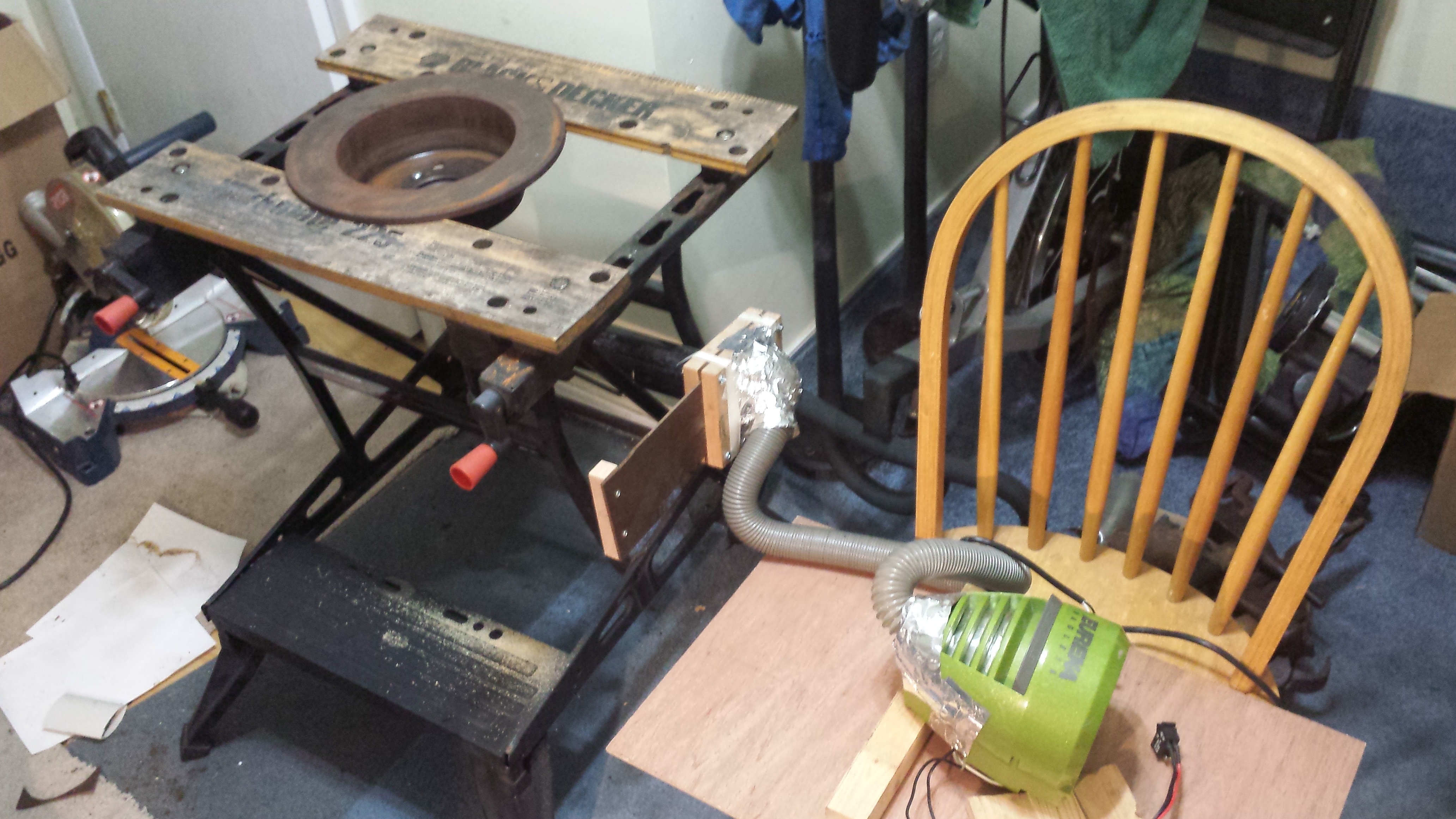

After about four hours of extremely ill-planned mucking about in my workshop/basement/home gym/storage area I present what is undoubtedly the ugliest thing I've ever made. THE COMEDY FORGE mark I The funniest part is that it actually works! It's probably not going to be getting anything to forge welding temp but it will suffice to get me to the goal of "light a fire" by this weekend at which point I will be using a rock as an anvil so I can actually hammer on something. This "apparatus" probably isn't going to last more than a few forging sessions but it is temporary until I finish overhauling my champion 400 and weld together my forge table. Also, I'll but putting some bricks under the brake drum so I don't burn up the workbench and will be burning some charcoal in the first few loads until I get to the guild meeting to buy some coal at the end of the month. Just need to kludge something together out of scrap for the grating inside the drum and it will be ready to fire up.

Arkie, thanks for the tip. Now that I have some access to a welder I should be able to put something together for a proper ash dump, I've seen a lot of good designs for both sliding and lever ash dumps.

Charles, of course you're correct thanks for your comments. I thought about a number of options for my first forge including welded steel plate firepot, commercial cast iron firepot, and some sort of duck's nest. Brake drum won out for me based on the KISS principle - minimal expense, ease of fabrication, proven history of effectiveness. After it's been up and running for a while I'm sure I'll want to change some things about the forge and will hopefully have cash to upgrade to a commercial cast firepot eventually or the welding skills to fabricate a nice plate firepot.
