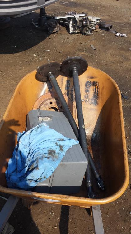

  6. Took a crack at the axel with both a hacksaw and a metal cutting bladed sawzall - no love. Will probably take it with me to the guild meet and see if anyone is willing to help me hot cut off the flanges at one of the guild forges in exchange for me doing some striking for them, or for a chunk of axel!
  7. Arkie, thanks for the tip. Now that I have some access to a welder I should be able to put something together for a proper ash dump, I've seen a lot of good designs for both sliding and lever ash dumps.
  8. Charles, of course you're correct thanks for your comments. I thought about a number of options for my first forge including welded steel plate firepot, commercial cast iron firepot, and some sort of duck's nest. Brake drum won out for me based on the KISS principle - minimal expense, ease of fabrication, proven history of effectiveness. After it's been up and running for a while I'm sure I'll want to change some things about the forge and will hopefully have cash to upgrade to a commercial cast firepot eventually or the welding skills to fabricate a nice plate firepot.

  10. Hello! Just picked up two F150 axel shafts today at my local pick and pull. My question is how to best go about breaking them down into usable lengths. My current plan is to anneal the shaft near the plate at the end and then hacksaw it off, then anneal the rest of the shaft and cut lengths on an as-needed basis. Any advice would be helpful. I have minimal tools at this point but hope to be making a fair number of hardie tools/chisels/hammers out of the axel shaft. I've calculated it out and the price I paid works out to about 1$ per pound for the round stock of what is probably 4340 .

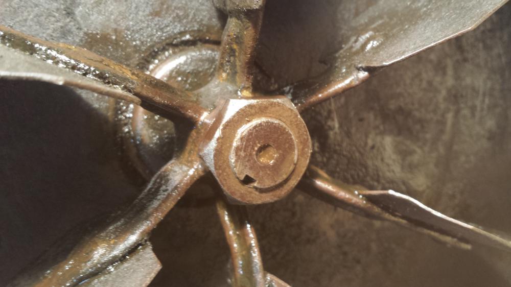

  11. Have you though about paying a machinist to make a replacement?

  13. Bo T, thanks that's very helpful. I'm going to go buy a 9/16" brass compression nut and some propane for my torch. I figure between the jam nut and endless heat, hit, oil cycles this nut will come loose eventually. Man this project is taking way longer than I anticipated. One thing I was wondering was has anyone ever added an oil drain oil to the bottom of the case? It seems like the oil dripping out through the fan bearings washes out all the grease and contributes to bearing breakdown - if the oil could drain straight out of the case the grease might stay in the bearings and prolong their life. Maybe you could hook up a tube to a drain hole in the case and collect the used oil in a jar or something?

  15. Bo, did you just screw the nut and jam nut down all the way so they held the shaft in place or where you holding one with a wrench while you went at the fan nut? Not sure how to apply the jam nut principle on this application. Need to pick up a propane take for my torch so I can really heat up that nut, continuing to put liquid wrench on it every day.

  17. Bo T, I had luck using a small adjustable wrench on the flats of the cone to remove it in back if that helps at all. I'll search through my collection and see if I have anything to try as a jam nut. I've been trying the heat, penetrating oil, tap, repeat process this morning but no luck so far. I think I need more heat, have been using wooden matches Will pickup a long butane lighter and try that. Either that or I will try my soldering iron. I'm beginning to grasp why the guy at practical machinist recommended applying anti-seize compound to to the fan shaft before putting this darn nut back on.
