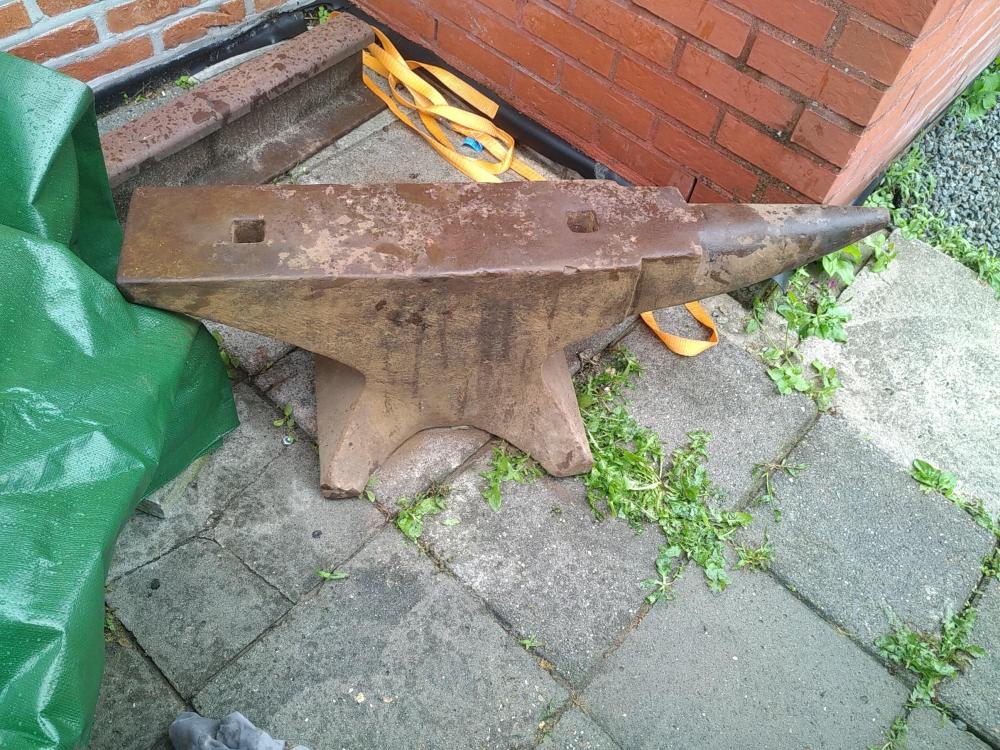

Having said that, this is what i bought this week:929328576_SohoAnvil1.thumb.jpg.0aa0ad4782ae221ab7c96bc7906a2172.jpg
It' might not look that big on picture. But it is a 88cm long anvil with a 15cm face width and a lot of meat underneath the face.
Seeing the 2 clean hardy holes and the stapless cutting table, I assume it is at least comparable with the soho pattern anvil you guys are talking about.
Offcoarse it is not nearly as elegant as a Peter Wright. It even looks almost more like a german style anvil then an english or a London pattern anvil to me. (Found it in Belgium so that might make sense.) But the barely visible weightstamp (on the other side of the anvil) are in hundredweights.  The hundredweights are well separated from the anvil but not highlighted with a clear dot.
I thought for a moment, it might be a Mousehole anvil by the information i found on the web. But then the hundredweights should be on this side on the anvil.
Anyway. I don't really care that much which anvil it is. I'm not even a bit of a blacksmith yet. Just another fool with an anvil in his workshop.
But i'm quiet happy with this anvil. I'ts in used but good condition. It doesn't ring but has a decent rebound and i'm looking forword to get myself a stump for this bad boy.
Oh yeah the weight. Well I don't even see the hundredweights. the quarters should be zero or 2 and the pounds 24.
I think it is just possible to lift it with 2 people. Butt it is just wrong to do that.
So my best guess is: 3   0   24 = 360 pounds =163kg or maybe 3   2  24= 416 pounds = 188kg

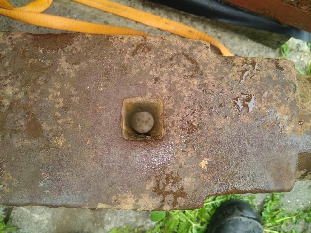

Oh yeah, just wanna show you how the hardy hole near the horn looks like.
You can clealy see the transition from square punch to round punch. (the other way around infact.

Don't fret about opening old threads. Most of us are happy, to either review or read old ones we missed, or in my case forgot about.:D Thanks...
1 hour ago, PietjeSmee said:
posting on an old topic.
It looks like you have an excellent anvil
Welcome aboard gad to have you. Don't apologize, yours is about the best example of section selection for a 1st time poster I've seen in a LONG time. Old threads are archived for just this reason, what you wanted to ask was partly covered in an old thread. You did it just right.
Sorry, I'm not one of the anvil gurus on the forum but one will be along shortly I'm sure. Do you have a scale you can weigh it on?
It looks good to me, have you used it?

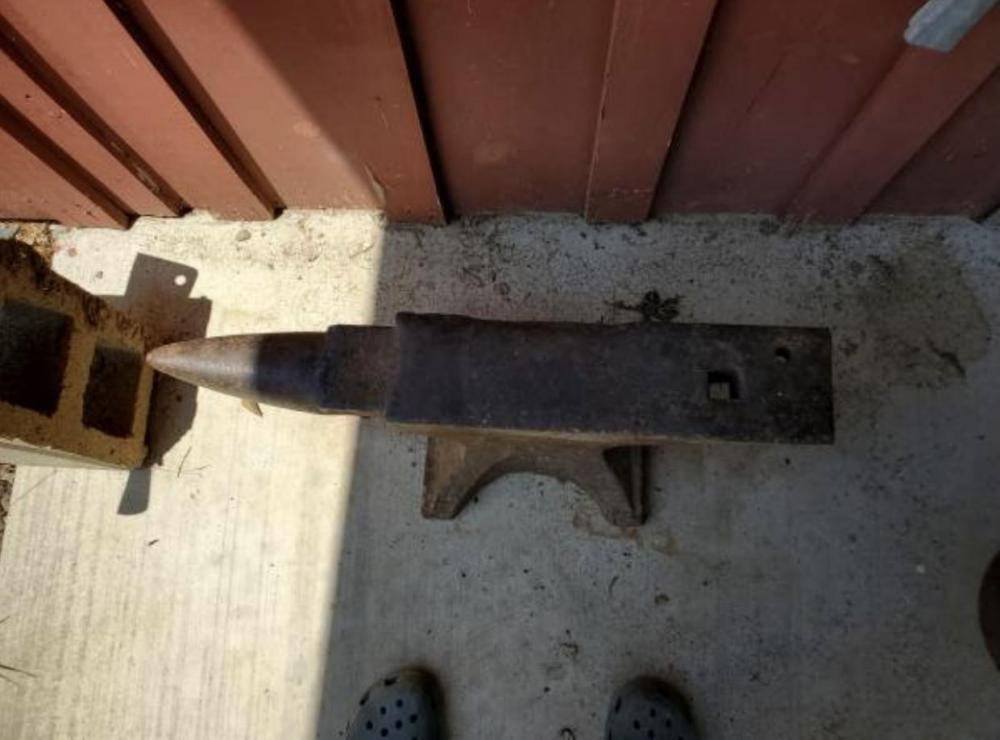

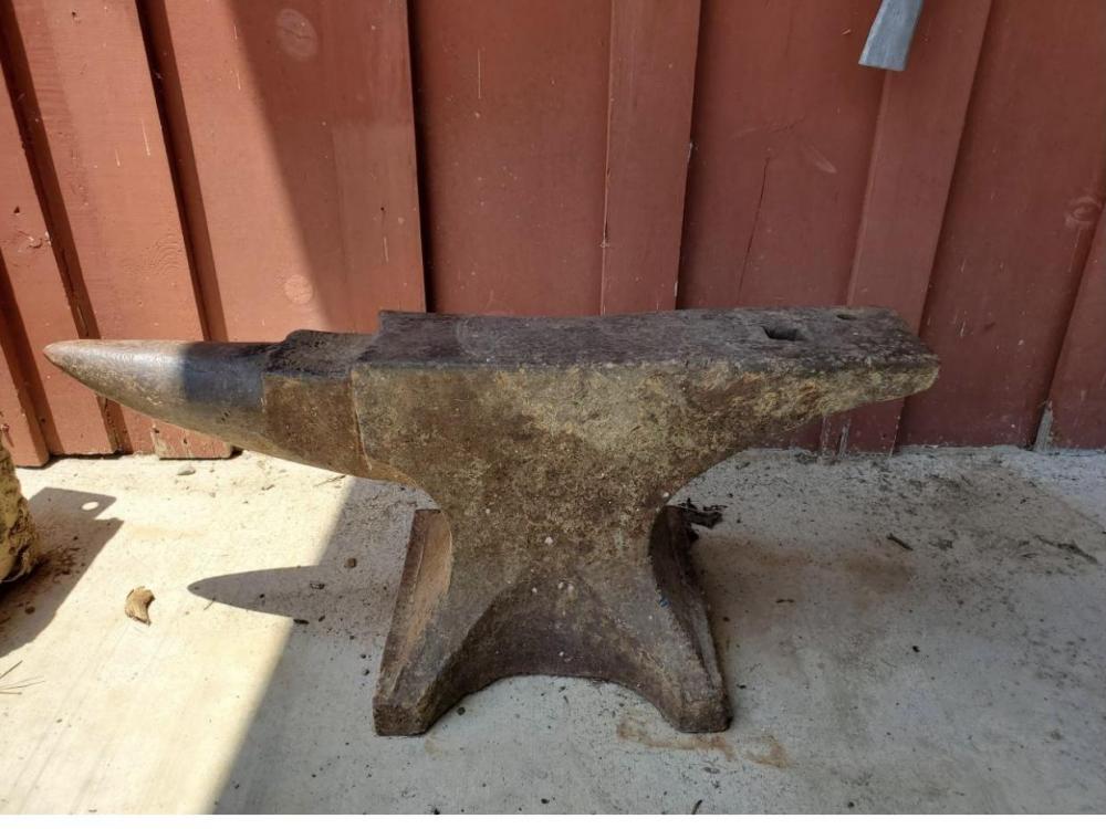

Not to highjack the thread but Since yalls already talking about Peter Wrights I was wondering if I could get yalls opinion on one im going to look at this weekend, the guy said it weighs 234 pounds and he wants $500, I guess he has had it for years and he’s only ever used it for decoration, I asked about markings and he said that he saw Peter Wright on the side but he hasn’t looked for anything else. He says it’s 28.5” long and 12” high, I’ll bring a ball bearing with me when I go, and a hammer to see if it rings. But I’m a little concerned about the drop from the face. It looks like a pretty good dent is in it. Sorry these are the only two pictures I have of it so far and they are not very good.
    Already have a 94# and a 124# Peter Wright but I’ve been wanting to find something a little bigger.
FD7FB71B-7B9D-4291-97EB-4C29514A039C.thumb.jpeg.5a9d3be3ff069c13efbab239901d7950.jpeg4B6FB9ED-A1EB-4118-A92E-8C75E3A639A3.thumb.jpeg.22404ddffffc2d1a2460ab6a222cbb99.jpeg
I zoomed as well as I know how and it doesn't look so bad, especially for under $2/lb. The face plate does have an appreciable swale, it might be a Vulcan or maybe just used hard. It doesn't appear to have any serious dings though.
I'd pick it up provided it doesn't show some obvious flaw in person. Even if I didn't like it I could pass it along for almost as reasonable a price without feeling like a fraud.
I don't think it's a Vulcan, looks like a Peter Wright to me. If it passes the ring & rebound test, I would be all over it. The sway wouldn't bother me and 234 pounds it would be a nice shop anvil for me.
Thanks for yalls input, I plan to go see it Sunday, Irondragon, I thought the same if it passes the tests then I planned on buying it,  I just was worried about that spot up front.
    But on the other hand the price is pretty reasonable and it’s getting fewer and farther between that I’m finding used anvils at that kind of price.
I agree it looks like a Peter Wright. Looks like a good anvil to me.
2 hours ago, TWISTEDWILLOW said:
that spot up front.
It looks like someone either modified the step for a specific purpose or they did a lot of work using the step and it developed the curve.
