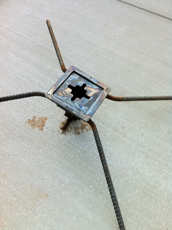

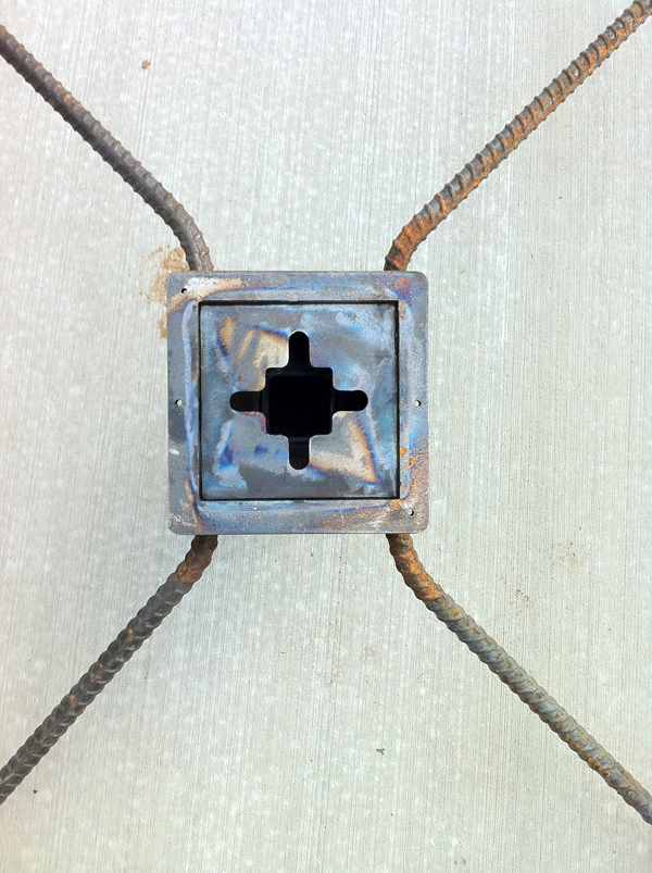

I am building a new shop on my property, 25'x36' I have the foundation poured and am about to pour the floor. I was thinking of embedding some items in the floor and was wondering if anyone else has done this and is it worth the effort ? The items I was going to embed into the floor are a socket for a 5x5 post and 6 plates with threaded holes and a four way slot to insert a chain. The latter embeds would be for pulling objects.

Thanks all for the ideas. I have decided to use a hybrid of my original design and gazintas. There are four in a grid pattern. I welded them to the rebar so they are mutually grounded.

I made eight then decided to us only four. so I have 4 spares sitting on the concrete :)
