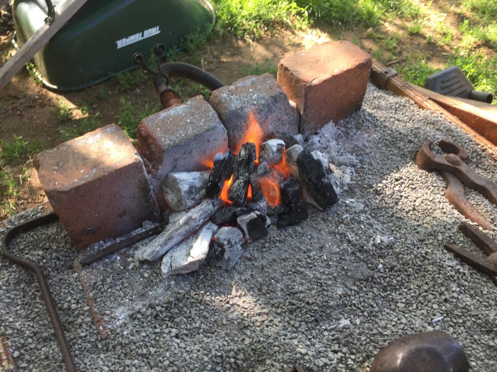

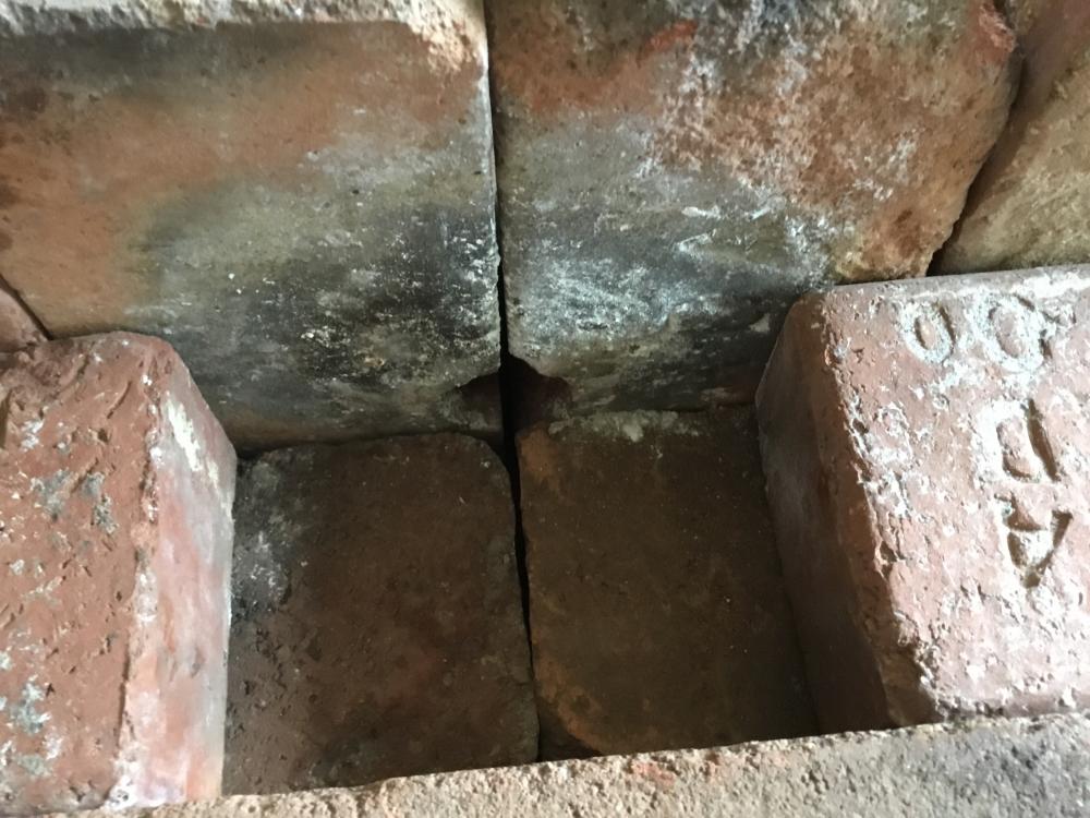

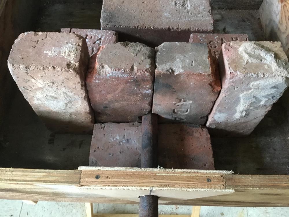

Dont even need to get that fancy, if you are using bricks anyways, stack them to make the tuyere channel, just stack two about an inch apart and make a roof out of another one, place your blower pipe in the other end. Black iron will burn up, even clay-coated. If you are concerned with air loss, bring a small amount of clay with you, wet it until you have a paste, and use it to mortar the bricks together at the pipe end. When you pick up to go, wash off the clay and away you go. Easy peasy.

That’s an idea Charles. I might have to try it. And JHCC I want to try using a dry tuyere because I was hoping to make it kind of compact. But please indulge me on how it works and how it is so important maybe you will change my mind?
A water tuyere (like the one I just built) circulates water within an outer shell and around the blast pipe to keep them both cool. This in turn both keeps the tuyere from burning up and keeps clinker from sticking to the tuyere. Some of the water evaporates, but not much. Just add a couple of gallons before a forging session, and you're golden.
A dry tuyere is simply any tuyere that isn't a water tuyere. If you use a pipe encased in clay or sticking through some bricks like Charles shows above, it will certainly take up less space than a water tuyere, as well as being easier to construct. I used a plain pipe in my JABOD, but I love the water tuyere and I ain't goin' back no more.
For a beginner, a simple JABOD with a plain pipe is the way to go. Once you have some experience and know a bit more about what you like, then you can start playing with variables.
