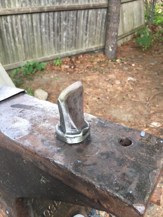

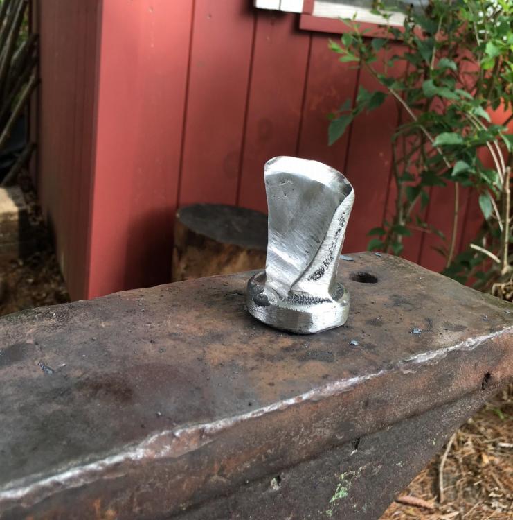

  8. I'll second the jackhammer (pavement breaker, really) bits. THat bucket pictured above was indeed mine. I got those for nothing. I stopped by a tool rental place and asked if they had some spent ones. I offered to pay, but the guy said no - he'd rather give them away than bother making the trip to the scrap yard for the pennies he'd get for them. I am going to make him something from one of them and give it as a gift. The only downside is that they are a pain to hammer, but it's a good lesson. If you have a 1" hardy hole, they don't even require that much hammering to square up the shank. he built-in collar is awesome. Here is the hot cut I just finished yesterday from one. I left the shank long so that if it gets stuck, I can tap it from the bottom. It fits snug, but not "tight".
