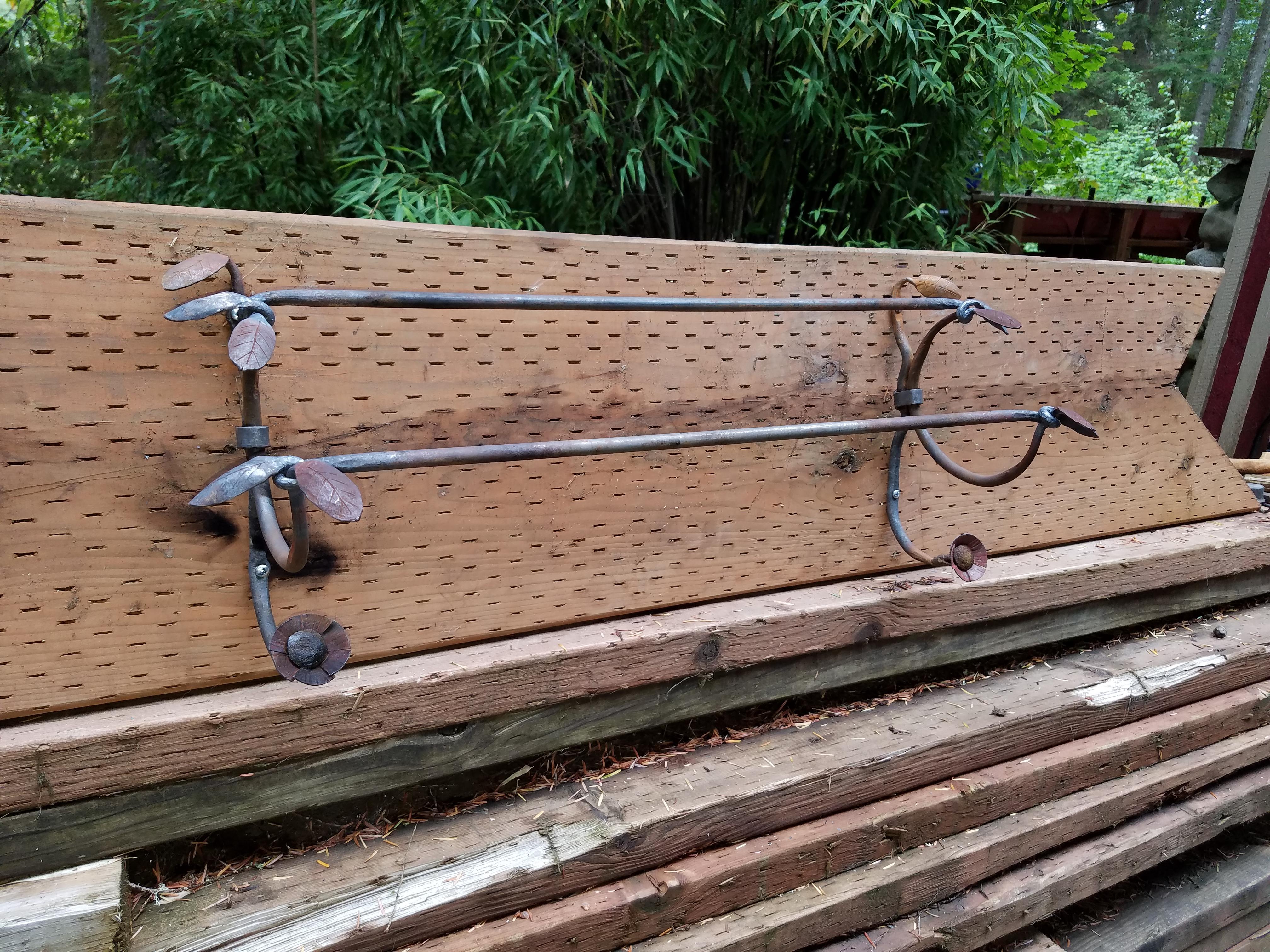

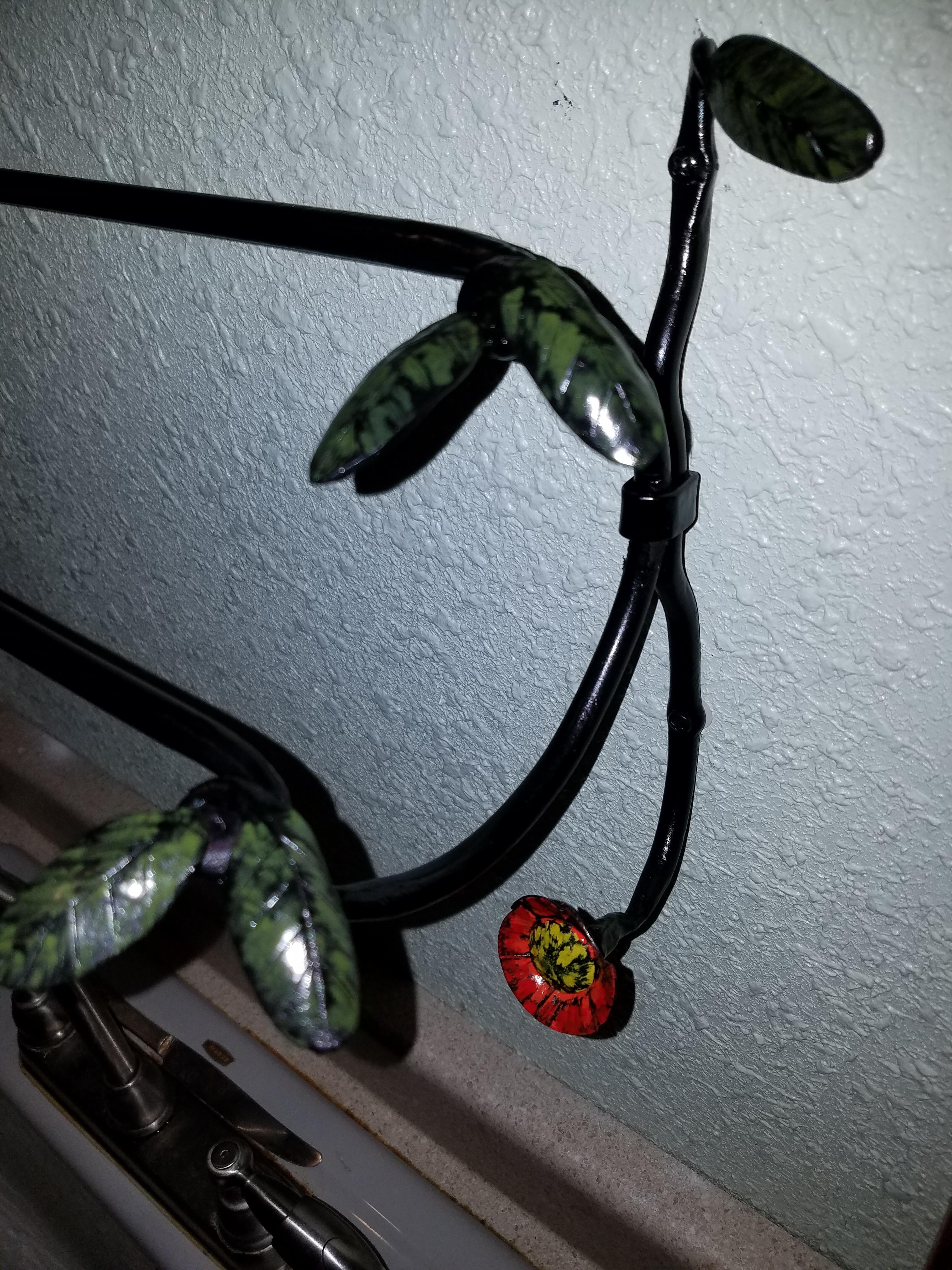

The coloring was with Testors model paint followed with 2 coats of clear coat. I tried to do a dry brush job so it wouldn't be boldly overpowering colors. Now my wife wants more towel bars

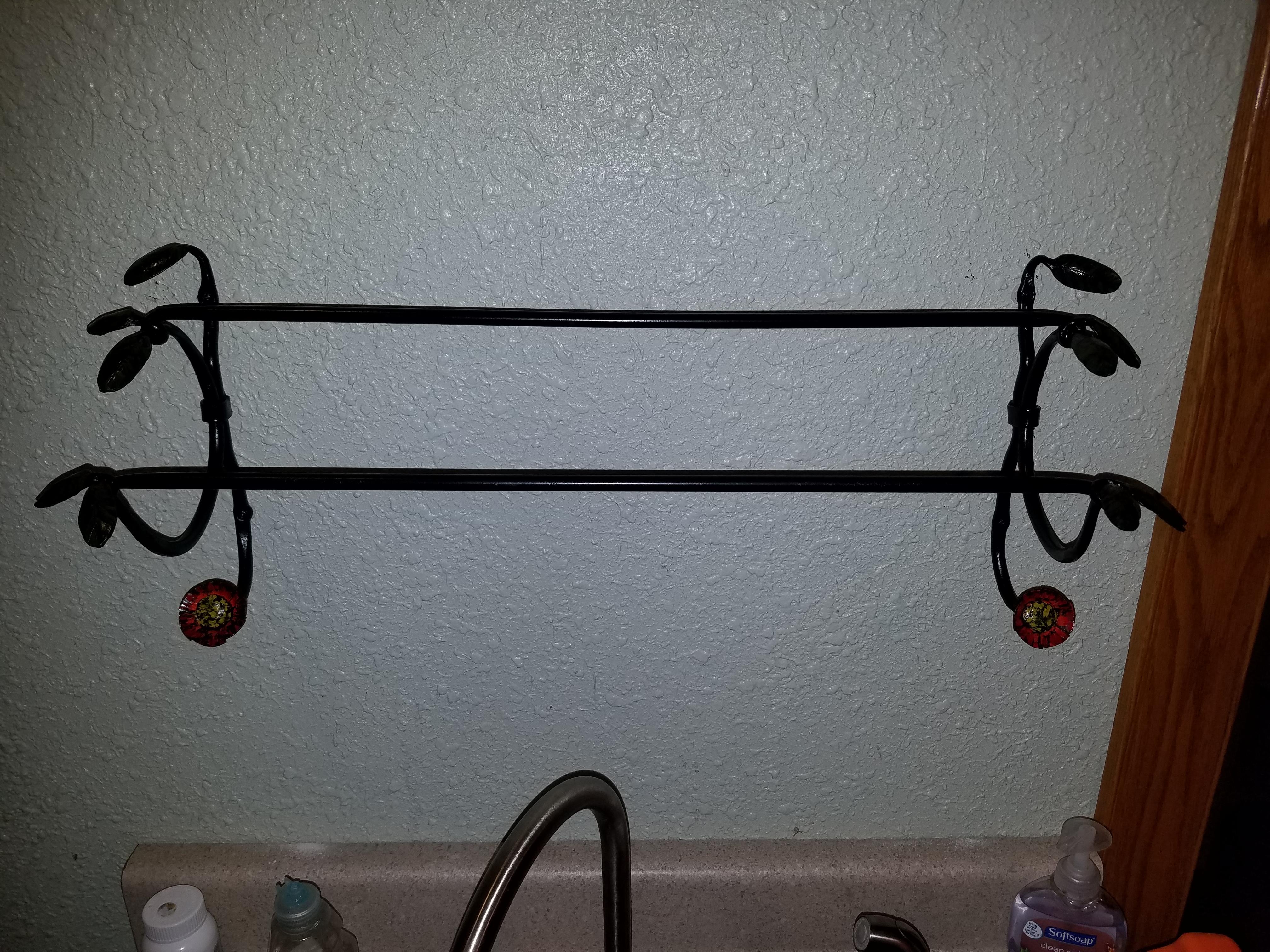

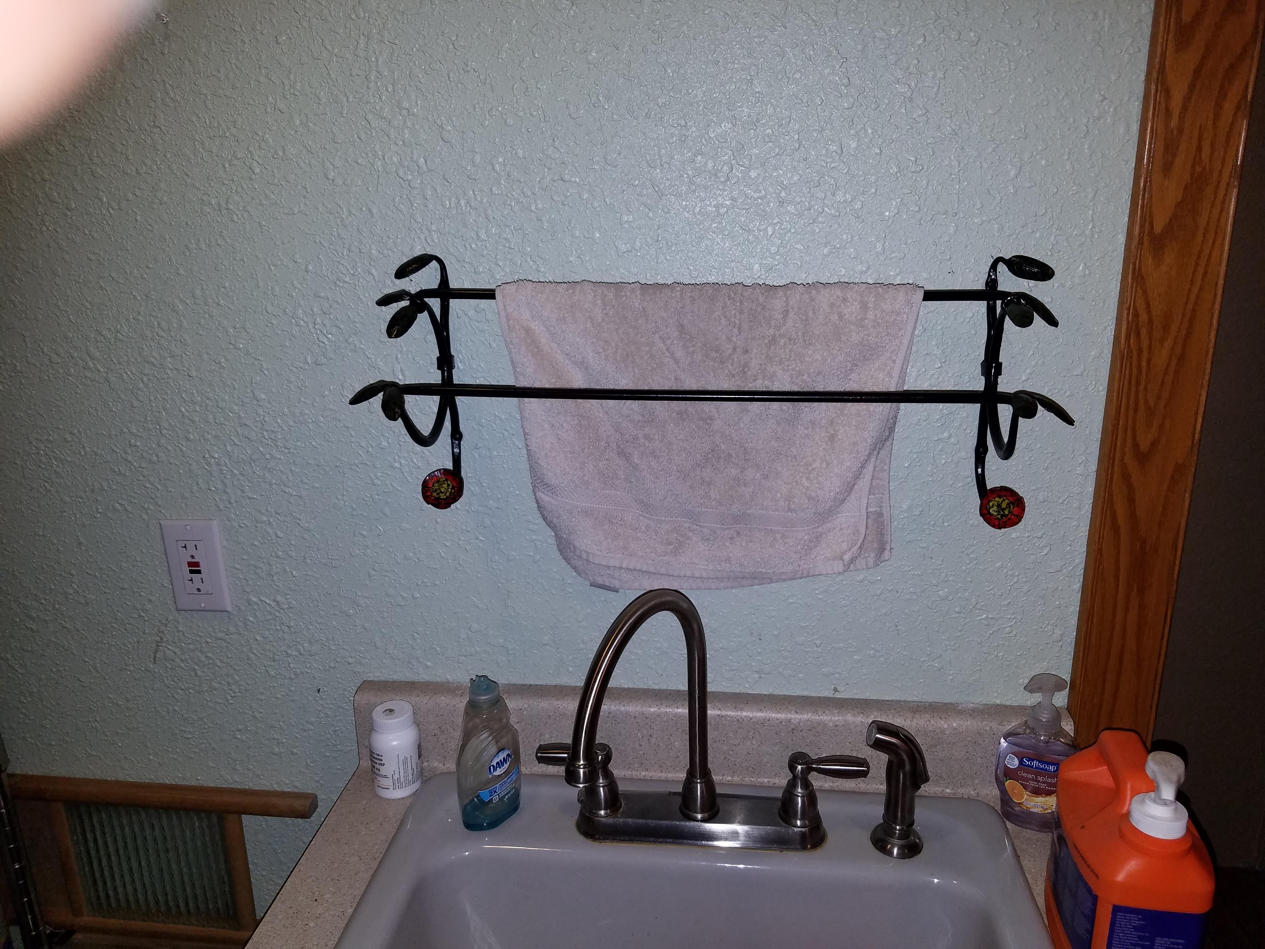

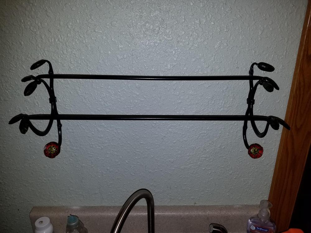

Glenn, thanks for the comments. The towel bar is going over a sink where the is no possibility to run against it. There aren't any catch points and it's getting painted then an automotive clear coat. I like the vinyl tube idea but I'll see how the finish holds up first
I finally finished a towel bar for my wife. It will go above the sink in our laundry room. It has taken me months to figure out all the elements and bring it all together. I don't get enough forge time. I'll finish it with paint and a clear coat. I don't want rust on the towels.
