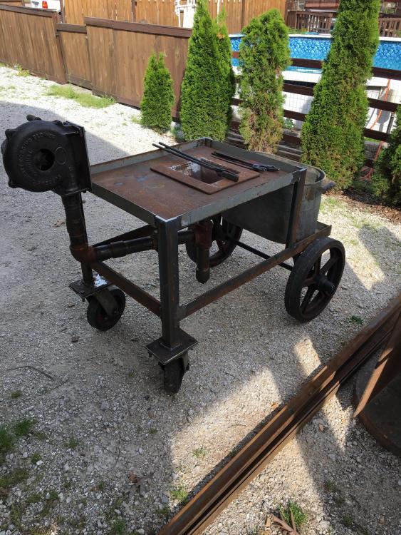

Arkham replied to Arkham's topic in Blacksmithing, General Discussion
Oh yeah, it rolls real nice. That was important to me, I was wanting to make sure it would be easy to move in and out of a small shop. Those wheels have all cast iron spokes and hubs, they each weigh about 50lbs. -

The fire pot measures 8"x10" at the top and 3"x5" at the bottom its 4" deep. I welded it up out of 7/8" plate. I had considered opening up the angle as you have suggested, it just slipped my mind. I will do that now for sure. -
So I had a couple of days off in a row and I used my time to finish up my forge. I plan on removing the pipe plug and adding a proper ash dump as well as adding a tool rack somewhere. Sure would love any input. I plan on heating some iron either later today or tomorrow depending upon the weather.
