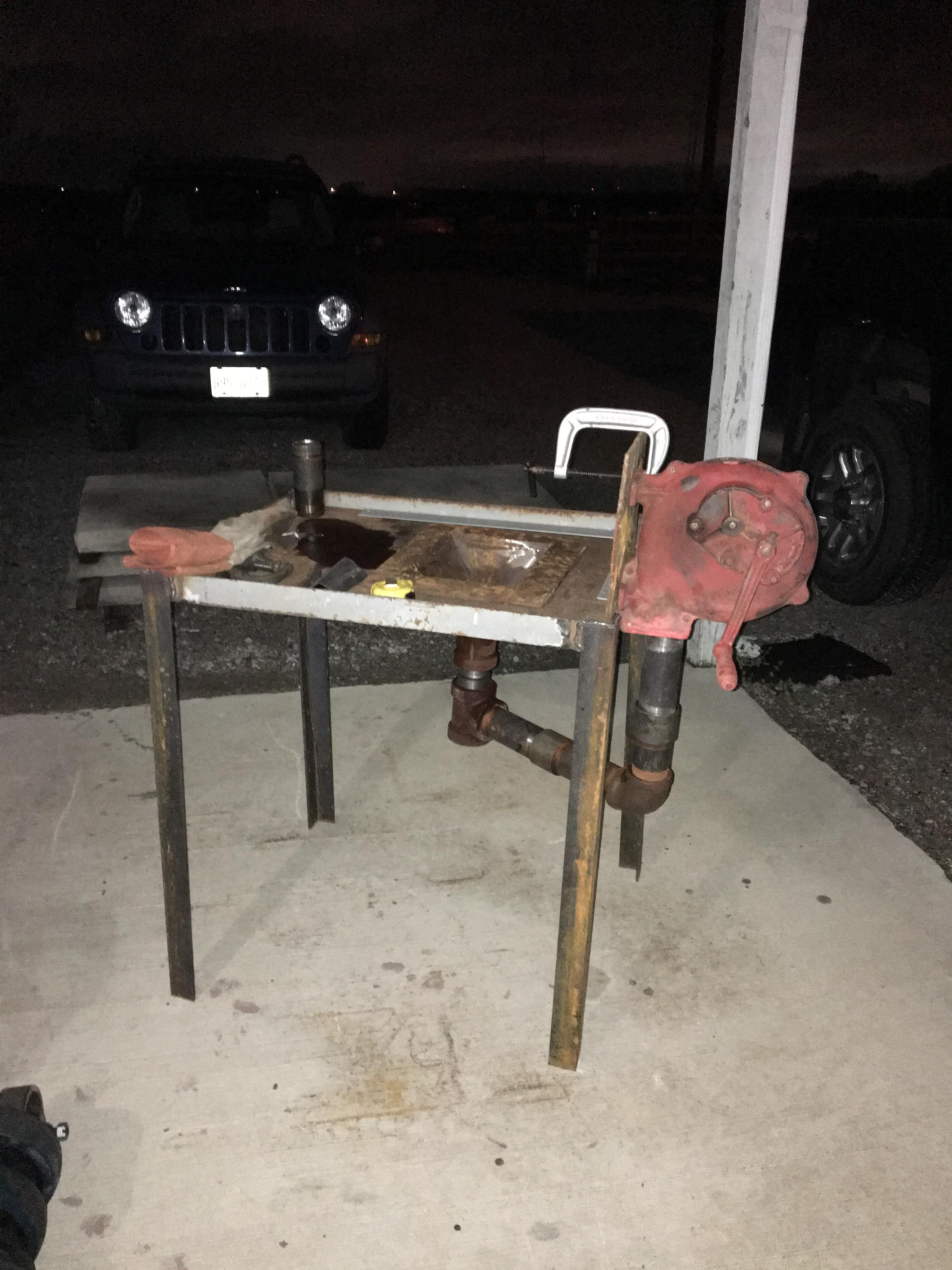

  2. Kevin-Thanks for the advice about the extended pipe on the ash dump, I hadn't thought of it that way, and I probably would have gotten burned. (pun intended) Frosty-I agree, there needs to be more stability in the legs. My final design will have wheels on it so I have decided to wait and see exactly where/how I will install them. Thomas-My blower is pretty smooth as is, but I will be restoring it anyway. Thanks for your advice on the forge. I have read a lot of posts on this forum, I figured if two more curmudgeons answer my post I will get those 13 well reasoned and experienced answers. By the way that Swallow you guys are always asking about, is it European or South American.

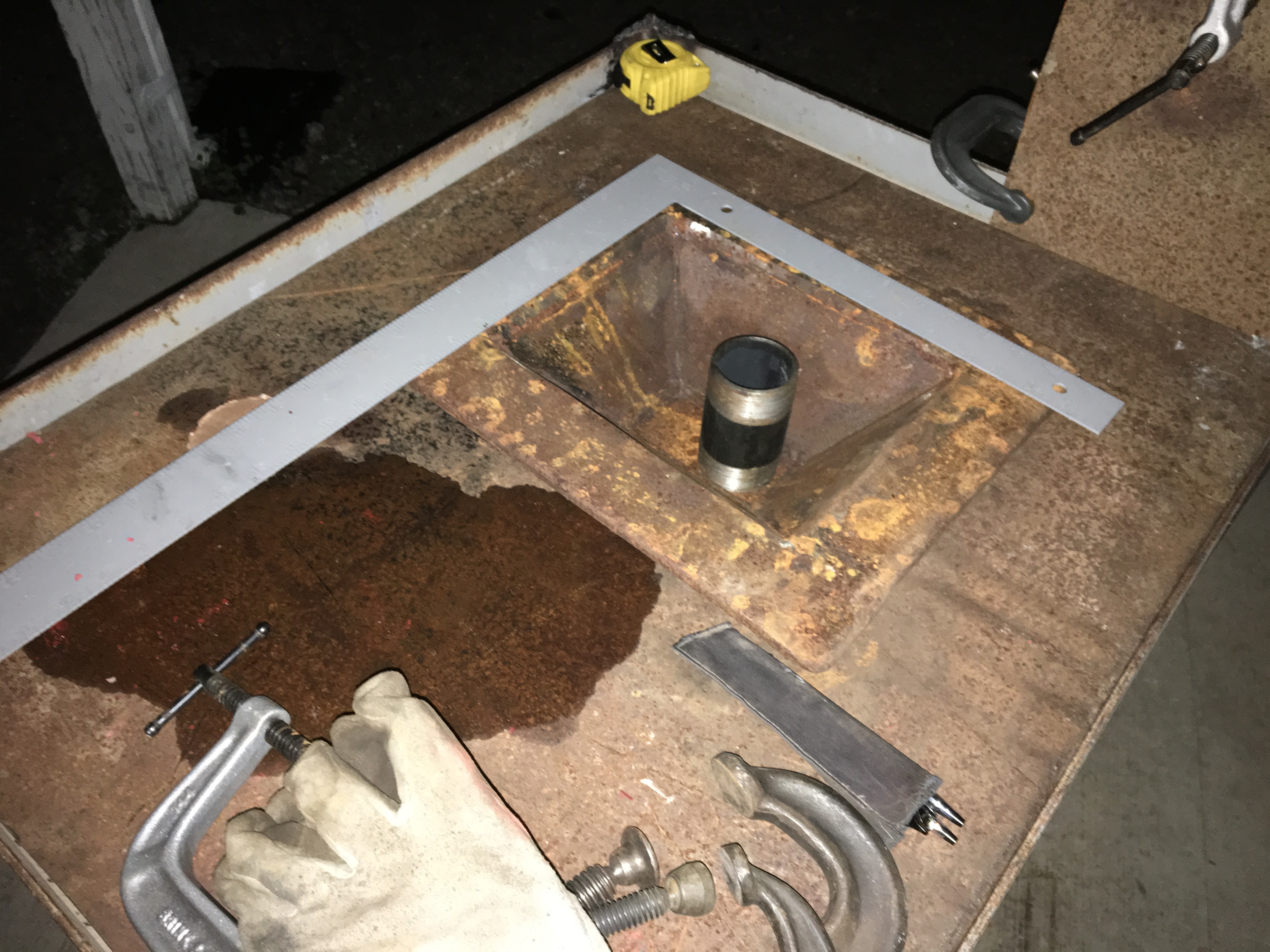

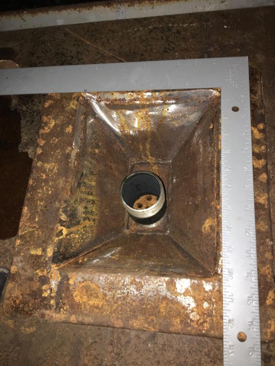

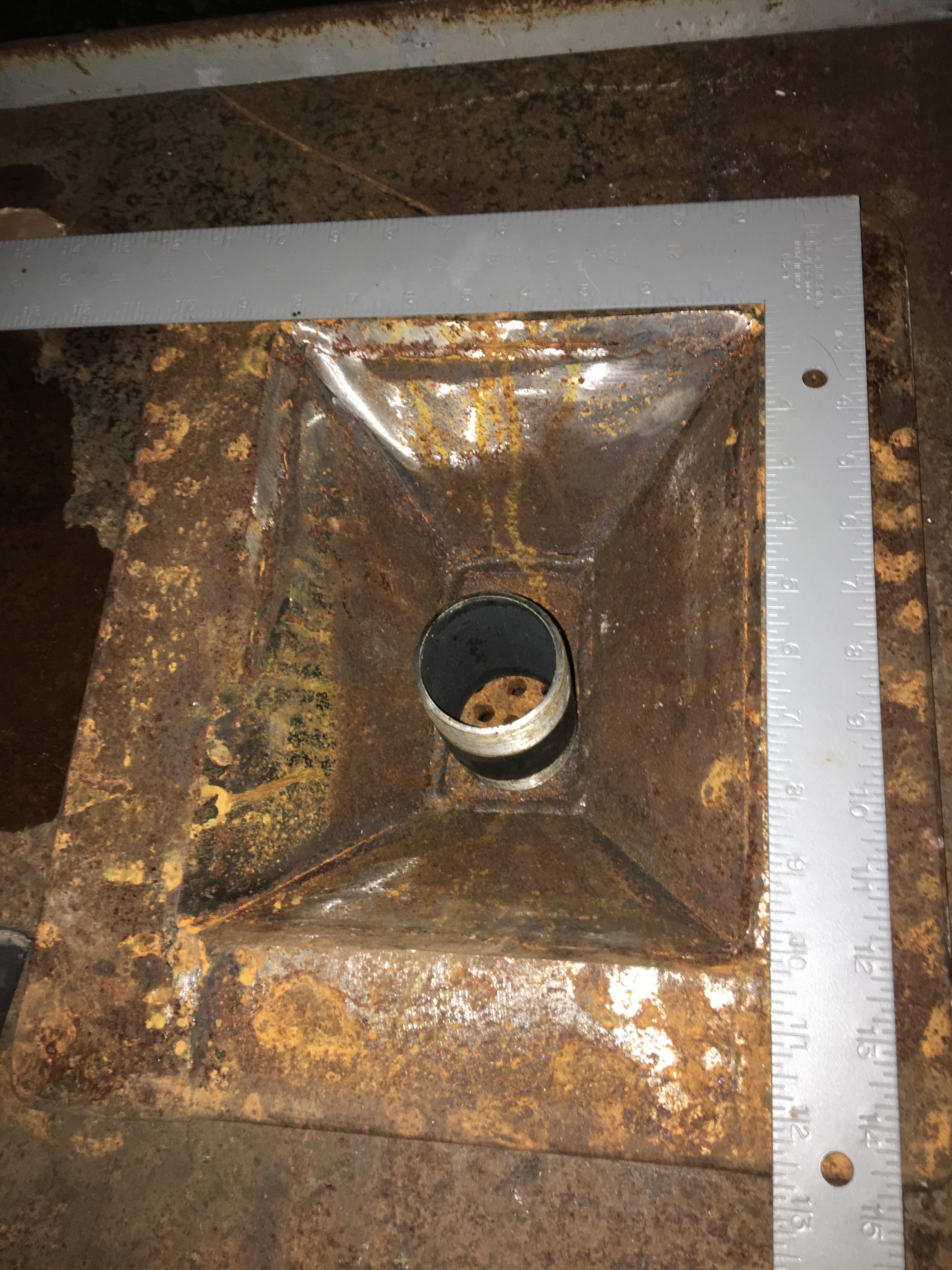

  4. So I have been lurking on this site for awhile and finally subscribed a few weeks ago. I've been reading all I can and YouTubeing hundreds of hours of blacksmith videos. I have been real fortunate to have picked up three nice anvils a couple of post vises and a hand crank blower. I stopped by the scrap yard and purchased some plate steel and angle iron a few weeks ago and today I started building my forge. The blower is not permanently fixed yet, I was not sure if this is the proper location, I was hoping for some input. The fire pot is constructed of 7/8 inch steel with 3/8 inch flange around it, I welded it a few months ago and it's been sitting next to my shed, it measures 8x10 inches at the top and 3x5 at the bottom, the 2 inch pipe nipple that is sitting in it is 4 inches long.

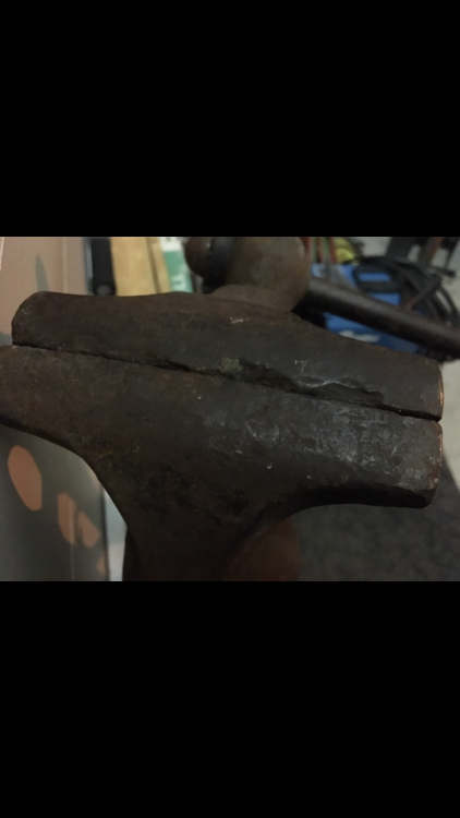

    So I have this vise, and the jaws are kind of rough. Is it okay to weld on them and then grind them down smooth, or is this a bad idea? If thee is a better way to repair the jaws, I would love some feed back.
