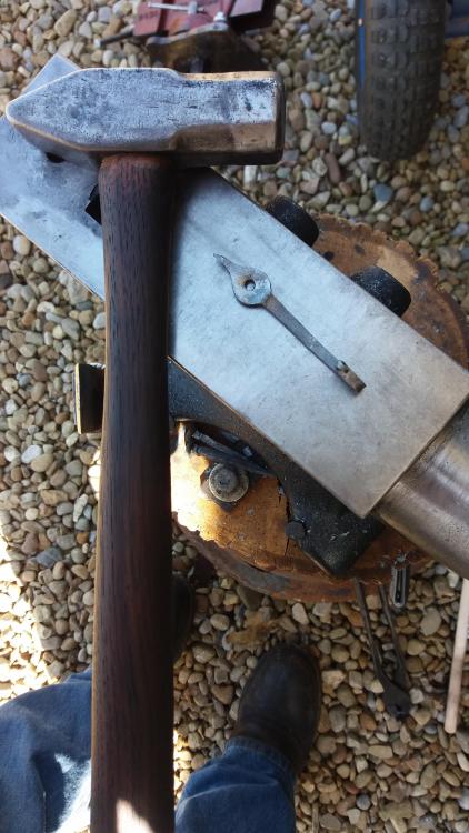

SReynolds Posted April 13, 2017 Share Posted April 13, 2017 These are fun (to watch students make) take you a box of horse shoe nails and forge a flame finial. The scroll an eye and then a hook. Punch a hole cold in the thin finial. You could teach nail making and forge the flame hook from that. But the head needs to be beefy and paper thin wafer. Another episode I use is the nickel - sized circle from the same nail. Ultimate lesson in hammer control. Quote Link to comment Share on other sites More sharing options...
Arkham Posted April 13, 2017 Author Share Posted April 13, 2017 I much prefer these hammer control type exercises, tapers and s-hooks. My family has been telling me that I was born in the wrong century for sometime now. Taper/Upset-Wax on/Wax off Quote Link to comment Share on other sites More sharing options...
Ranchmanben Posted April 13, 2017 Share Posted April 13, 2017 2 hours ago, SReynolds said: These are fun (to watch students make) take you a box of horse shoe nails and forge a flame finial. The scroll an eye and then a hook. Punch a hole cold in the thin finial. You could teach nail making and forge the flame hook from that. But the head needs to be beefy and paper thin wafer. Another episode I use is the nickel - sized circle from the same nail. Ultimate lesson in hammer control. That's some mighty fine work! What nail did you start with, looks bigger than my city head 5. Ben Quote Link to comment Share on other sites More sharing options...
SReynolds Posted April 13, 2017 Share Posted April 13, 2017 It isn't my place to tell folks where to begin. This is what i was shown as a beginner and worked for me (to learn controlling hammer and reading stock movement) I was shown the method of forging the nail head to a nickel or quarter sized (round) finial for a small hook. My first hundred or more looked like the country of Australia. Not a round quarter dollar coin. I developed the candle-flame finial lesson from a student who bet be to forge a flame from a nail head. I have mentioned this exercise in the past. One site member suggested forging a nail first. Then the finial and hook. But my point is; you cant. Not if you are a beginner (or student in a class) There is enough frustration for student learning how to forge a circle from a square-ish nail head. I suppose i could take that another step and make them walk down hill to the river and dig for iron ore. A box of shoe nails are very inexpensive, if you dont know. I have them try nails (from 1/4" square) but they cannot make a consistent head. So I thrown down some nails and they practice hammering on them. Quote Link to comment Share on other sites More sharing options...
