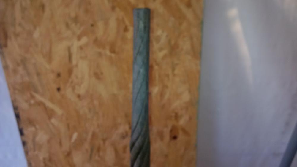

Nothing illustrates how out of shape you are from 17 years playing steering wheel monkey (17 years as a otr truck driver) than trying to forge weld a 1 inch piece of cable on your ONE day off this week >.<
got half of it forge welded, one inch at a time, three cycles each... before I ran out of steam and couldn't lift the 2.25lbs rounding hammer I only JUST got in the mail yesterday

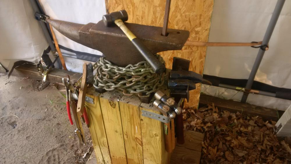

also, twisting wrench I "made" with a one foot bit of rebar (only my second time welding with a wire feed)
I haven't done a ton of welding cable, and hopefully someone with more experience than I have will chime in, but I've found that using a half round crossection bottom fuller or swageblock half round channel to forge into helps with welding cable quite a bit.  Also I would suggest using your twisting wrench to twist the cable tighter before welding the center section.  What has worked for me is forge welding the two ends, heating to red and wire brushing and fluxing liberally, then heating again and twisting tightly.  Reflux and only then I go for my forge weld of a couple of inches at a time.  Probably go faster with a  press, but all I have is a hand hammer and treadle hammer at this point.

A V block helps weld cable as does a round swage, a couple pieces of angle iron and a welder makes a V swage. Easy peasy. I've forged into the corner between the face and horn on my anvil with moderate success welding cable. I didn't really try very hard and my results reflected it. :huh:

straycat, your twisting wrench will work OK, but you should disassemble the jaws and grind the teeth to a smooth face.  As is, you are really gonna bugger up anything you try to twist...leaving scratches and gouges on your work.
Like Latticino said above, I have found that twisting the cable tighter before welding helps tremendously. I have over 300ft of cable to play with and I am still trying to figure it out. But i have found that twisting helps alot. Heat, flux, welding heat, wire brush, twist tighter, flux, welding heat again.... etc.... that is what has been working for me (most of the time).
