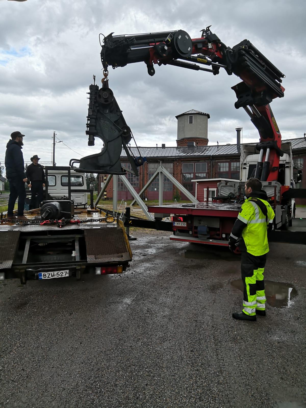

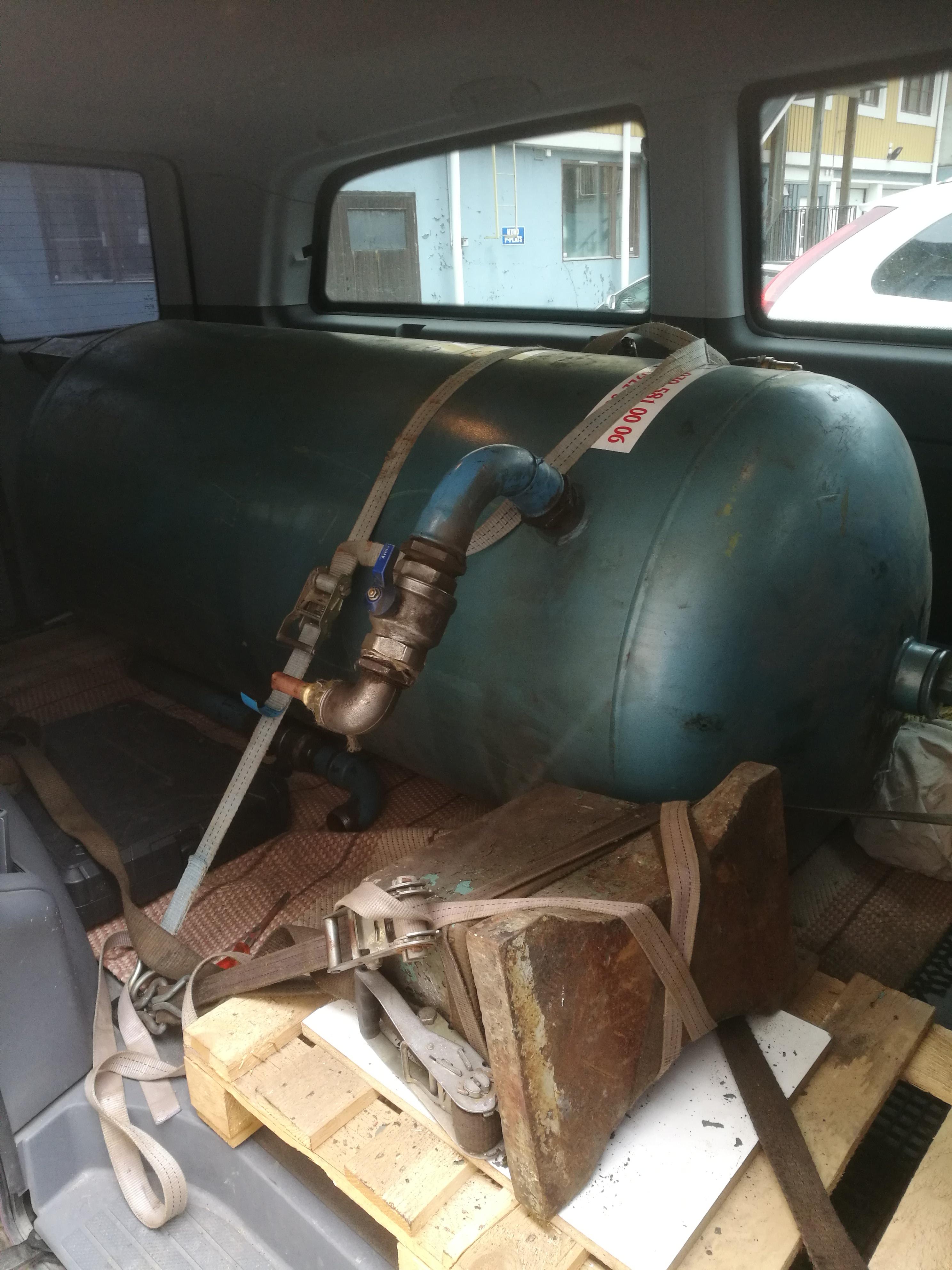

  1. The hammer is home! Thanks for the advice, friends! It was really useful to hear about putting wood boards underneath. I think it anchored the hammer well onto the truck bed - wood being a perfect mix of stoft and sticky and supportive. I couldn't notice any movement at any time. We really underdid ourselves on the fastening. A chain and a strap for the anvil. Two chains and one strap for the hammer (and one strap to hold the ram in the air). Yeah it was dangerous, but at least we drove carefully and had long safety distances between us and the car in front of us. Some cops in a car we passed on the roads really turned their heads to look at the load but they didn't stop us. That's my dad on the picture with all the trucks and our feisty steel horse. A thing the crane operator told us was that it was lucky that it was raining, as it cools the tires. The tires could overheat when driving long distances with heavy loads. The front tires got a little warm but not anything alarming. We stopped every 1,5 h on the way home. The way there took 7 hours and the way back took 8 hours. So sleepiness was also a danger. That's why we drove carefully and stopped often. The hammer felt small when I looked at it at home, and when I measured the footprint of it, I realized it was a size smaller. It's a 75 kg hammer, and the seller said 120! The closest model was a 100 kg one so I went by that. But I got it for less than scrap price so I'm happy anyway. With transport it cost me 900€. I'll have to fix it up, it's out of tune somehow and only has a 4.5 kW motor that they said is too small also. Best regards, Jakob Staffans @Jarntagforge
  2. Thanks for the tips. I'll bring some 2" boards and place them under the load. As for getting it off, our neighbours have a JCB tractor so I'll ask them first if it has the capacity to lift it, otherwise I'll widen my search. The hammer can wait ontop of the truck.

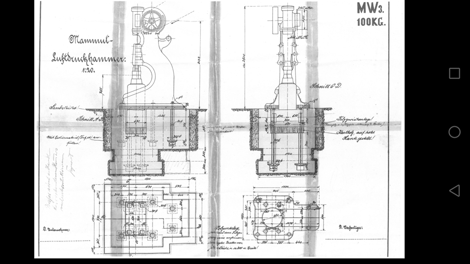

  3. Hey all, I've bought a 100-year-old two-piece self-contained airhammer. It's a Mammutwerke model MW3 from Nürnberg, Germany. It's in southern Finland though so it's not that far. The hammer body weighs 2200 kg/4890 lbs and the anvil 1300 kg/ 2890 lbs. The seller arranges extraction from the blacksmith shop and onto our Renault S150 midliner. I have a few questions I hope some wise man or woman could answer. Our midliner truck has a flat bed, made up of softer sheet steel on the frame, do I need to put wooden boards under the power hammer to distribute the load evenly on both the hammer and truck? Or is that even a stupid idea for some reason? I'm a little worried about the hammer possibly standing on a few bearing points and driving with it through bumps and uneven roads for 7 hours. What if the ring-like part of the hammer that holds the anvil cracks? Another thing I'm wondering about is what are the minimum requirements for fastening such a heavy load to the truck? We have 3 half-inch chains with tightheners and five 2-inch, 50 mm ratchet tie-down straps. That's 8 fasteners all in all. I assume 4 fasteners per piece is minimum. Are these enough for this load or do I need to buy more? Here's a truck with bed similar to my dad's Renault S150., minus the fold-down-ramp. I'm thinking I might put the hammer body close to the cab and the anvil behind the body. My dad and brother-in-law will becoming along. What do you guys and gals think, is there any other advice that's good to know? Best regards, Hobby blacksmith, Jakob Staffans Kimo, Finland Here's a link to a german forum with some pictures of a hammer of this make, but the hammer in that forum is smaller, a 50 kg model. and here's a video of that 50 kg MW1 running. Watch out, the audio is broken and gives "BEEP" "BLIP" sometimes so keep the volume down.

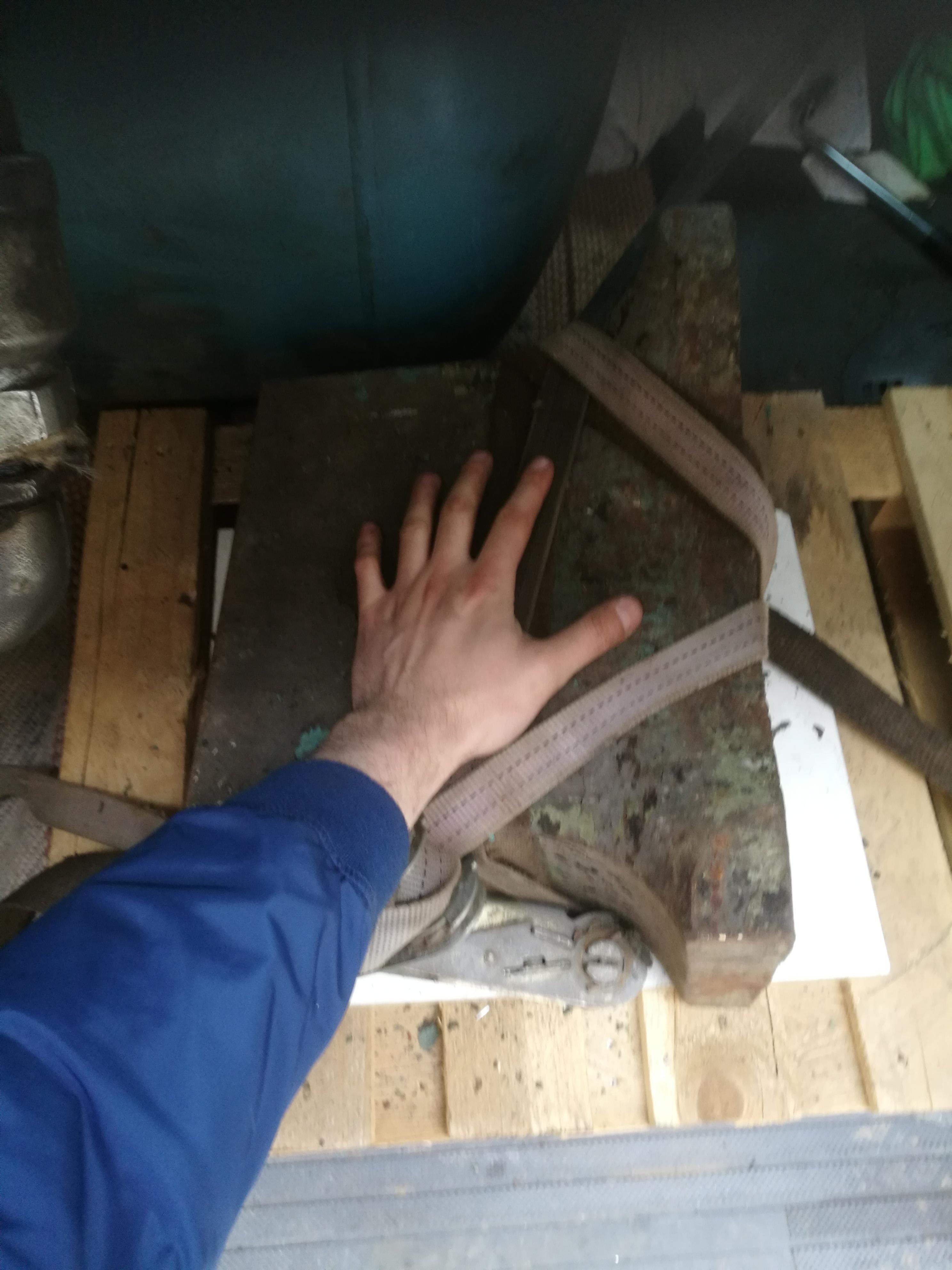

  4. Thanks! Last weekend I and my girlfriend went on another trip. We drove up from Vaasa to Tornio on a friday where I bought this 250 gallon/1000 liter air tank. It's from 1988 but it had been inspected at least 4 times. Which is all really re-assuring! Last time was in 2017. I'm gonna use it mainly for my home-made airhammer. After that we drove over to Sweden to buy a 150 kg/330 lb sawyer's anvil. No dents or anything. I heard it's good for forging on as it rebounds really well all-over, as opposed to heeled anvils. Will be fun to try it. Then we stayed the night in Luleå, ate at a fancy restaurant, and drove down to Umeå the next day. We walked around town, ate at a fancy restaurant, had some drinks and stayed in a hotel which served a great breakfast the next day. Then we took the boat back to Vaasa on sunday. best regards, Jakob Staffans Vaasa, Finland

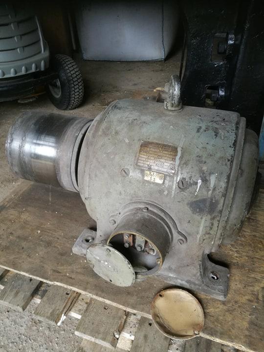

  10. I don't know, I didn't ask anyone for permission I just did it First we picked up the spring hammer from the retiring blacksmith on the first photo, and then we went to IKEA So the girlfriend was happy. I borrowed her dad's big Ford Transit van and I pushed it near its payload weight limit with this... The van should be able to hold 1500 kg and this hammer was anything between 1000 and 1400 kg, maybe 1100? On top of that was the large old-style electrical motor whose weight we just ignored but probably weighed at least 200 kg... we loaded the hammer from the back of the van and you could hear all kinds of creaking sounds. The suspension sunk down... to still an acceptable height. *phew* Then we drove to Ikea, loaded up some furniture and drove home. Thinking back on the loading I get anxious. Would have sucked so hard if anything on the car had broken down, 5 hours ride away from home.

  14. What a great thread. Thanks for all the information and sharing from everyone, especially you, BeaverNZ. I have a question, I read it all and I don't think I saw this anywhere. Shouldn't the anvil have wood directly under it? Maybe it does? I tried to see if you wrote you put wood under it but I couldn't find anything. I ask because when reading this book on page 543 and 544, https://ia600205.us.archive.org/24/items/machineryfoundat00crof/machineryfoundat00crof.pdf it seems to me they put wood under the anvils. To my understanding to absorb the impact so the slides don't have to, and that the frame would break otherwise. But then again of course I don't know the answers either way, I'm just asking. I dig you hammer!

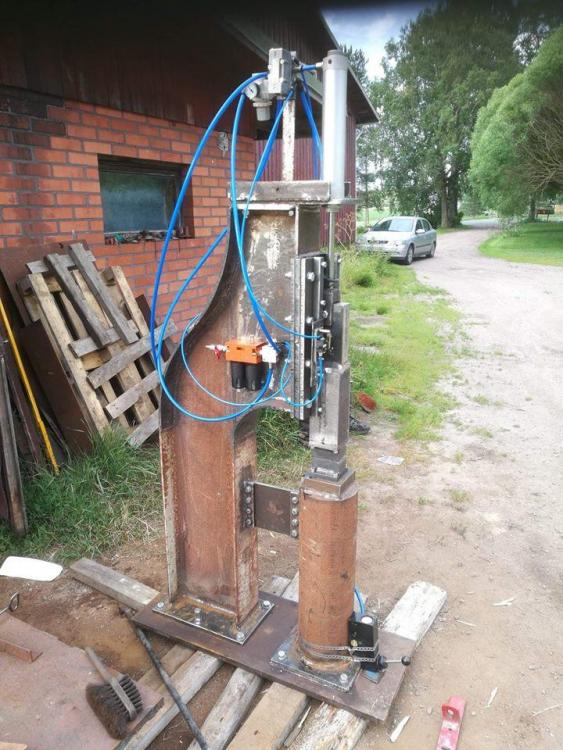

  16. Regarding motor and power transferral, Little Giant 250 and 500 lb hammers may not be eactly the same but they're very similar. It's easy to imagine - is your hammer sluggish? Add power! But other than that I agree with the previous posters - if Clay's design says 65 lb then that's what the frame is designed for. You need to reinforce the frame in that case (all of the hammer) if you want a heavier ram.

  19. I haven't built one using the kit, but I have built a kinyon styled hammer using the local hardware store's air components. My hammer uses a 5/2 valve and two roller valves. 400 lb anvil and 88 pound ram. What does tup mean? I guess it's ram but why is it called tup? Yeah, this hammer wasn't that hard to build. Only thing is you need a plasma cutter and a good welding machine. I'll have to make a good base for the hammer because otherwise I'm sure the welds will break. I'll either place it standing on concrete, or on I-beams sandwiched between a second base plate and bolted through. My air components cost about 700€ and then I got the cylinder for real cheap. The whole machine was about 1700€. Partly reclaimed steel, cylinder, and dad's welding rods. Oh, and I haven't gotten arond to making a proper foot treadle yet, I just put the valve in front to test out the hammer.

  21. Seems like the anvil is its own piece free from the hammer. Was it free standing in a hole or was it covered in concrete? Don't people sometimes cover the anvil in concrete, maybe more on Massey self-contained ones?

  24. I'm thinking this could be a German UAT anvil. Could it be so?
