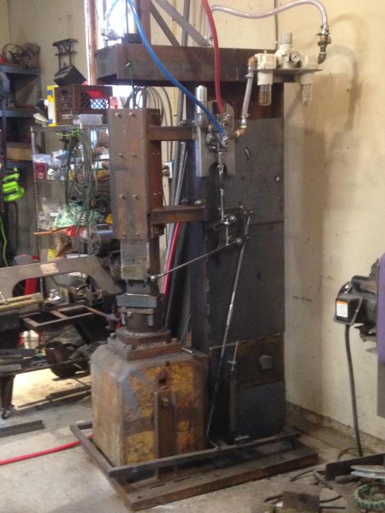

Judson Yaggy Posted January 5, 2019 Share Posted January 5, 2019 10 hours ago, setlab said: Has anyone ever build there own off that $1400 kit Ken sells? I have. Similar situation, I found a 1900# block at the scrap yard and built the hammer around that. 135# tup, 11 inch stroke. AMAZING control, one hit wonder! Be aware that the dump valves on the piston don't slow down the tup on the up stroke, it stops when the ram hits a rubber bumper atatched to the hammer frame, design your frame accordingly! I have more pics and some action vids on my Insta account, same name. Link to comment Share on other sites More sharing options...
setlab Posted January 5, 2019 Author Share Posted January 5, 2019 Nice hammer, that anvil looks like is was made exactly for it. I'll have to check your Instagram out. Definitely have enough air supply so that never going to be an issue. I suppose I'll cross that bridge when I come to it when deciding to build a larger tup weight or not. Link to comment Share on other sites More sharing options...

don schad Posted February 6, 2019 Share Posted February 6, 2019 On 1/5/2019 at 9:07 AM, Judson Yaggy said: I have. Similar situation, I found a 1900# block at the scrap yard and built the hammer around that. 135# tup, 11 inch stroke. AMAZING control, one hit wonder! Be aware that the dump valves on the piston don't slow down the tup on the up stroke, it stops when the ram hits a rubber bumper atatched to the hammer frame, design your frame accordingly! Hi Judson - do you know how many BPM you are getting when your machine is running flat out? I've seen the videos and they typically focus on slow control (which looks super), but not the more rapid blows. Do you think that your tup weight is appropriate for the valving (i.e. not too big)? Also, regarding your comment on the up stroke - is it always banging at the top of the up stroke or is it hitting the top when parking after you let off the treadle? I am considering converting my Iron Kiss to use this system. Thanks, Don Link to comment Share on other sites More sharing options...

Judson Yaggy Posted February 7, 2019 Share Posted February 7, 2019 On 2/5/2019 at 10:32 PM, don schad said: do you know how many BPM you are getting when your machine is running flat out? I havn't actually counted, but it's slightly slower than my 95# mechanical, as one would expect. I learned on mechanicals, and prefer a speedy hammer, and the Ken's kit is faster than some of the other utility hammers I've seen. Ken told me that they have the kit on many 150# hammers, so I felt comfortable putting it on a 135# system. The hitting the top stops happens most when parking, but it will also hit when running flat out. Depends on the air pressure setting and linkage setting. If it were my hammer, not sure I'd bother altering an IronKiss. The one I've run had a differnt feel than Ken's, but still had great control. I would say they are on par. If it was a Blu, especially an older one, that would be a different situation. Link to comment Share on other sites More sharing options...
don schad Posted February 8, 2019 Share Posted February 8, 2019 On 2/7/2019 at 7:31 AM, Judson Yaggy said: I havn't actually counted, but it's slightly slower than my 95# mechanical, as one would expect. I learned on mechanicals, and prefer a speedy hammer, and the Ken's kit is faster than some of the other utility hammers I've seen. Ken told me that they have the kit on many 150# hammers, so I felt comfortable putting it on a 135# system. The hitting the top stops happens most when parking, but it will also hit when running flat out. Depends on the air pressure setting and linkage setting. If it were my hammer, not sure I'd bother altering an IronKiss. The one I've run had a differnt feel than Ken's, but still had great control. I would say they are on par. If it was a Blu, especially an older one, that would be a different situation. My IK does have good control when approaching the dies, but I am frustrated with an overall short stroke due to banging into the cylinder on return. With the adjustable stroke the upper 3rd or so is off limits. I don't think that Ken's kit would help with this (too much stroke for too little cylinder), but if/when I get into reworking everything that was something I was wondering about. The motion/control looks very interesting. Thanks for your comments. Link to comment Share on other sites More sharing options...
