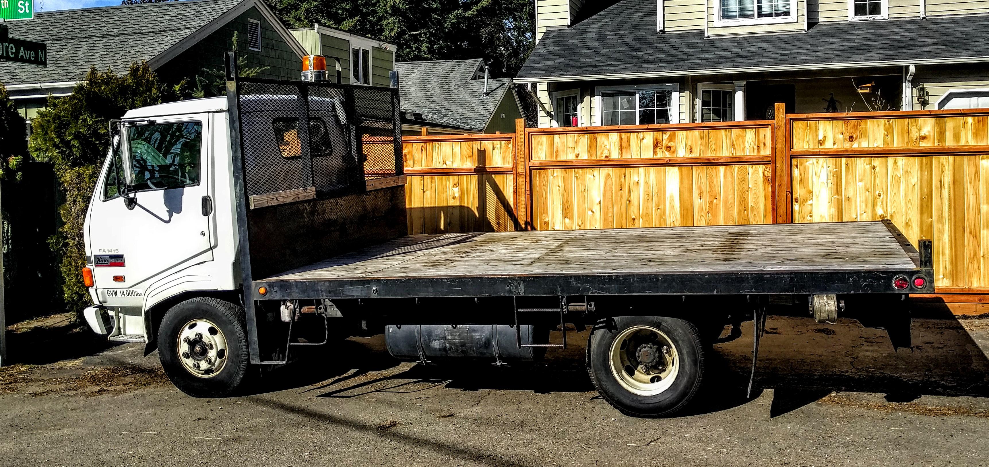

I got tired of pretending a minivan was a truck. So this followed me home. I fear it will lead to bigger things following me around from now on.
