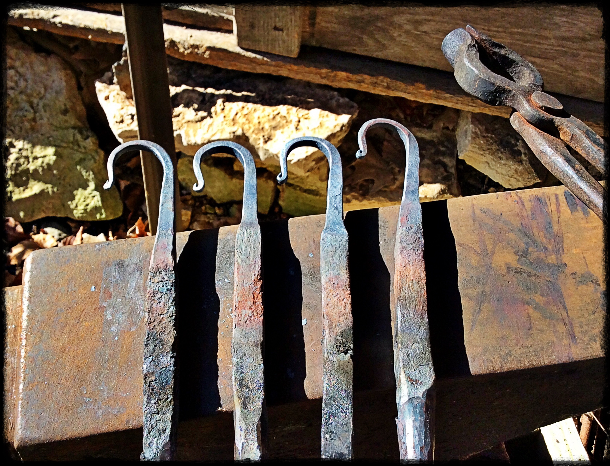

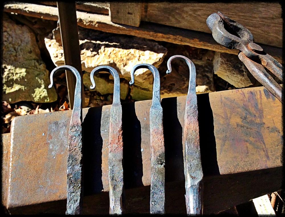

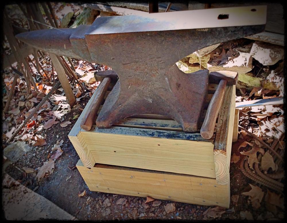

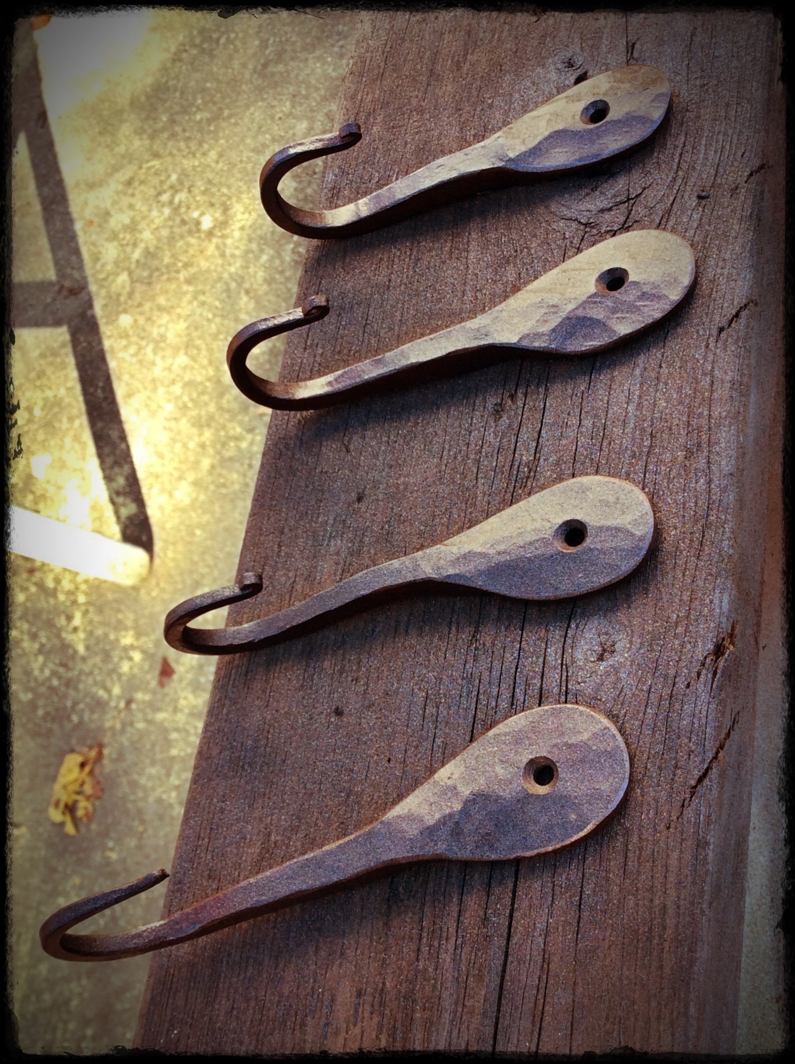

Here's a picture of the anvil on its stand and a shot of the hooks finished and painted! There may be some flex in my stand... but not enough for me to detect... certainly not a bothersome amount. It gives more stable support than the old stump ever did! This is a VERY economical stand! Yet it works quite well! I am quite happy with it! -

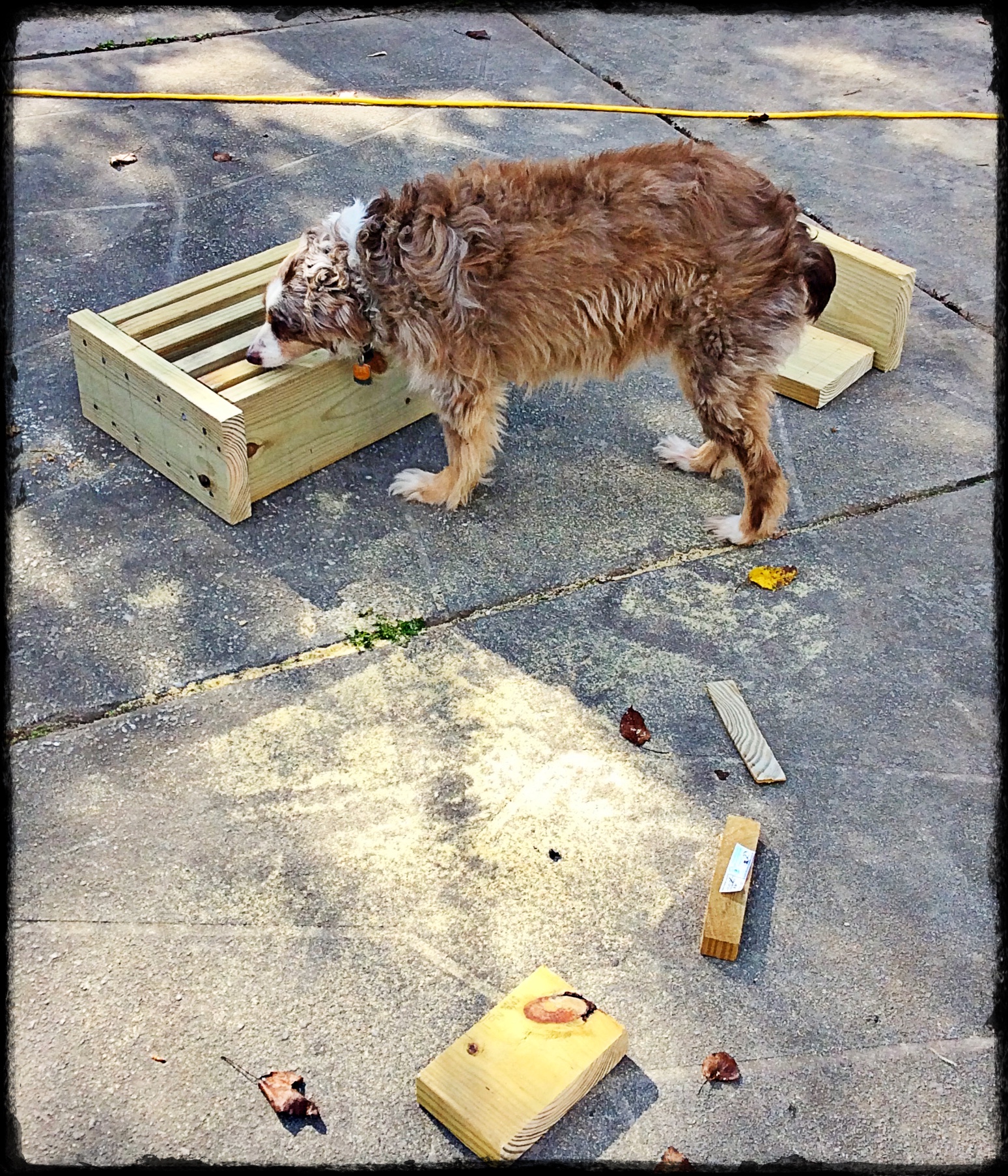

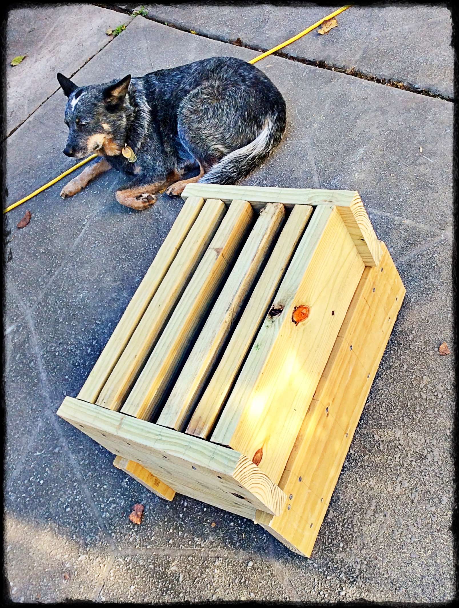

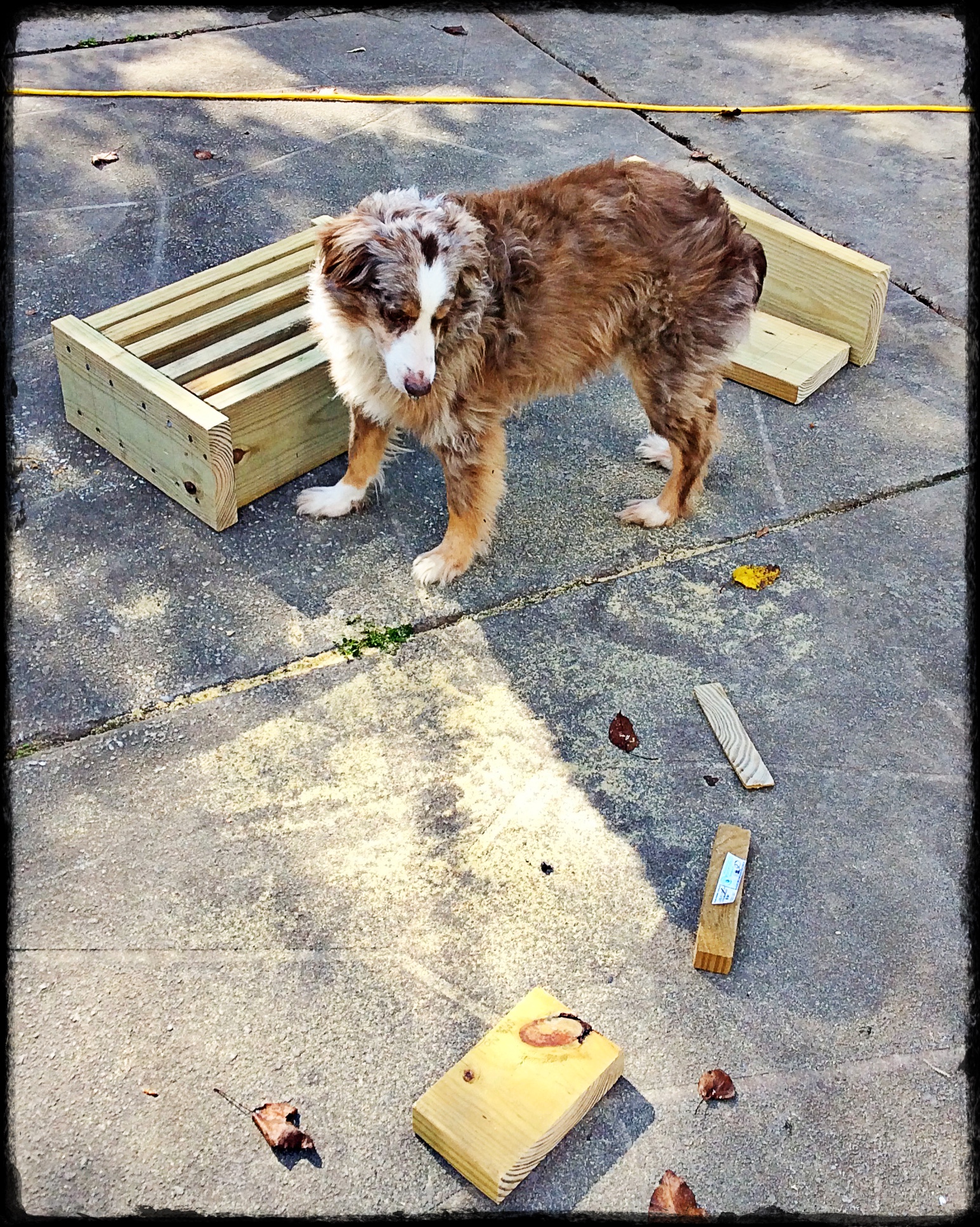

Okay. Here's my cut list; (all 2" X 8" stock) 2@16" 2@24" 6@12" 6@19" Obviously, this should be adjusted to the size of stand that you require. I'll get a picture later today. For now my anvil just sits there unfastened... Doesn't seem to move much. I'll likely staple it down when I get a round tuit! BTW, I let the end plates overhang the joists by 1" on each end... not necessary but it minimizes chances of splitting the ends! I rounded the ends a bit with my flap wheel so that I won't catch my pants leg on them. -
My old anvil stump rotted away! I decided to replace it with one made of treated yellow pine. I hope that this one may last as long as I'll need one! I built it in two stacked tiers of closely spaced stringers. The bottom tier has stringers running perpendicular to the long axis of my anvil. The next tier is built with the stringers running parallel to the long axis of my anvil. I used treated two X eights for the stand and pre drilled for nails. I used 5" galvanized ring shank spikes to join with. The finished stand is 14 3/4" tall and 22" X 16" overall. I bought two 16' lengths but had 11 feet leftover. The stand is now in use and is much better than the old stump,ever was. My safety inspector takes a close look! He notices that I haven't cleaned up my scraps and sawdust! Transformed a few railroad spikes into hooks as a test project! The stand is great!
