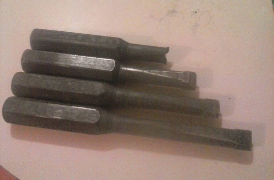

  1. Ok on my next one I try getting the struck end to purple as you described before and test it out. thanks.
  2. Yeah I am new to this so simpler is better for now.
  3. Thanks. I am going try and get some o-1 . I reheated the steels to cherry red, quenched in water one of them got a hair line crack? Then I put them in the oven for 400 for a hr and re-quenched. Tried them out they work great. I didn't try the one with the crack. I am going to try a oil quench next.

  5. I need them as hard as i can get them but not shatter with repeated blows from a 4 pound sledge . Here is a pic of the ones i have made so far the smallest one is the one that broke. the other three I heated to cherry red then quenched in oil for about five seconds. They seem too soft.
  6. No i guess not? I thought I was tempering it but i guess i just hardened it. How do you temper it after hardening?
  7. I am making some drill steels for single jack rock drilling competitions that I compete in. I am making them out of 1'' hex digging bars that are high carbon steel supposedly? I have made a few on a little lathe that I have but I am having trouble tempering them. I need the chisel end as hard as i can get it with out breaking and the end that i hit with the hammer to be hard enough not to mushroom. I tried one in a coal forge my buddy has. Heated the whole thing to cherry red then quenched the tip in water for about five seconds then pulled it out for about a minute then quenched the whole thing for about five to ten seconds then let air cool. When I struck it a few times with a hammer the chisel end shattered so its too hard I am thinking. This is all new to me so if anyone could give me some advice on how to temper these things i would be grateful.
