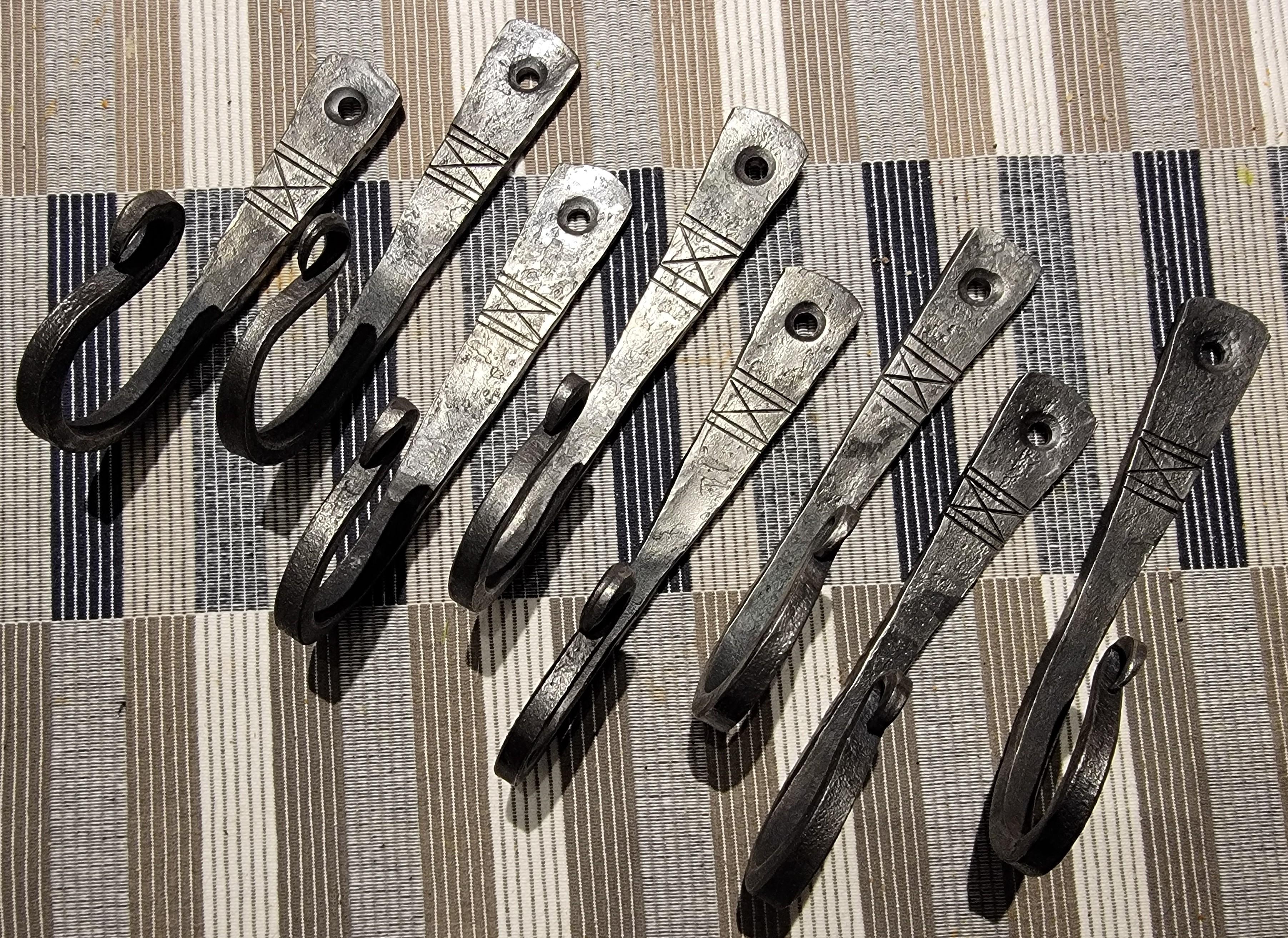

  12. Just a quick run of hooks to give to my team as end of year holiday gifts. Simple and effective. Forged from 4" of 1/2" square stock (because that was what I had). Tried to keep it down to (4) heats, but at times had to add an extra one to true things up and set the divot for the drilled hanging hole.

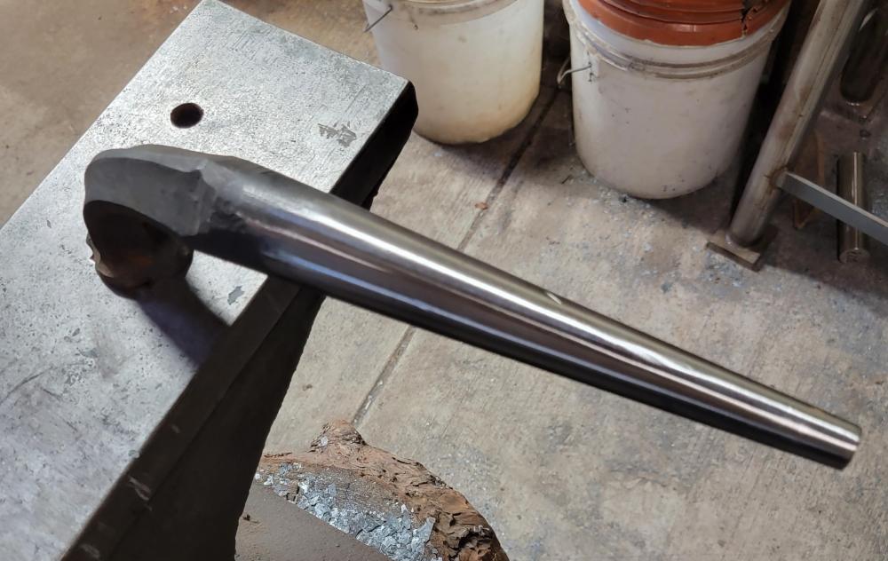

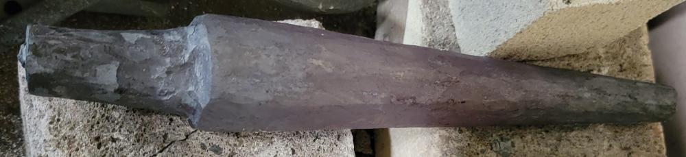

  22. Thanks Jen. Very helpful as usual. Here is the bick I forged up to help with final shaping (and possibly the forge weld, depending) as well as the rough forging on the mild steel mandrel I forged out. The latter is now ground clean and polished up to match the bick. Both made from 1 1/2" stock. Bick was 4140 and has been heat treated.
