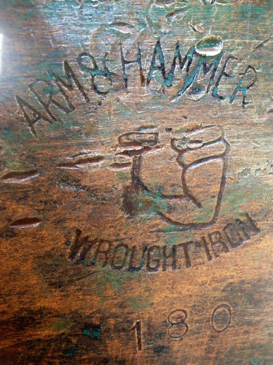

  1. The weight is stamped under the Arm&Hammer The serial # will be on the front ledge of the feet. Use as is unless you have time to read up on the Gunter repair as was said. You only really need a flat spot the size of a hammer face. You could use a piece of forklift tine or similar if you need really flat.

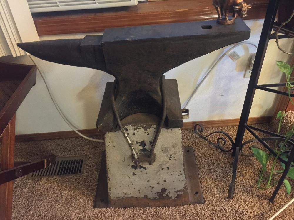

  3. It's a 180# Arm & Hammer, 220# cast iron stand. Bought for $250 from the widow of the man shown. Originally I was just helping her sell it. Suggested $1000 for the pair and she sold it to me for $250 because she said she wanted it to go to someone who would love it like her husband did.

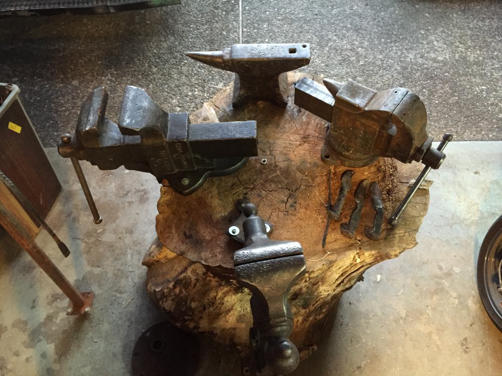

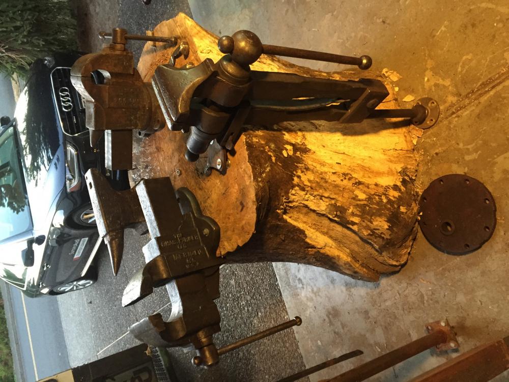

    They are great vises. The 6" I bought for holding stakes while raising copper dishes. The 4" will go on my lower bench in the shop to hold a knife vise so that I can swivel the knife vise around to do file work and hand sanding.

    Charles Parker / Parker / Chas. Parker: They are famous for the shape of the jaws on their machinist vises. The jaw shape allows for more complete access to the workpiece being clamped. Some history on the company and Charles Parker himself: "The Meriden Enterprise Center is a large manufacturing plant that is home to over 60 businesses, located in the center of Connecticut.The plant was the former home of companies such as the Charles Parker company, known for the manufacture of the Springfield rifle and the development of one of the early repeating rifles in the mid- nineteenth century. Charles Parker was born in 1809 and rose from poverty to become oneof Connecticut’s leading industrialists. He also became the city of Meriden's first mayor. He started his manufacturing career inventing and producing coffee mills in a small shop in 1832.By 1860, he owned several large factories and employed hundreds of people, in and around Meriden. Parker products included hardware and house wares, flatware, clocks, lamps, piano stools and benches, vises, coffee mills, industrial machinery, and, after 1862, guns. Guns, however, neveramounted to more than 10 percent of Parker’s business. Charles Parker died in 1901 and his descendants carried on his businesses until 1957. The Great Depression of the 1930s took its toll on the Parker enterprise and it never fully recovered. Parker products have now become “collector’s items,” especially the Parker shotguns. The Charles Parker Company sold its gun facility and the rights to the Parker gunto Remington Arms Company in 1934, and Remington continued the Parker shotgun line until World War II.The attraction by collectors to the Parker shotgun comes because of the gun’s inherent quality and beauty.The Parker gun is an American classic". Copied from the Garagejournal.com
  14. fluidsteel replied to matto's topic in Vises
    Looks pretty good. I have two Chas Parkers, a 956 that is 120# and an 80# 994 swivel. It took me about 4 years to find them for a reasonable price. Found both of mine in the last month.

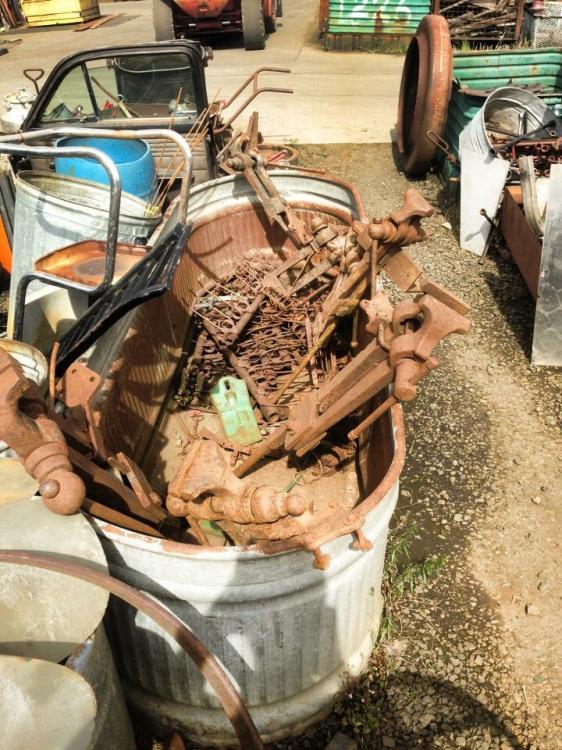

  17. This was from here in the Portland Oregon area. I bought my 6" vise from this bin. Almost mint condition for $160. Not a steal but a good price.

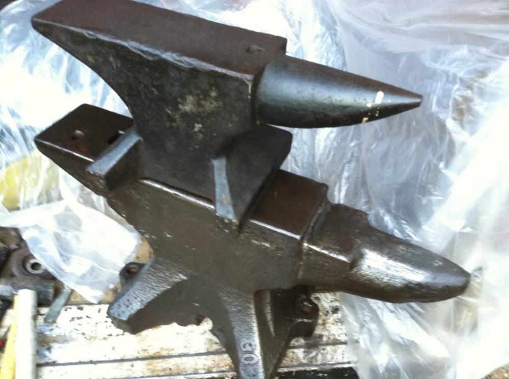

  18. That is a cool anvil. Looks like it probably had a couple top plate pieces fail to weld in the original forging and after they popped off it was used a lot. It would be both sad and cool to see it become what it should have been.

  22. Picked this anvil up for $250 including the stand, 6 nice pairs of tongs, a cross pien hammer and 4 steak turners. A former co-worker saw it and asked the customer if she would sell it and he gave me her number after she said yes. I told her $1 a pound would be a "family" price, and that most anvils like this go from $2-4 a pound. She talked it over with her sons and decided $250 was my price. I'm looking forward to forging on it this weekend. I believe it has slightly better rebound than my 150# Fisher and equal to my 300# Fisher. Hopefully bedding it in some caulk helps the ring. I'm spoiled with my Fishers quiet thwack. Here is her husband some years back. She said he was a smith on a historical farm in New York in the sixties. She forgot the details.
