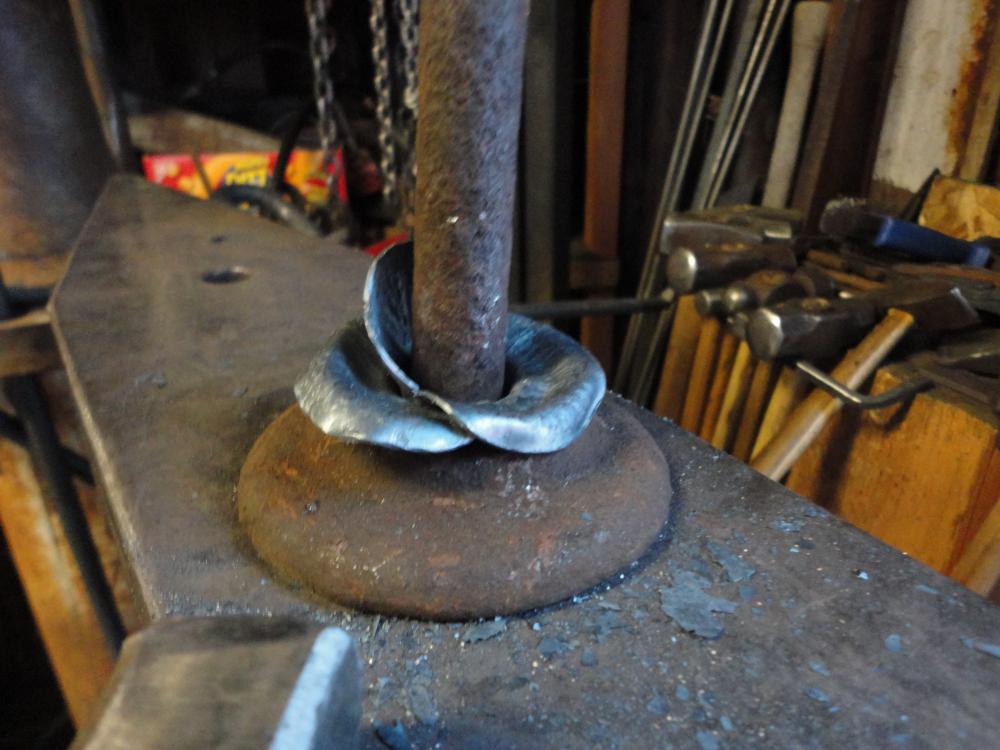

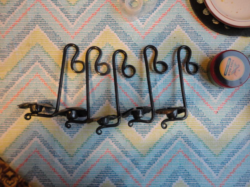

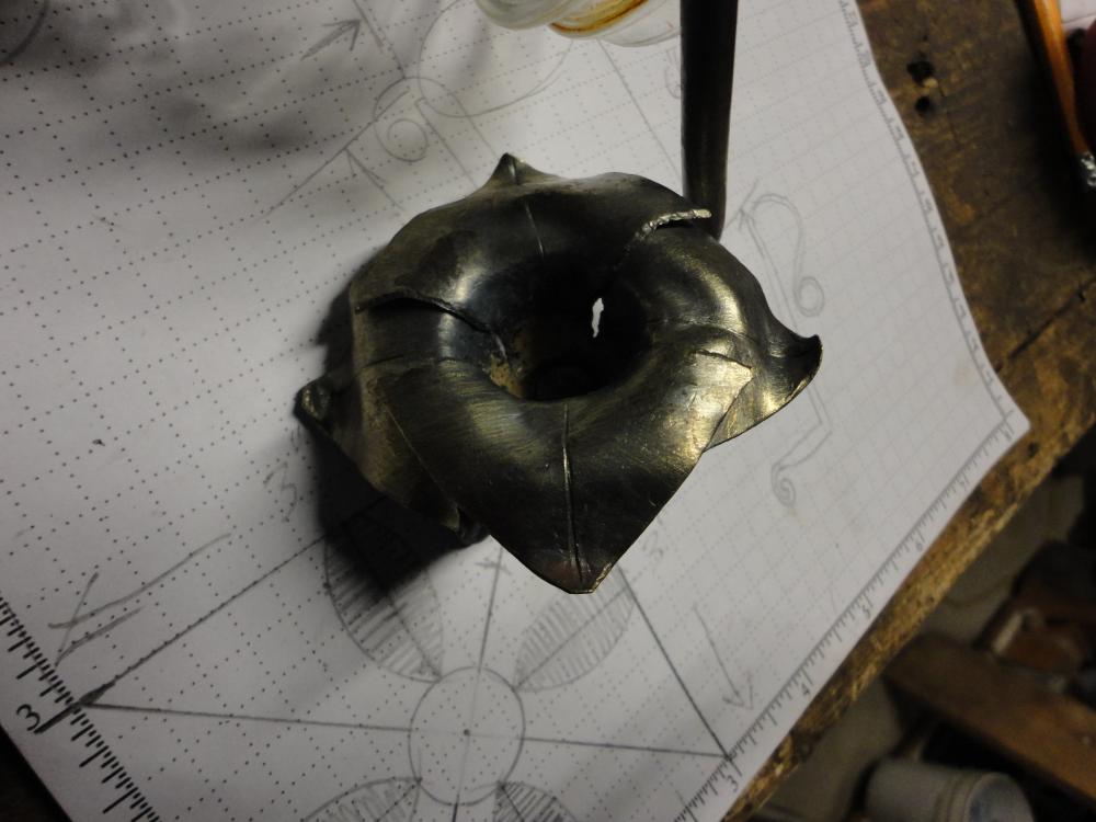

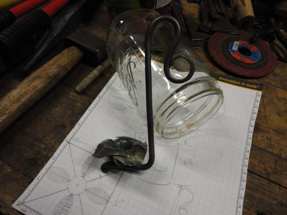

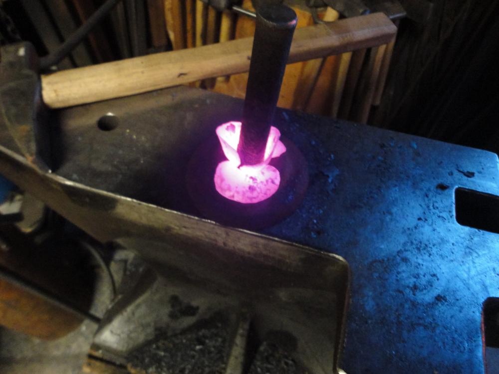

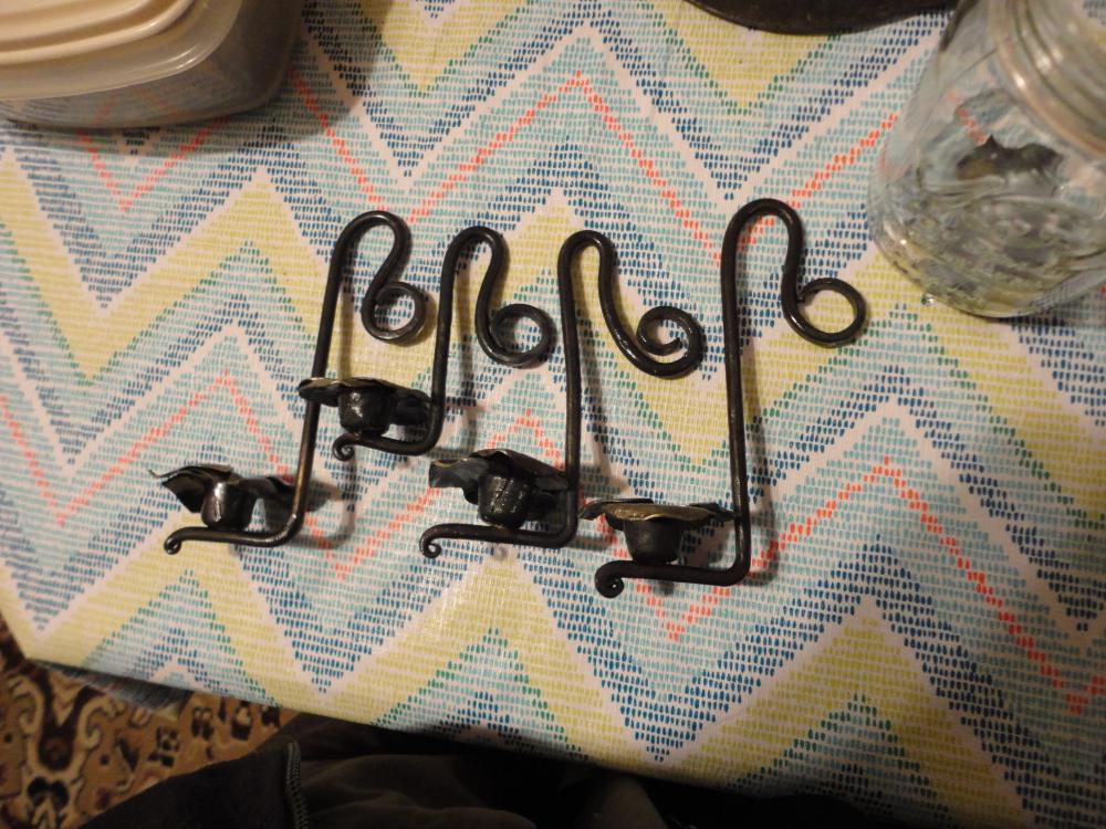

  11. These are what I've been making lately. A 3" square of sheet metal with a 4 petal flower on it, layed out much the same as the Aspery rose petals. 13" of 1/4" round for the handle wrapped around a quick jig for consistency. An old washer off a bridge or something with a punch made from the 3/4" bolt that went through the washer. Work hot, punch the candle cup in and roll the petals out.

  14. Made a little jig today for bending the handles around. Once that part was consistent it was easy to find a spot on the anvil to make the 90deg bend for the flowers match. Much nicer repeatable results

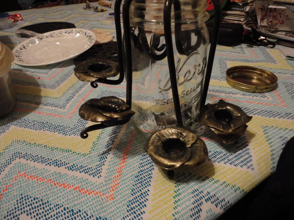

  23. Pull them out of the forge at a nice red heat wire brush the scale off and when it is dropping into a black heat take a brass brush to it John. A good coat of clear coat gives it a nice lusterous shine. She's really pleased with the pics I sent her. So I'm pretty sure there will be more to make in the future.
