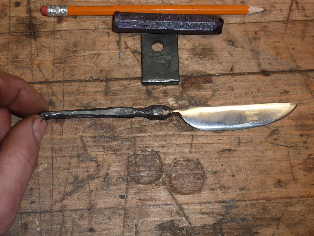

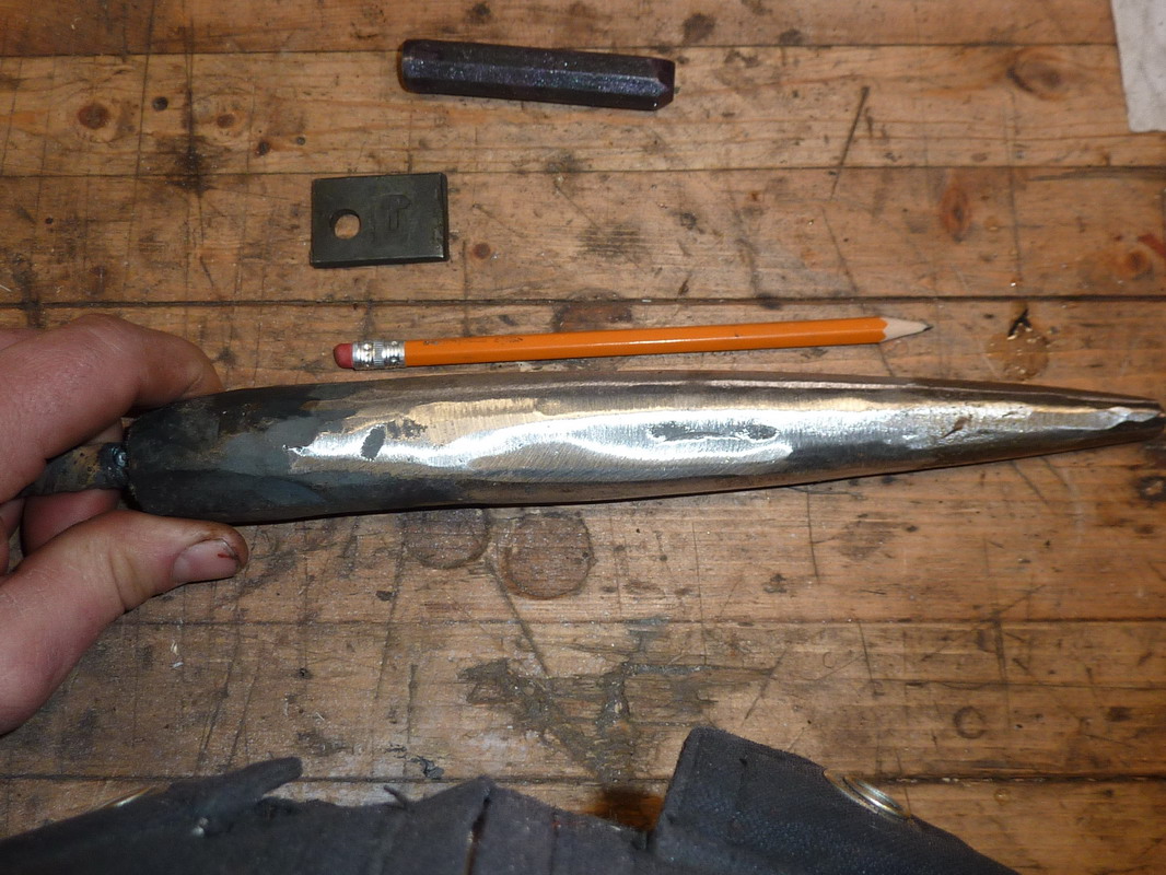

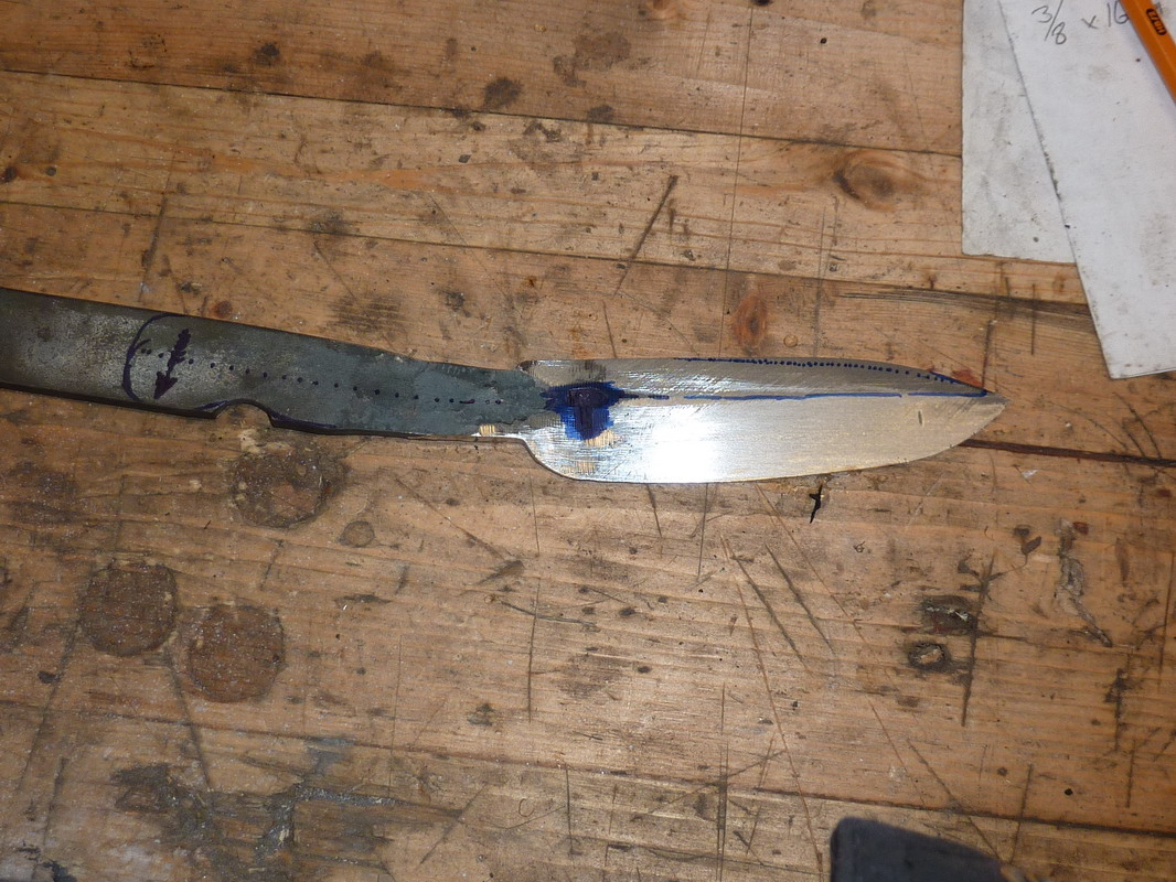

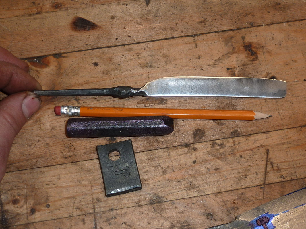

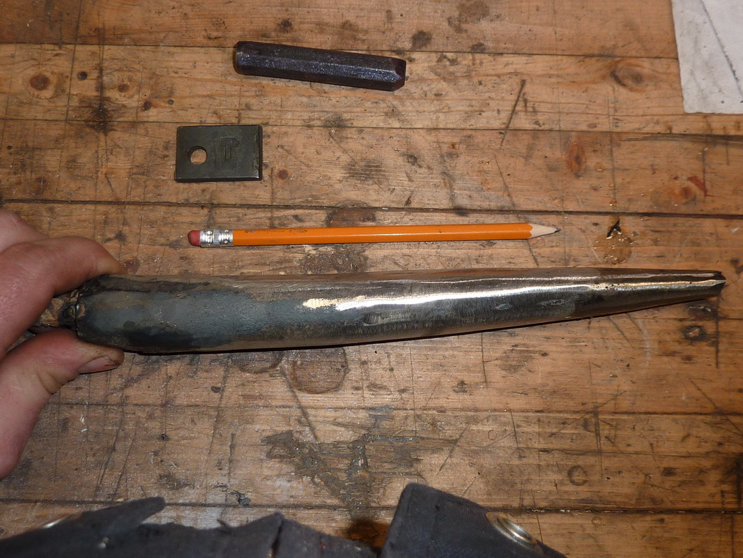

  4. Well, the new forge works great. Tried making a carving knife for the neighbours failed in heat treat. A few big cracks across the blade. Ah well, try that one again. made a few more arrow heads, they are getting faster. and the socket is getting more consistent big plus... Then I took the a piece of 3/8x1 1/2" mild. Ground off scale and folded and fluxed. Darned if I didn't get a decent weld. I then took the mudlflap hanger spring stock that I had straightened out and heated and beated that together. took it up to 20 layers or so. Didn't get a picture of the billet, but twisted and welded it back on itself. hammered out a small knife. It's now soaking in vinegar, just on the off chance that the pattern may show up. Not expecting much as its all the same material welded together. Assuming that the mud flap spring is 5160 any hints or tricks to maybe get the pattern to show? Muriatic acid or ferric chloride would no doubt be the best bet. Will have to look into getting some. I have a 2 large seals from a buncher final drive, (double taper seal) looks to be the same material as a bearing race. Thoughts on contrast with the mudflap spring if I weld it all together. start of a straightened out spring new airtank forge faggot weld in 3/8 mild small blade out of mudflap spring Just stoked thatI have finally got a setup where I can forge weld!

  7. Think Dad wanted it for post and beam type stuff. Was thinking the the larger piece of the stub shaft could sit on a block with a few spikes throught the bolt holes to hold it down. then its portable. The shorter piece if used just take the chainsaw and plunge cut a square hole into the end of a block, of sized right should fit plenty snug, and if not a few wedges might just work to lock it in place. Though it could be welded to the crank pulley I haven't pulled out of the scrap bin yet. It's off a Cat engine from a logging truck that burnt up (lot's of excitement that day!)
  8. Beat out a Slick for Dad today. makes a pretty good trade for a conveyor for moving dirt out of the basement to be. ***** of a lot of beating to get the socket spread enough to roll it up. Can't wait til the ceramic blanket comes in and I can get another forge set up and the old one relined. One for small stuff and another for larger bits. And an interesting piece of scrap from the casualty at work. Stub shaft that holds the the track frame on the 527 Skid Cat broke. Was thinking maybe a base for my post vise, but not quite heavy enough. Might make a nice blade anvil if the face has two parrallel sides. Weighs 108lb when complete by the shipping slip for the new one. Maybe back to arrow heads on sunday. all depends...

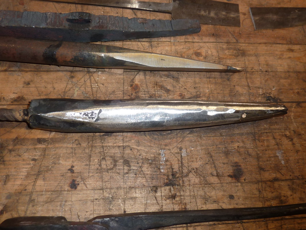

  10. Big ugly chisel for dad, promised to fix one of his long ago. A bic, socket tongs, first attemp at rolling sockets for arrowheads. and a reshaped knife from a broken blade, just needs finishing. and what you don't see is the two failed attempts at sockets on the shop floor. Going to take a whole lot of practice to get nice neat uniform arrow heads made up. At least the material is cheap, mudflap and bunk springs from our logging trucks. Hardest part is getting the socket wall thin and uniform enough.

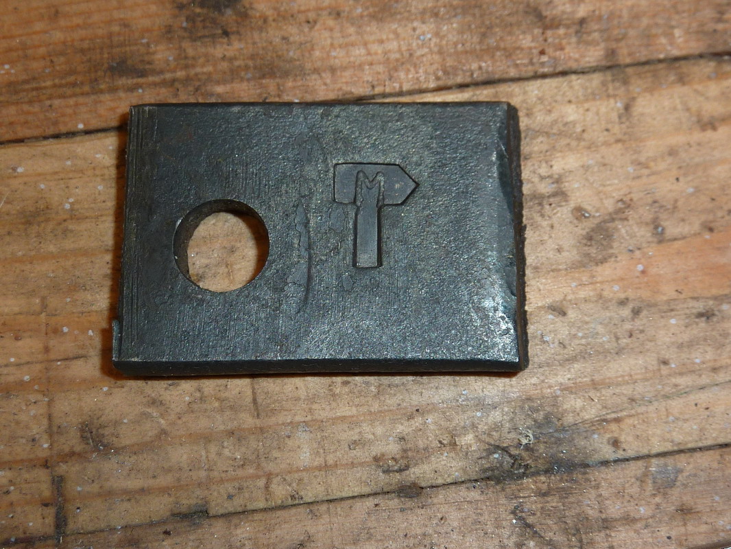

  19. Old alphabets, symbols, etc from nearly every ancient language out there. Bound to be something for somebody. http://www.ancientscripts.com/ws_types.html Thread got me thinking about touchmarks...next project on the list....
