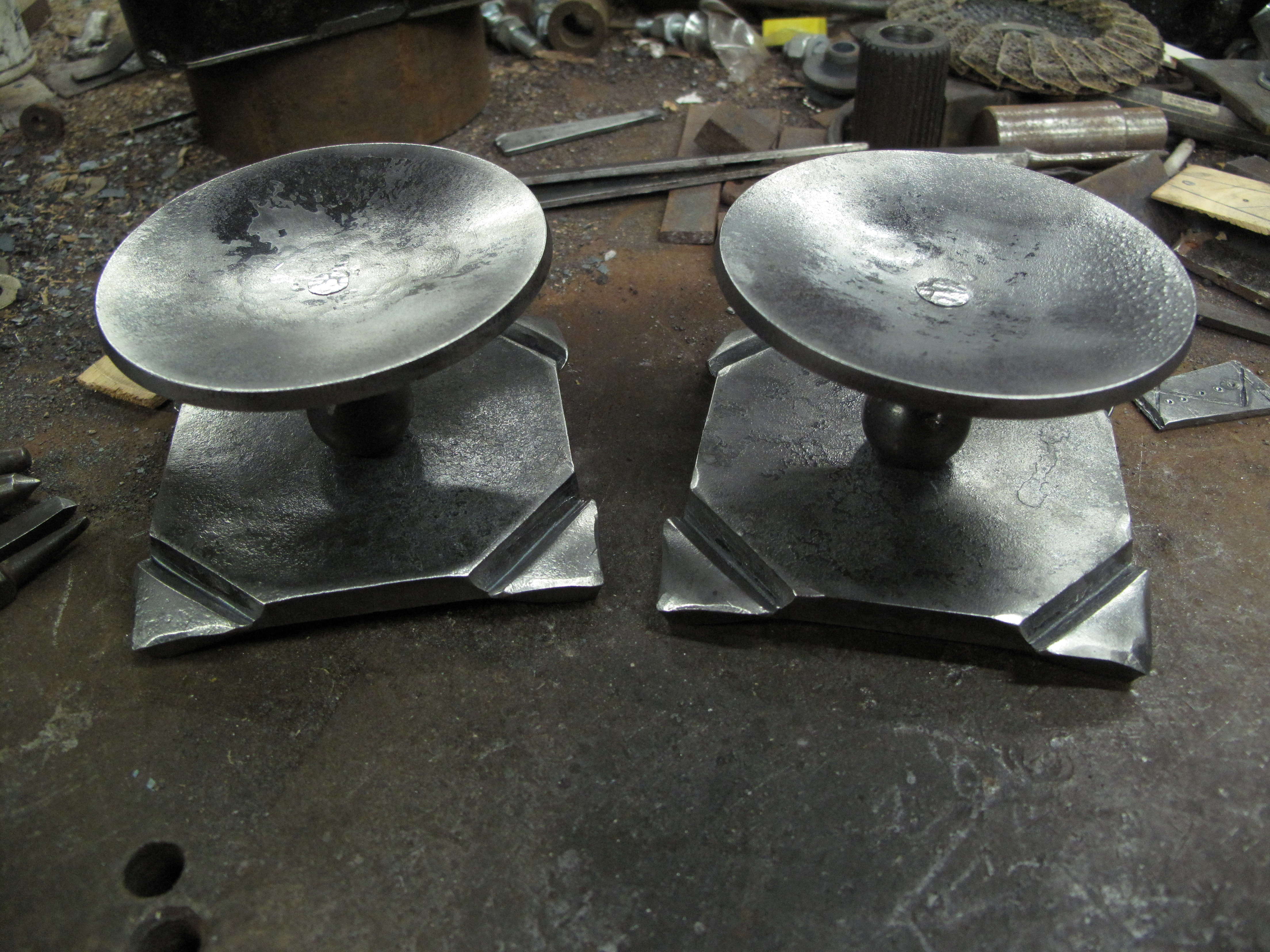

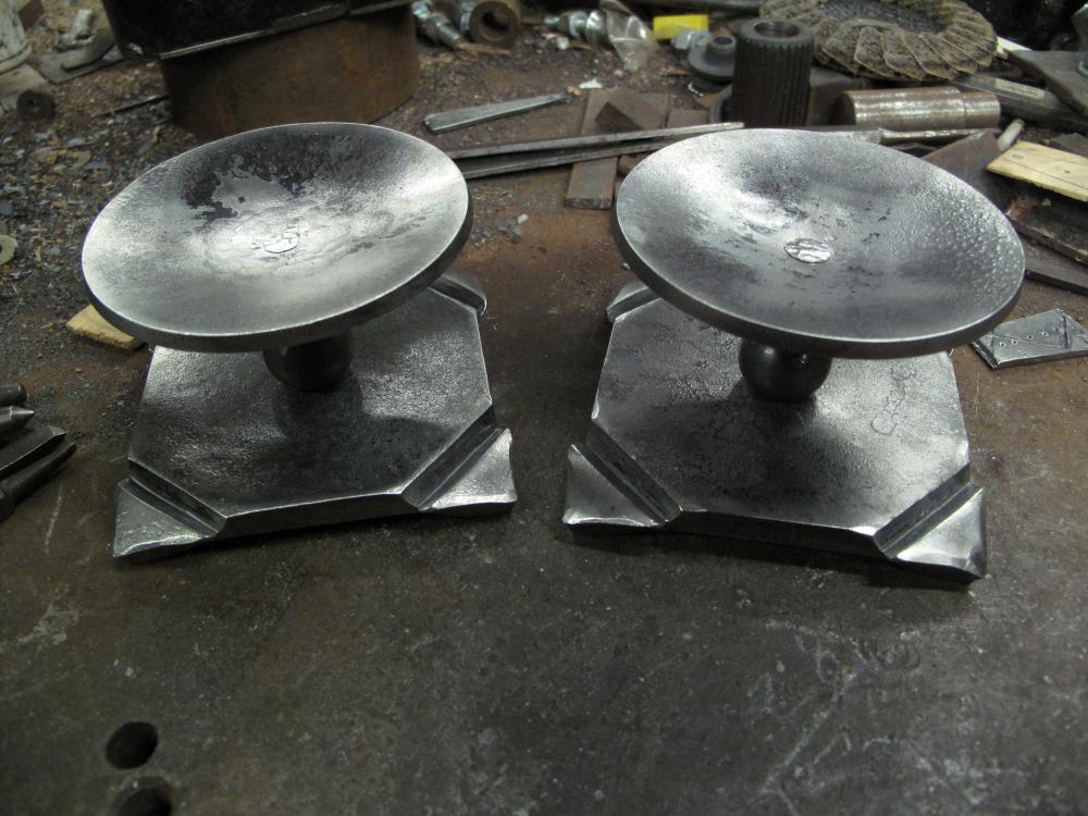

That's correct. If you hammer on top of even mild steel, the ridges will collapse. This doesn't look bad necessarily as it adds to the rustic hand-hewn look, but it does tend to conflict with the sharp image on the second side. All depends on what kind of look you're going for. The pitch might work for this application, but I really don't have any experience with it and wonder if it might be too soft and make carving the second image a bit more difficult. Copper gives a good bit of resistance while being soft enough for the ridges to sink into without deformation.
I had a customer request a double-sided pendant. I've done quite a few of them in the past, but always disapproved of how the ridges in the design would collapse when you carved the second face. A lot of people use pitch bowls, but I haven't invested in one yet. I keep saying I will, but never seen to have the funds available. So, I decided to make my own soft face using some old copper bus bars. It's a simple construction not meant to last long at all. I cleaned the surfaces with lacquer thinner and a wire brush to get a reasonable bond. Then a squirt of spray-on adhesive. Worked like a charm and the first design looks as fresh and crisp as it did when first carved. Proof, again, that being a pack rat can be advantageous!

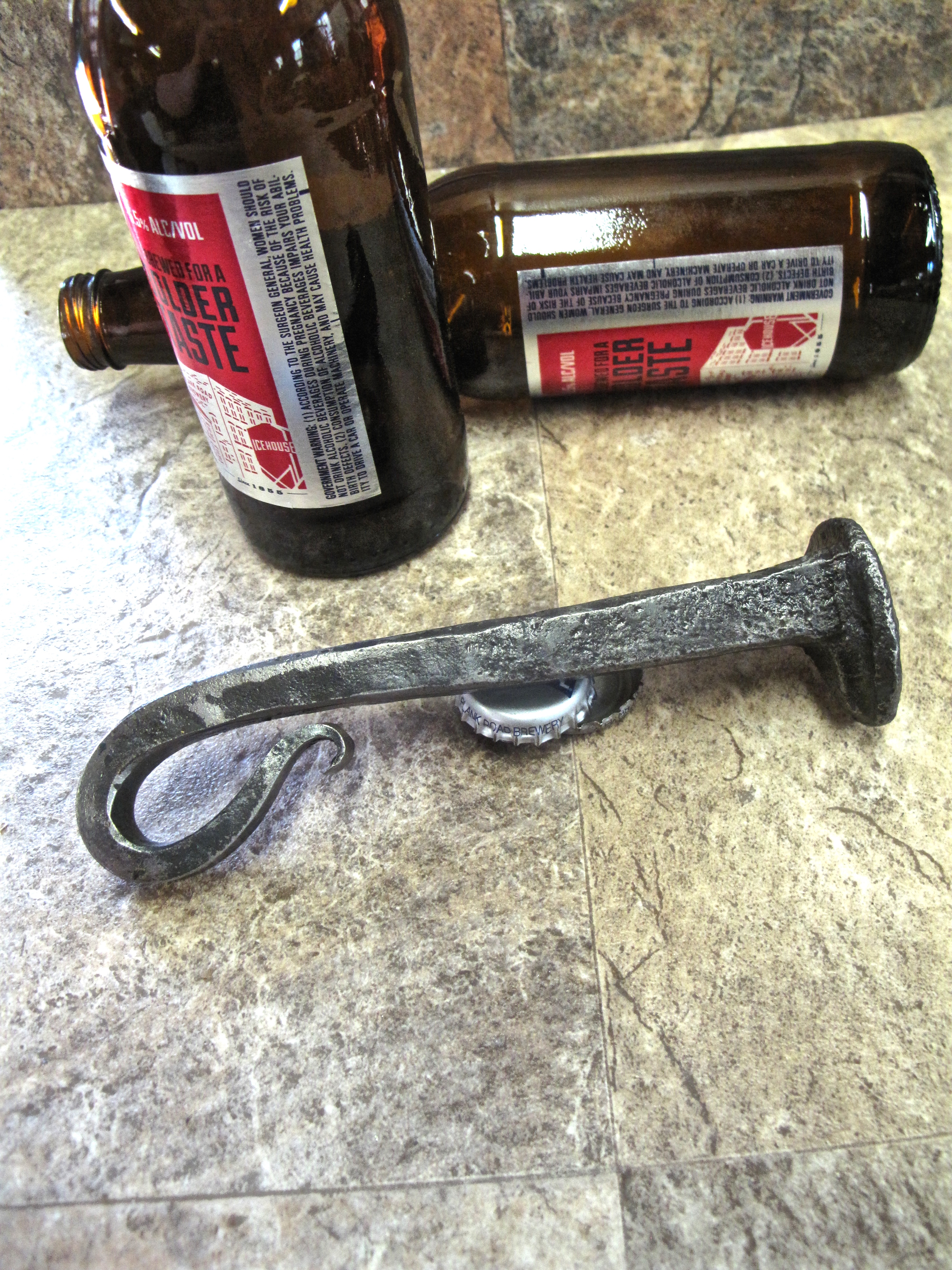

Found a few old, heavily pitted railroad spikes in the pile of bits and bobs. While I don't much like working with the things, I have to admit that it was refreshing to do something simple. I didn't do too much hammering up around the head so you get to see a nice transition from the heavy pitting to the smooth taper. OAL is just over 6". -

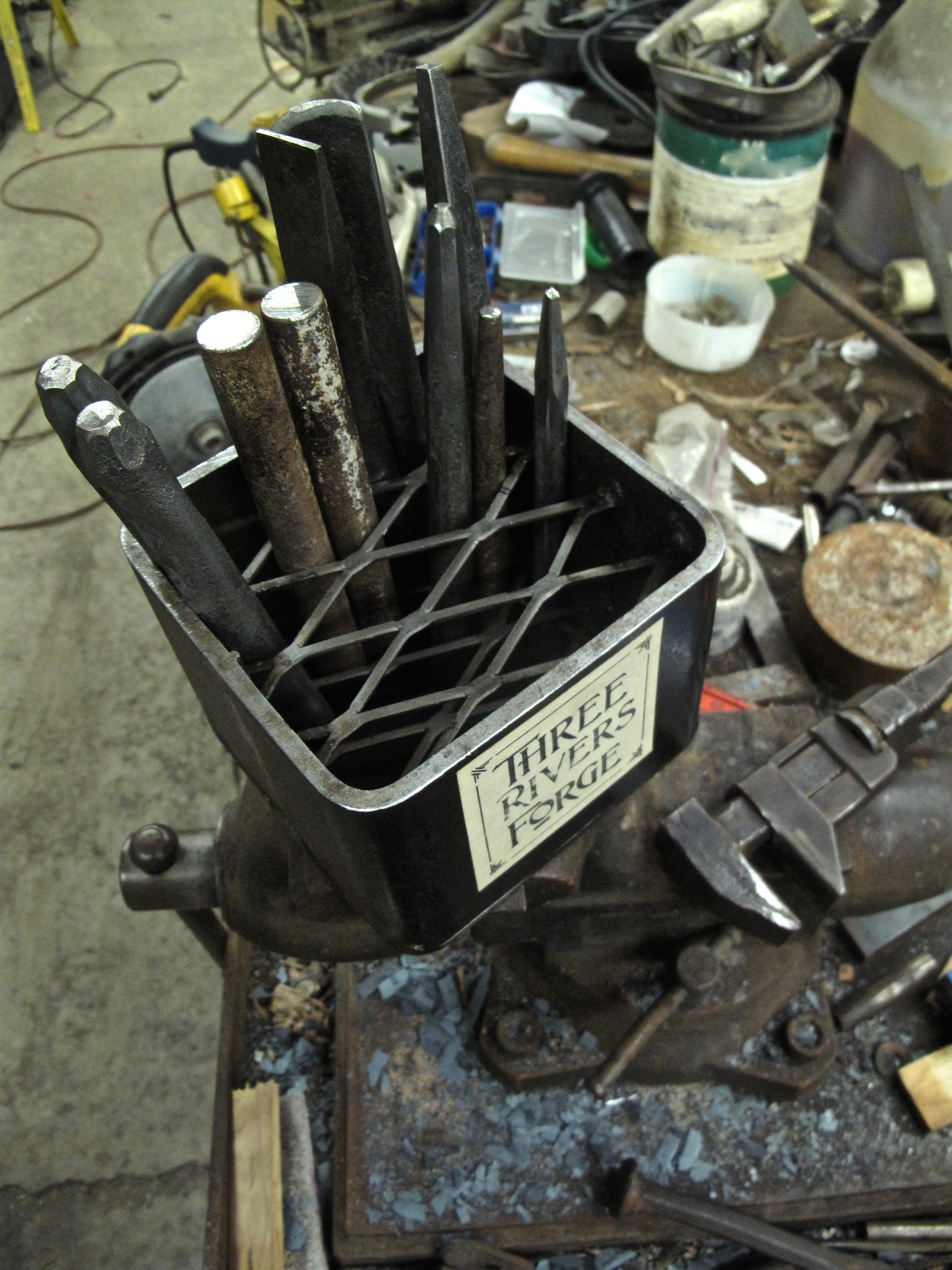

I thought I posted a pic of the finished chisel/punch holder. Maybe I put it in a different thread. Maybe I just forgot. Anyhow, it's done and it works great. My packrat-itis finally paid off and I was able to make the bottom of the organizer with projects I had scrapped, but saved "just in case"! I saved the main piece as well as the parts cut free, so it was just a matter of tacking them back together and, boom, instant bottom with convenient gaps for dirt to fall through! I almost screwed up and put the bottom on before welding in the expanded metal. That would have been embarrassing, but I caught myself at the last minute. With two layers of the EM, the tools stand tall and proud, with plenty of room for 3/4" bars side-by-side. I made the "sticker" by stamping a design on some paper and then gluing it to the body. A top coat of polyurethane should keep it looking decent for awhile! In the future, I'll probably put some kind of bail or handle on it. That'll wait until the Muse strikes and I have a bit of creative inspiration. Overall, very happy with how it turned out. It took an hour to make and will certainly outlast me. I like to imagine someone buying it at a flea market or yard sale in a few years, wondering who made it and what it was used for! -
