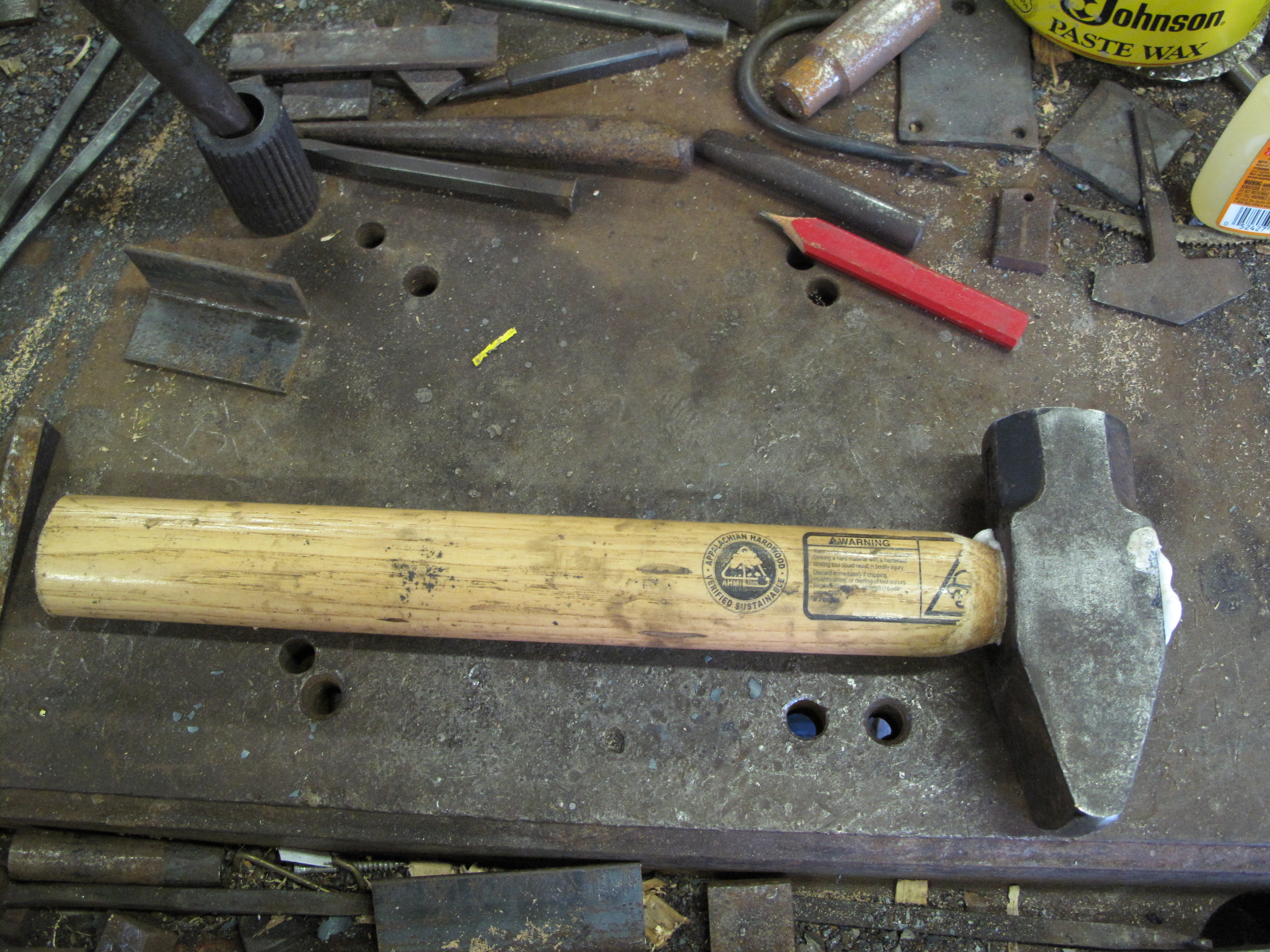

I like gorilla glue because it swells to fill the little voids between the wood and metal. It might not help things, in the grand scheme of things, but it makes me feel better. With the glue in there holding the wedges and head to the handle, I can say that I've done everything in my power to get a good bond. Once the glue has had 24hrs to firm up, I'll get that nasty polyurethane off the wood and give it a nice rub with some thinned down oil. -
VaughnT replied to Mark Ling's topic in Blacksmithing, General Discussion

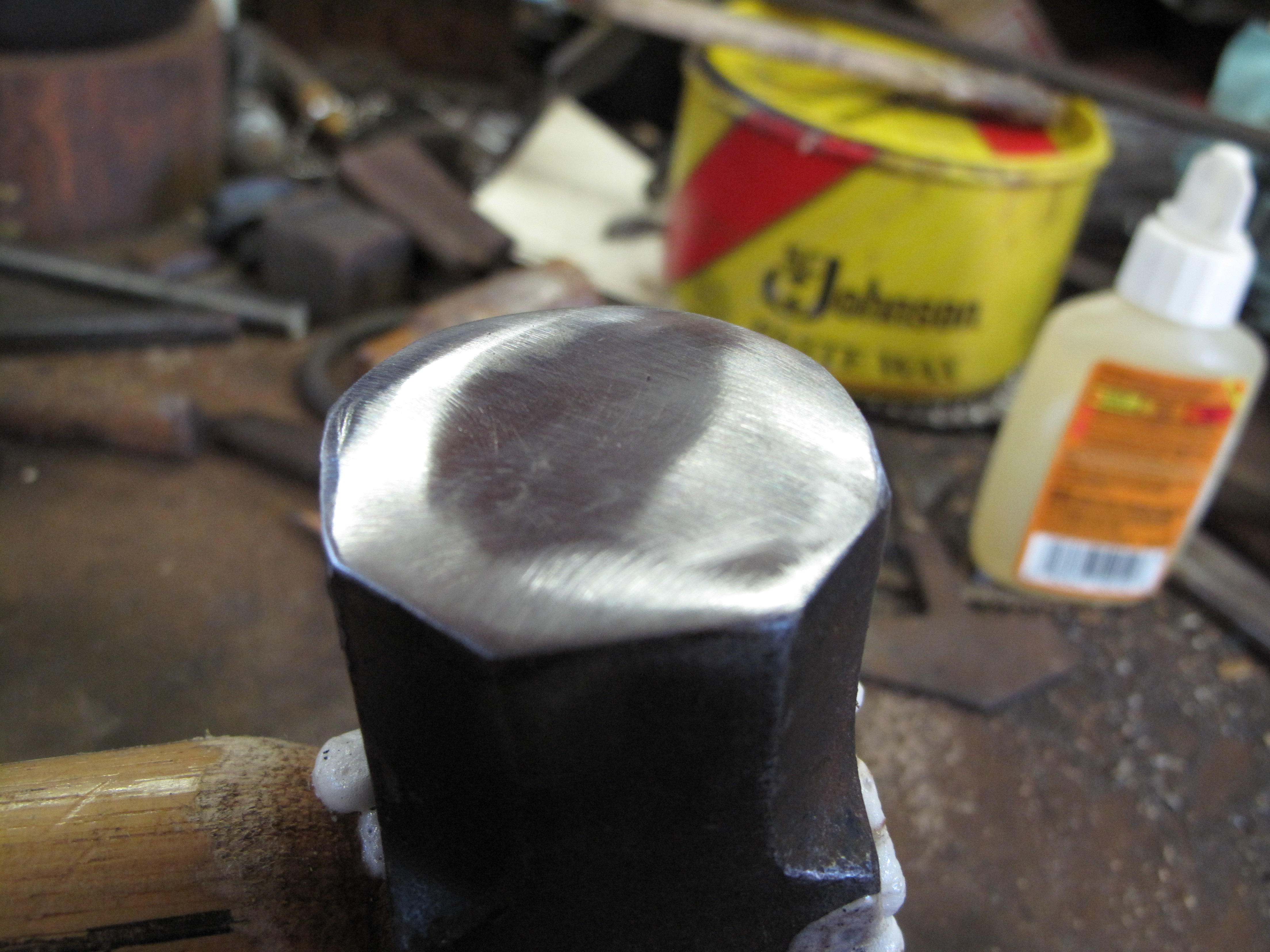

So far, today has been tool repair day. I spent a few hours yesterday making a handle for my 3# cross-peen and thought I'd take some time to re-dress the faces. This is probably my favorite hammer for general work, so it gets used a lot! Now I just have to wait for the glue to dry and I can start shaping the handle a bit. I prefer beefy handles so there won't be much shaping to this one. -

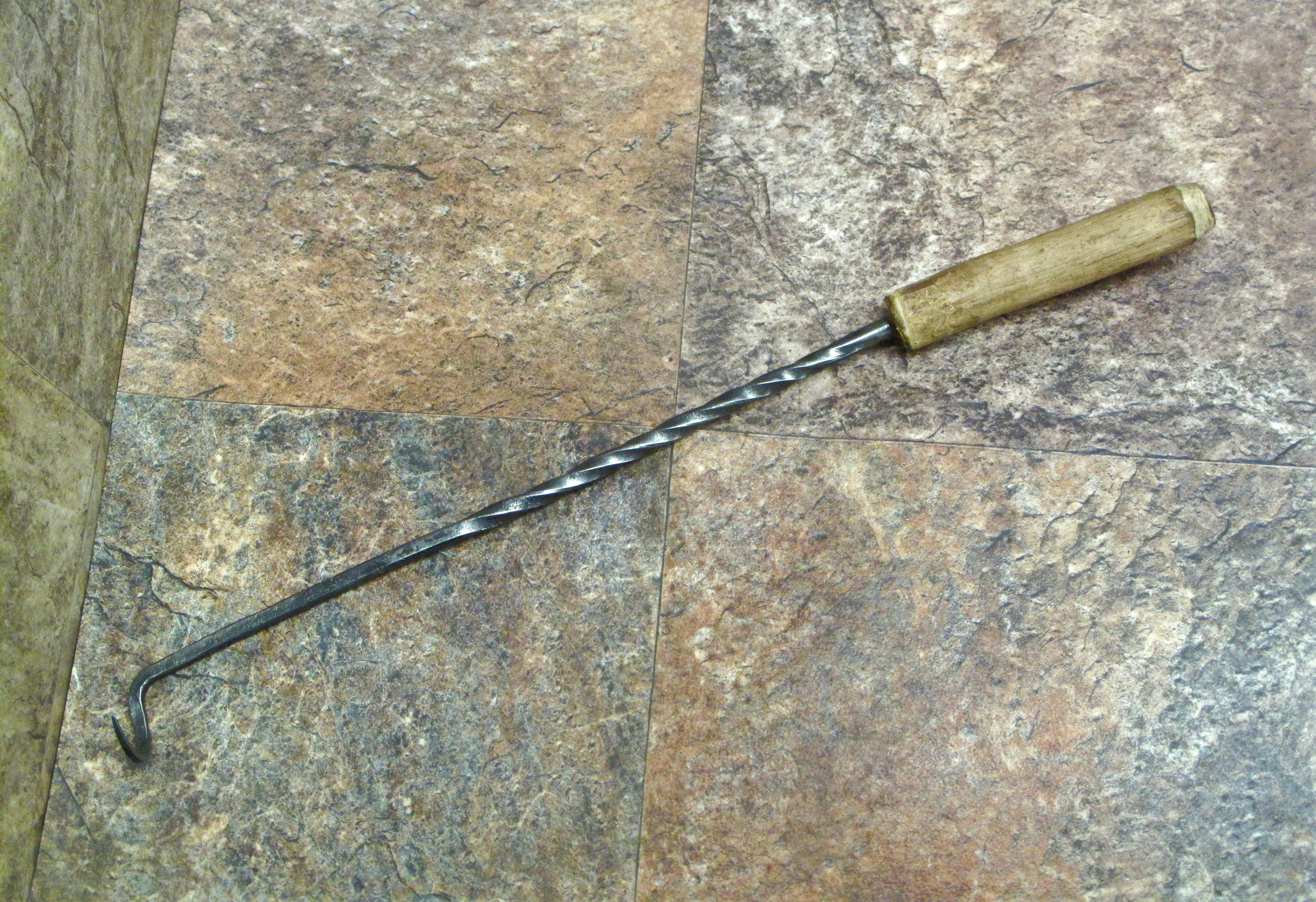

Played around with squaring up some 5/16" round bar. I tried some stick handles on them and didn't really like the look. I can see how some folks might like the look, but since the glue I tried only turned to rubber and wouldn't actually hold the pieces together, I'm searching for a different look. -

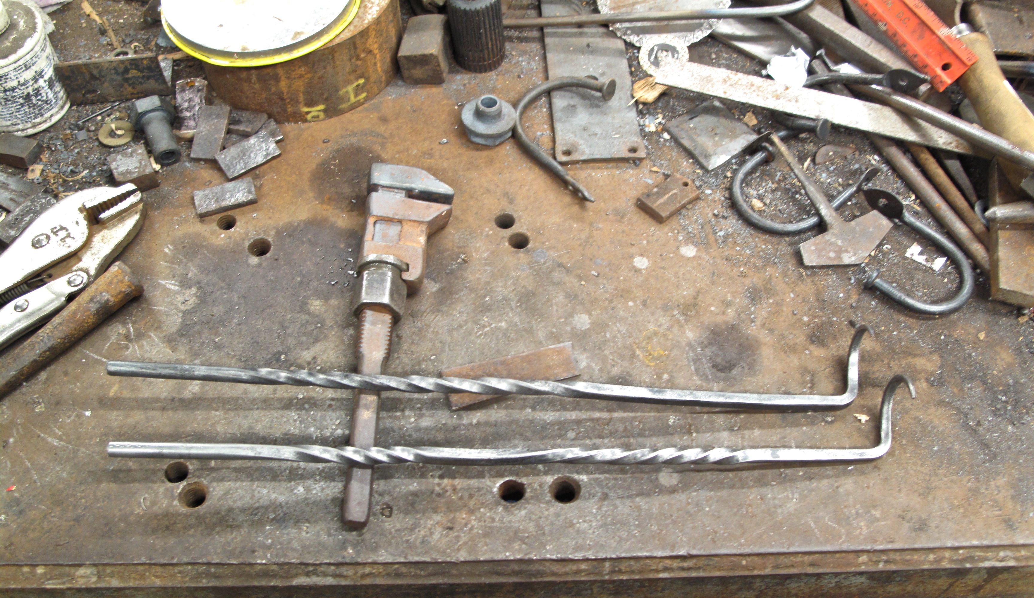

Reverse-twisting jig for 3/4" bar. The one upright slides freely so you can adjust for different projects. -

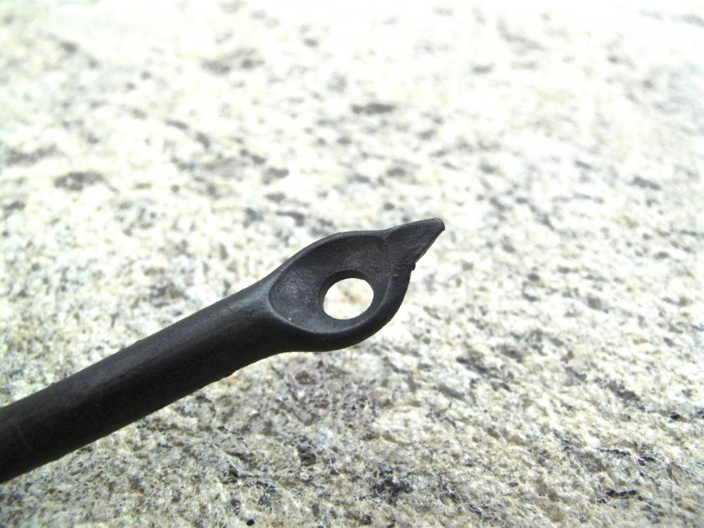

One thing I noticed is that you're flattening the area where you put the holes. This is good for punching the hole through, but also detracts a hair from the possibilities. I've been forging in a divot with a 1/2" round-nose punch, then doing the through-hole for the screw. With the divot there, you get a bit more visual interest in the piece and a dome-head screw looks really nice in them. Even with a phillips-head screw, it sits below the surface in a way that makes it look like a knot or bud. Of course, I throw all the screws in the fire and darken them first. Bronze would look great by itself, standing out a bit from the waxed steel. Also, since Australia doesn't have the big nails, it might be better to save at least one so you have a before-n-after type set up. It'd make a really neat storyboard to show folks how much you can get out of a single nail. You might consider making your own "nails" by upsetting the end of a 13" piece of 3/8" stock. As you're already doing things to the pointed end, it might be nice to do a flower-bud on the head of the nail. I'll forge one out later today and post some pics. They're easy as snot to make and go really good if you're going to do leaves on the other end.
