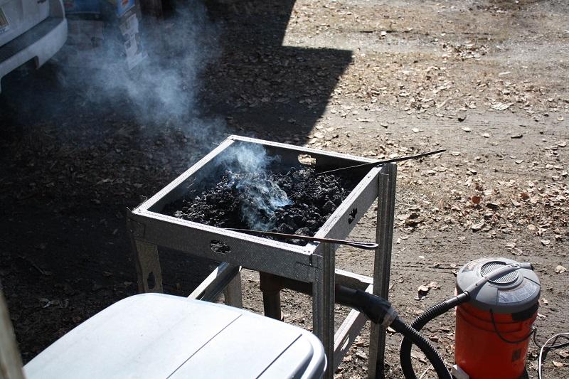

Thomas H. Posted March 19, 2015 Share Posted March 19, 2015 I am assembling a brake drum forge and I was wondering possible forge blowers ideas. I was wondering if a leaf blower might do that trick. But I am afraid the force of the air will send the hot coals airborne. A hairdryer maybe, but not really on my top list because I am afraid that it will break from over heating. My best shot I guess is probably picking up a BBQ hand crank blower, but I am not sure. If there are any websites that sell forge blowers or bellows for under $100 or less please let me know. And let me know any other ideas that are handy in a blacksmith shop Quote Link to comment Share on other sites More sharing options...

K. Bryan Morgan Posted March 19, 2015 Share Posted March 19, 2015 I use a Bucket Head Shop Vac I got at HD for about $20. It stays out in the weather and survives -60f temps. I've been using it for 5 years. Oh, and I use a sliding light dimmer to adjust the blast. Easy peasy. Quote Link to comment Share on other sites More sharing options...
