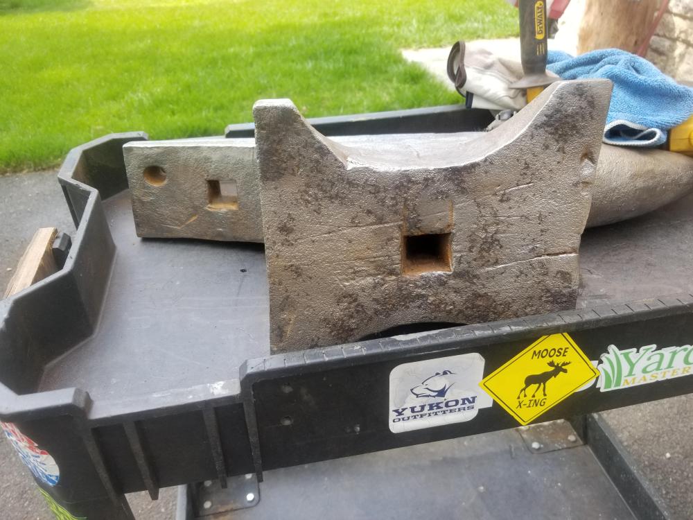

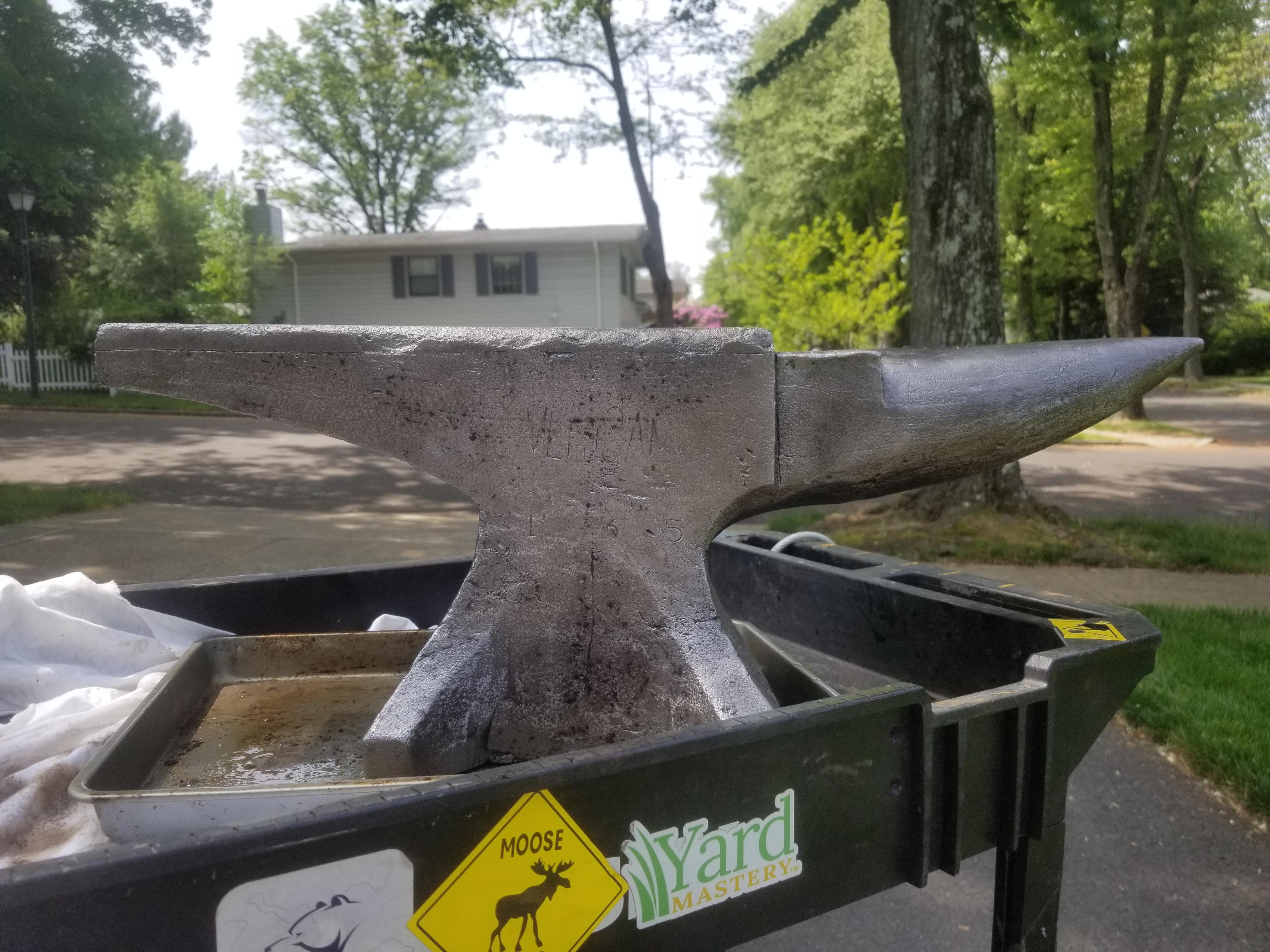

Hope this is the right place. I am writing to try and figure out what I have and what would be the best way to preserve/restore this anvil.
This anvil belonged to my old lady's father and i want to do it Justice (if possible) by cleaning it up and identifying it.
He was an artist in NYC back in the day and from my understanding he used it to make carving chisels and various tools for his sculpture. The mrs remebers cranking his forge by hand when she was 6 or 7 yrs old ( 60ish years ago shhhh).

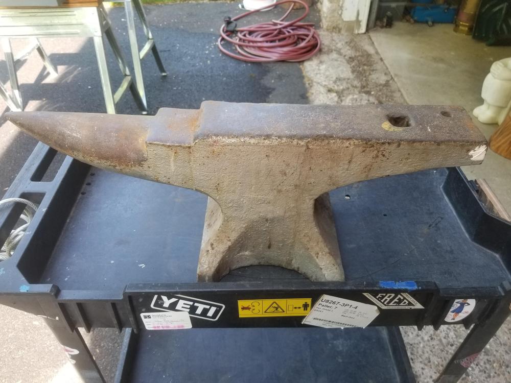

I cleaned the paint off it and soaked in vinegar then rinsed with water. Have a wire brush in the angle grinder for the surface rust. That's as far as I have gotten and am comfortable doing with out further suggestions.
I will attach a few photos of the progress so far. I am not looking to sell this or make a profit more of a family keepsake.
Thanks in advance for any and all comments.

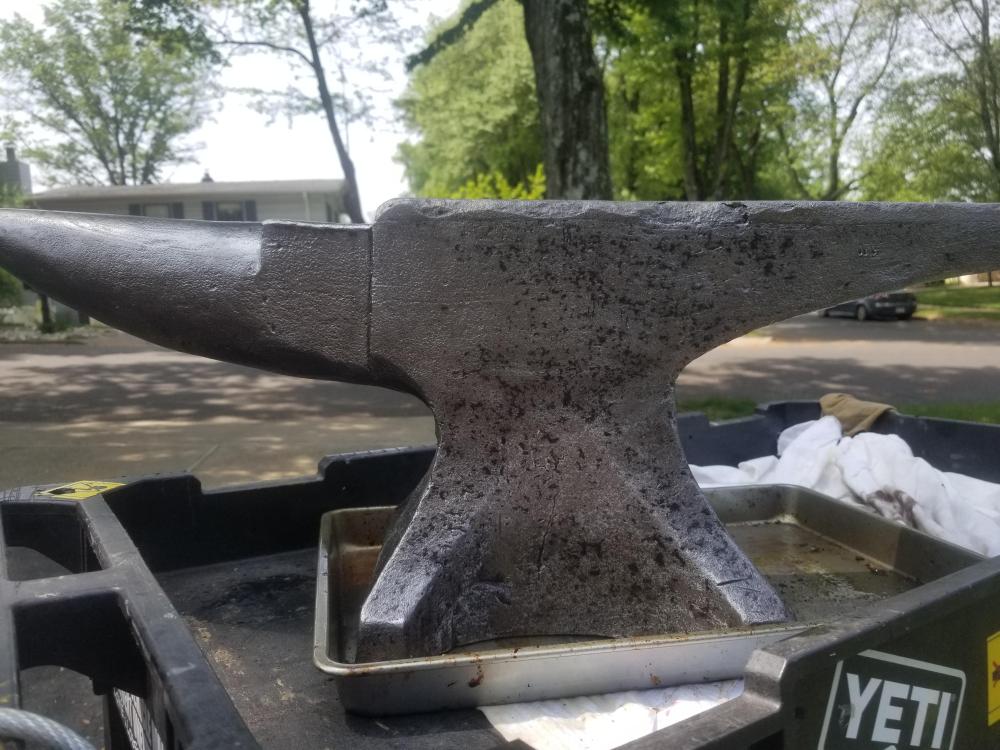

Stop right there with the cleaning process.  Working hot metal hammered on the face will make the face shine.  Otherwise proceed to the coating..
Coat the entire anvil with BLO boiled linseed oil.  It will take a couple of days to dry and then form a finish that will need to be recoated once a year or so.  ATF automatic transmission wiped on the face every time the anvil is used will prevent rust.  If it is not used, then BLO.
There are many suggestions on the site for anvil stands.  Use what appeals to you, and the wife.

First, and most importantly, DO NOT try to do more to "restore" it than you already have.  About all you should do is put a coat of boiled lindseed oil on it to protect it from rust.  Yes, there is some chipping on the edge but do not try to "fix" that by welding.  Severe chipping can be repaired by welding but it takes a very specific process which involves heating the whole anvil and using special hard rods and cooling down the anvil slowly.  Look up "Gunter-Sdhuler anvil repair method" if interested.  Anything else will damage the anvil further.
Second, it is vary likely an anvil of English origin because the numbers on the side indicate the weight in English Imperial hundredweights, tenths of hundredweights, and pounds.  An Imperial Hundredweight equals 112 pounds.  So, the manufactured weight of your anvil was 1 hundredweight (112 lbs.) plus 3 tenths of a hundredweight (33.6 lbs.) plus 5 lbs. for a total of 150.6 pounds original weight.  A very nice wight for a one man shop.  It would probably weigh in at a bit less today due to wear.
I would estimate the fair market value today of around $700-900.  However, that can vary widely depending on the market where you are.  A similar brand new anvil of that size might run you around $1200-1400.
Over all, nice anvil and there are lots of smiths who would be proud to have it in their shop.
Nice anvil, as suggested above please don't do and "restoration" or "repair" unless absolutely necessary for use.
My preference for rust proof finishing is a good quality carnuba paste wax, I use "Trewax" applied to it at fresh cup of coffee temp. Molten carnuba has a very low viscosity and will penetrate every nook and cranny. When cool it is very hard and wear resistant. The other popular brand is, "Bowling Ally Wax" yes, the same tough stuff they have to sand off to remove from a bowling ally.
George, isn't the second number in the English hundred weight system quarters? Making it 112lbs + 84lbs + 5lbs for a total as stamped weight of 201lbs?

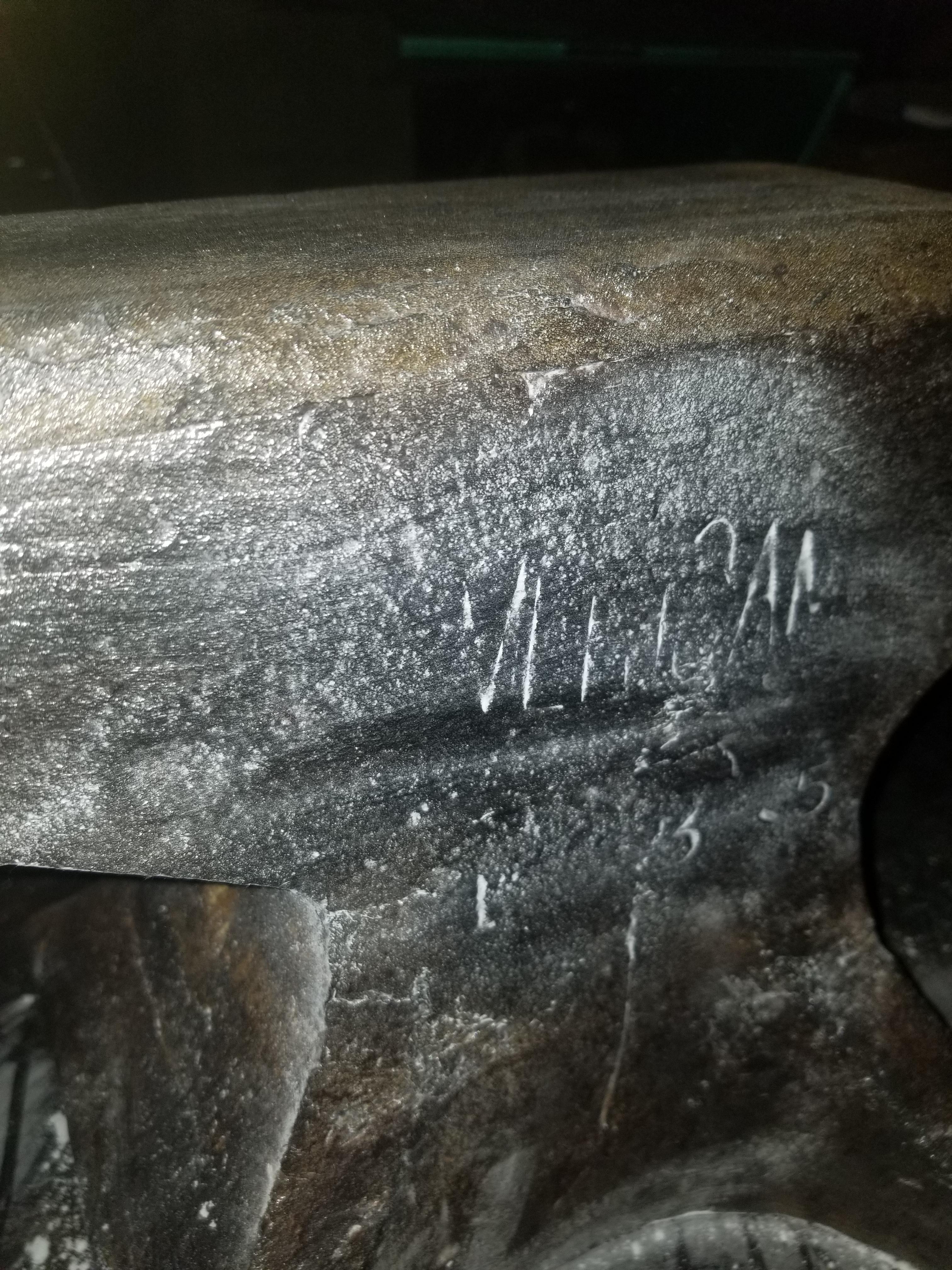

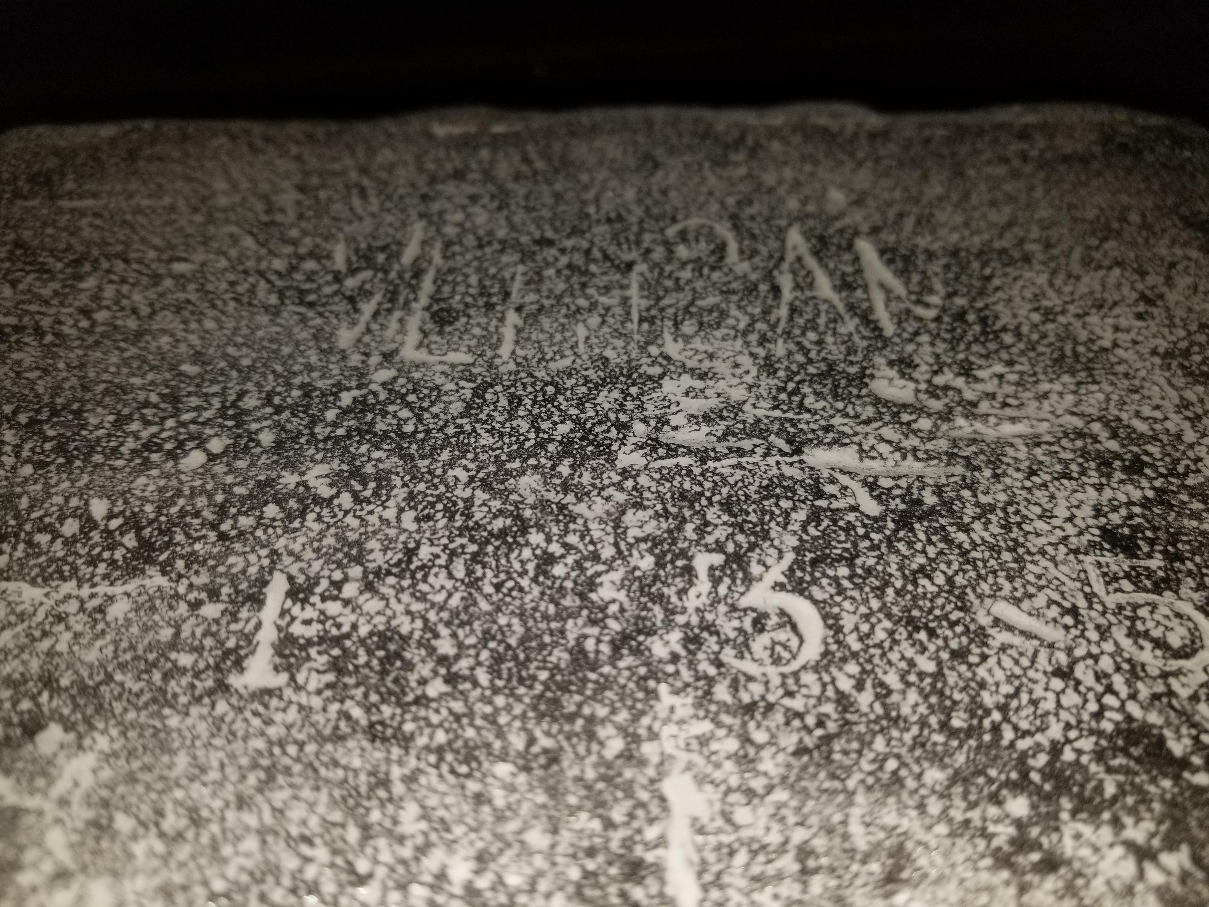

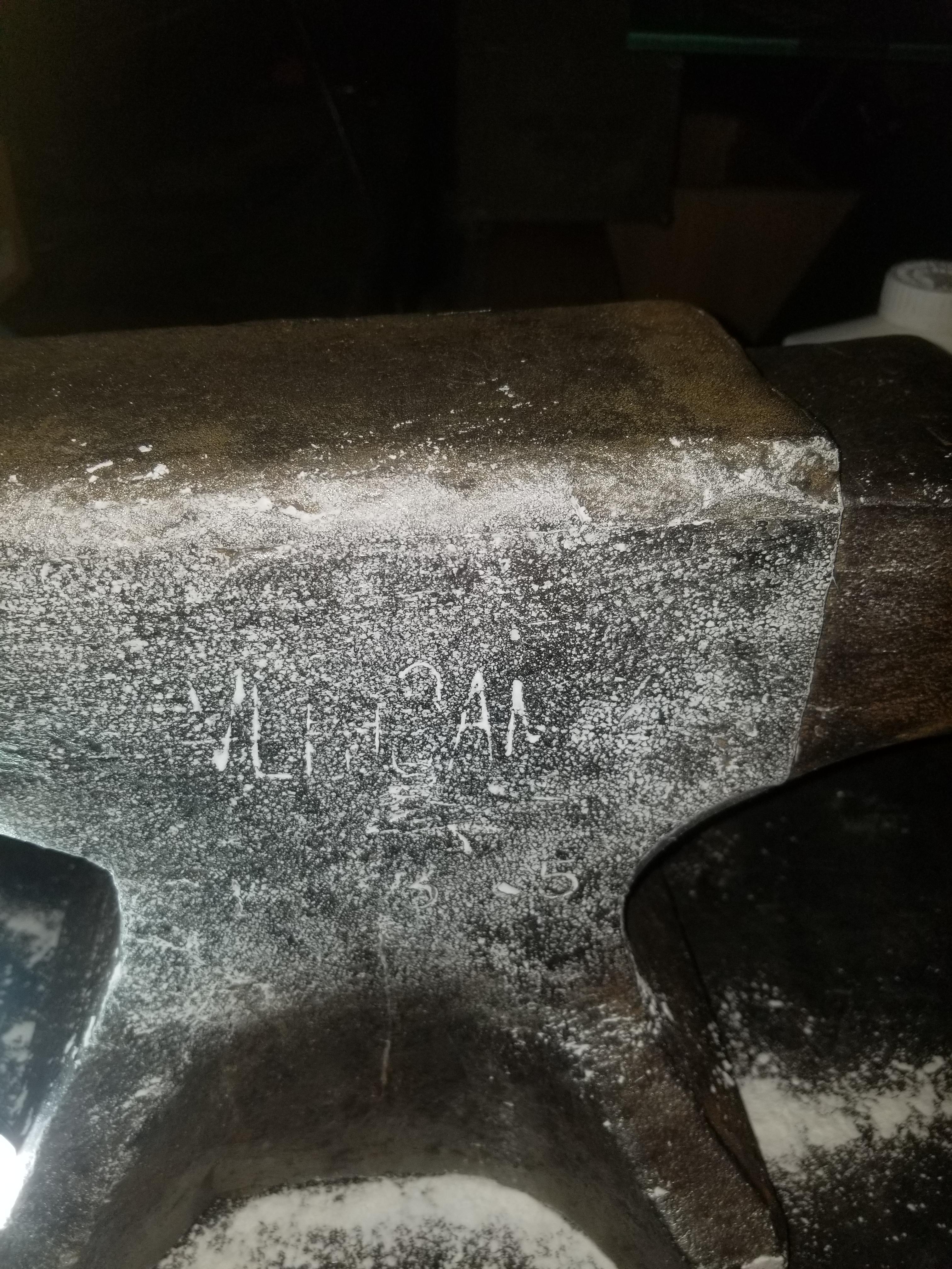

Welcome aboard, board guy, glad to have you. Before you oil or otherwise finish your anvil, try rubbing the sides with chalk, flour, and lightly wipe it off. This will bring out surface textures like stamped in the characters we can hardly make out in the second to last pic. Also if you photograph it with the light source at an oblique angle, shining along the surface rather than at it, textures will be brought out more clearly. Doing both at the same time is even gooder.
I can't make sense of it, those may have been made testing tools or some such.
By oblique light that means the light source is from the side at a shallow angle. You have to turn the flash off on your camera. As can bee seen in the first and last pics, the chipped edge is indistinct. Lit from the side all the features of the chips will cast strong shadows and reflect strong highlights making the features easy to see.
A perfect example if you have a pair of binoculars is to look at the 1/2 moon on a clear night. At the terminator (day night line) the mountains and craters stand out in bold relief. On a full moon the features at the center are mostly  bright textureless shades of silver and gray.
I thought similarly that those marks were made by the end user, either putting his name in or testing his chisels. I'll check again with the light coming from the side no flash and no other light on in the garage. Sorry for my poor photography skills. I'll check both sides but I am assuming the side with the weight stamp should be the side with any makers mark
Just went down and did as instructed,  no difference,  no other marks were noticeable. It's not a big deal as I said I'm not selling it just trying to save it from the scrap yard. I'll  finish up getting any rusts out of the books and crannies this weekend and oil it up and work on figuring out a base.

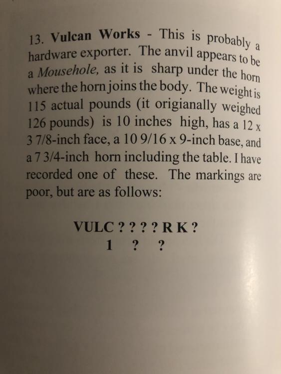

In my opinion, it looks like lettering VL?CAN. When I look up Anvils in America, I see under the English Anvils section a little blurb on Vulcan Works. Attached is a picture of the section.

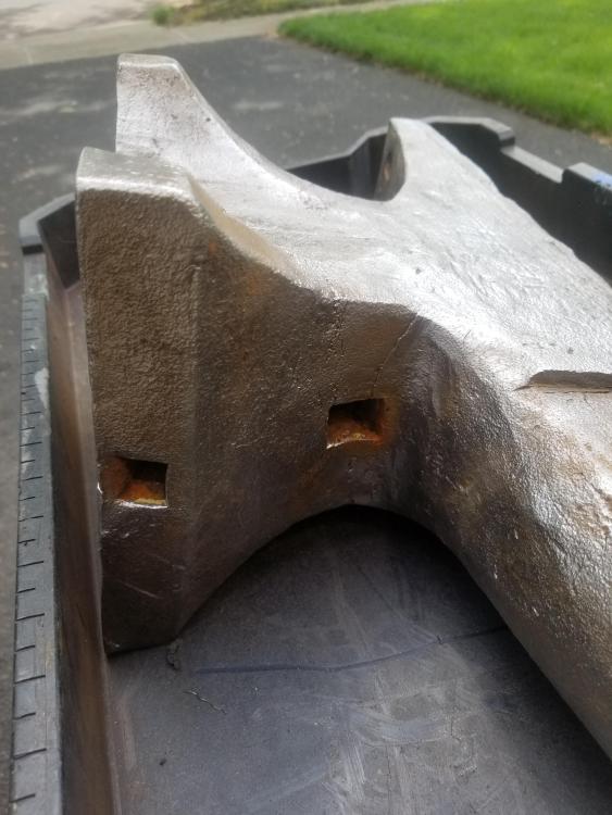

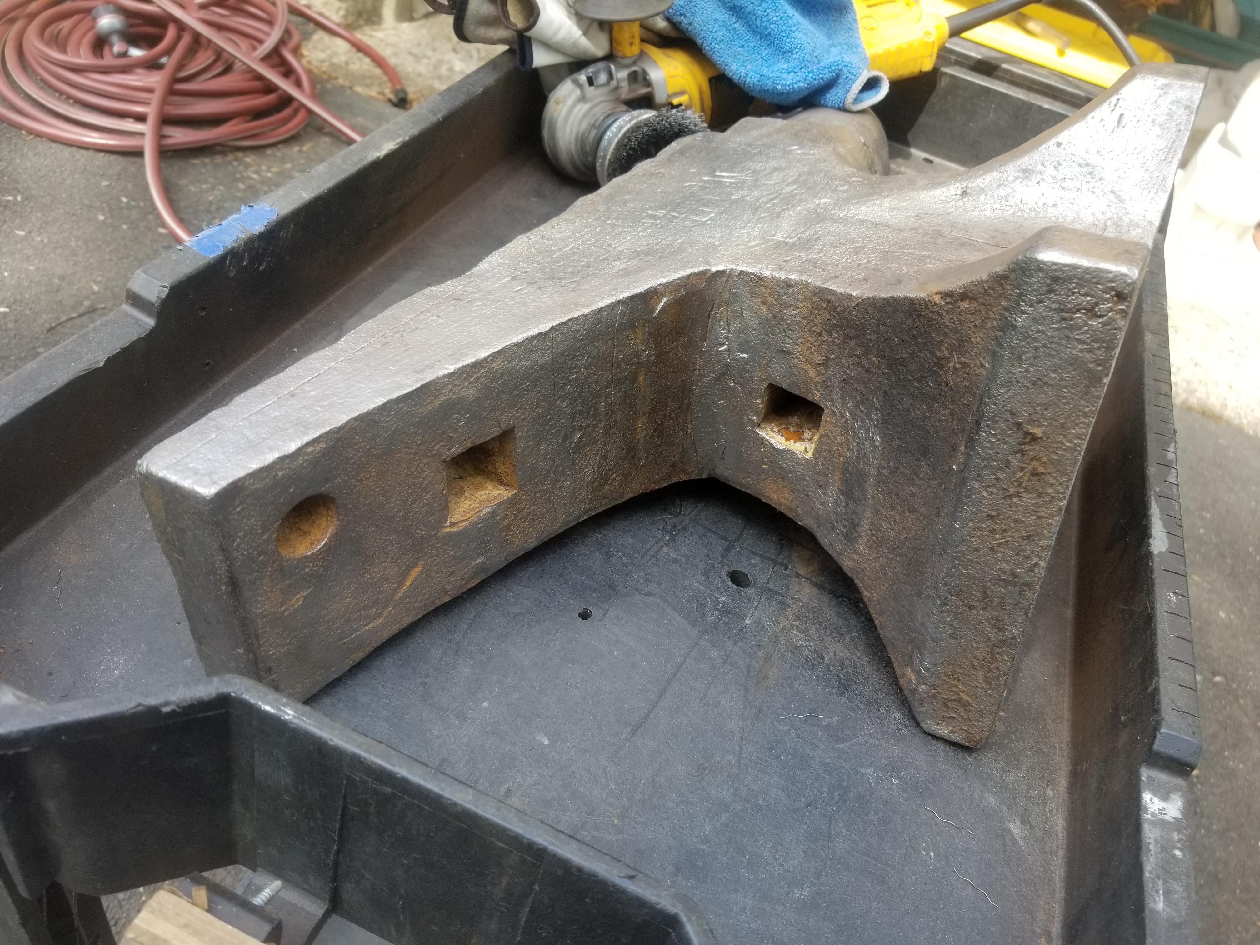

Also, Board, did you know that those square holes were used to make the anvil? While it was hot, the makers would put long square bars in them to better be able to maneuver the hot and heavy anvil under the power hammer.
It is interesting that there are no other distinguishing marks or words helping us know for sure if it is a Vulcan from England. Normally they have the word WORKS next to the word Vulcan. I'm trying to do some sleuthing googling Vulcan anvil England and looking at the results in images.

Well, I'm going to go against the grain here, ID wise. The overall shape to me looks more  modern (1900ish, +/-) US made- my initial thought when I saw the shape was HB or Trentonish. I suggest that it was made by the American Wrought Anvil Co, of Brooklyn NY. Their logo has a similar look to what we have in the pictures above. That would make the weight when mfg of 135 lbs.
Steve
As I said before, I am no anvil nerd.  However, I agree with Stash that it looks more gracile with a longer horn than most Vulcan anvils than I've seen (or at least American Vulcans).  However, the partial lettering seems to fit the word "VULCAN" .  Also, I am unaware of any American manufactor using English Imperial weight markings.  However, that could have been done to make it look more like a higher percieved quality imported English anvil.

BTW The Anvil weighs Appox. 130-135 lbs, with me holding it on a bathroom scale for those still courious.
