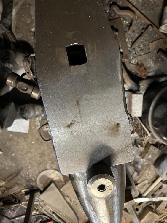

This will be my last hijacking of Arkans's thread, but thought adding some feedback on these Acciaio anvils from Vevor might help posterity?
By the way, we all assume these are made "in the same factory in China", but I read the other day someone claiming these are cast somewhere in the Czech republic. Anyone else ever hear that? anyway...
Stripping the paint for a close look at the casting reveals that it's not quite as good as I thought, but still pretty good. The area under the arch has the typical filler but of course that doesn't matter at all. Plus on the bottom of the horn under the round hole has a substantial void, but also somewhere between little and zero practical consequence.
Otherwise my vote is a positive. I slid a curved file over the top and it didn't want to scratch it (pretty much just skated) and on the horn it only wanted to grip it a little, so I wouldn't say the horn is "soft" exactly, just not as hard as the top. Nothing new here, just reiteration.
Me being a machinist, I wouldn't say the top has a great finish. It's flat and has been ground, but it wasn't done well and has a subtle texture that might transfer to your steel depending. But most of the time you wouldn't notice. I have access to a nice surface grinder and I might just clean that up. But honestly I'm just nitpicking and doubt I'll bother messing with it even though I could do it pretty easily, if that tells you anything. It's pretty good even if I wouldn't say it's "great".
couple of quick pics in case the data is useful for others. Probably a half-hour with wire brush & abrasives.
