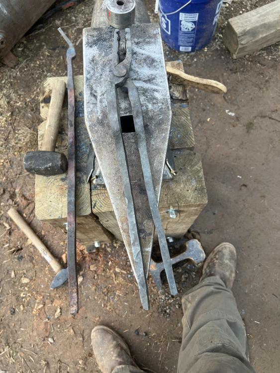

  5. Success! Yay I have made a pair of tongs!!!! I know, my river head is huge!!! I realized they was a little longer than I needed , but honestly I was worn out and didn't care at that point, and I needed to finish, But my first pair of tongs made from 1 inch sucker rod! Now I am going to let those cool off, then wipe them down with linseed oil and eat a pickle...

  7. So here are the successful attempts and black smithing so far.. so one hot cut chisel, one hole punch, and one fire rake! The fire rake I made from 3/4 inch round rebar... you can see the twist in there. I made the hot cut and punch from sucker rod. then I started on tongs, and the adventure began!!!! So I bought some 1/2 inch round bar from Lowe's and quickly found out that this was not a good idea for tongs.. one the boss is too thin. And my first attempt the Boss ripped apart around the river when I was working them lose. my second attempt, I decided to draw out the reigns from some sucker rod, then cut out enough area for the boss and jaws, and form them so after drawing out the first reign I dropped rod on accident it hit the anvil and broke off my work.. (yeah I quenched it so I could use it as a handle and draw out the other end for the other half.) attempt number three, I was doing great and discovered I had some bad material. I decided to use a piece of an old plow. Was a bent piece of bar stock but in forging the jaws and boss I found several cracks in the steel, the more I forged, the more cracks I found... (This was ring at the beginning of the reins off the boss and looking along the reins I found more cracks and what looked like delamination.) So at least for today, I am done... tomorrow I think I am going to try the sucker rod again tomorrow. I was wanting to make a few more tools from the sucker rod, but seriously I need tongs... so nothing to do but try try again!
