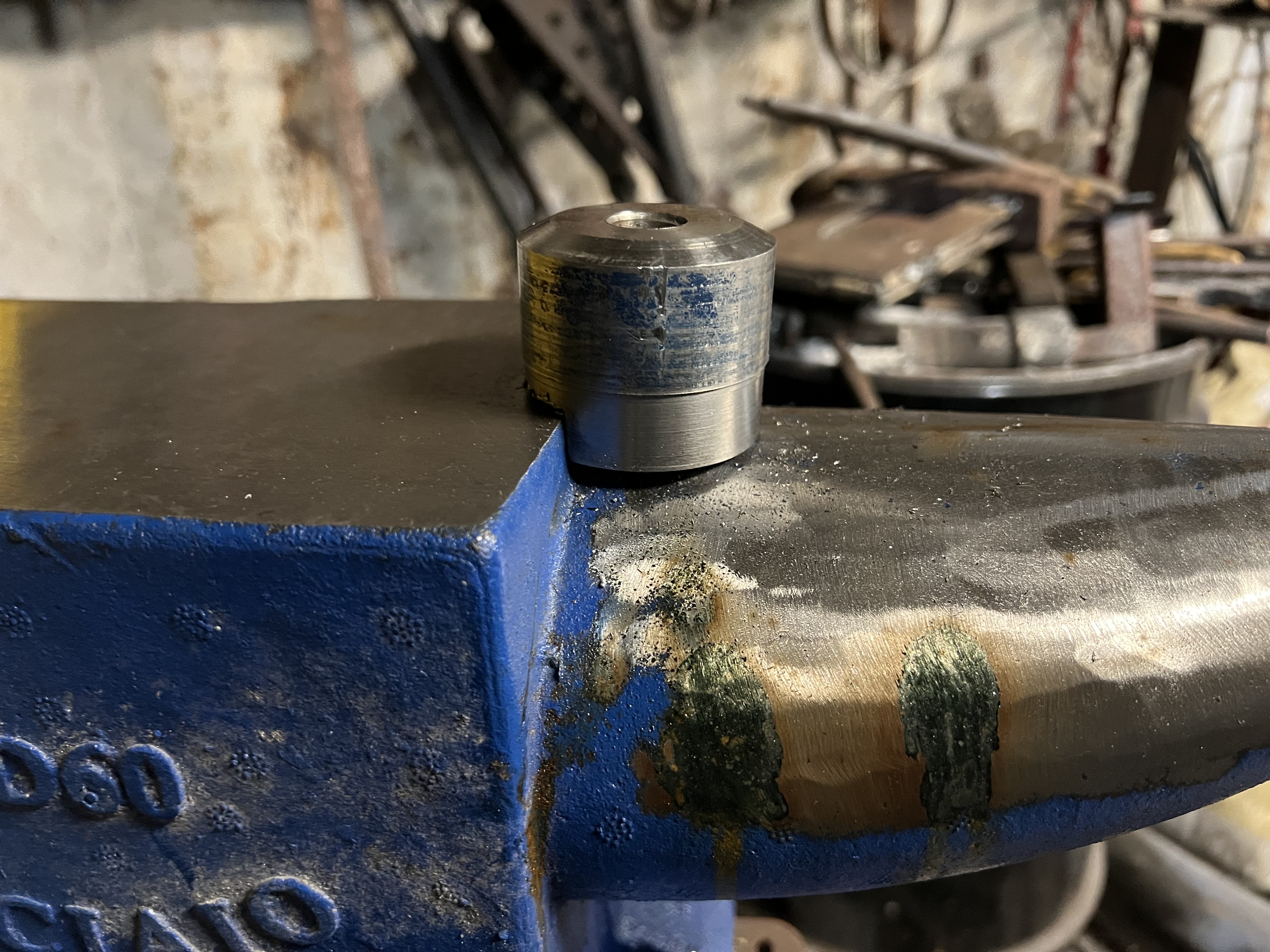

As I mentioned earlier, I am making a few modifications to my new Vevor 132. First I made an adapter for the one inch hardy to fit my 3/4 inch hardy tools. It’s just square tubing with about an inch of the sides folded down to make a flange to hold it in place.
  Then I used my flap disc grinder to round off a part of the far face corner.
The round hole (I don’t think it was ever intended to be a pritchel) is much too large to use while punching holes. I have a few stainless steel rollers. I don’t remember where they came from but the hole in the middle was just right. I turned it to fit on the lathe and milled a flat to match. I’m pretty happy with the result.
Nice adaptation.  It will be much more useful than the big hole.  How do you like the Vevor for forging on?  How is the rebound?

this is what i what i want to know... i like that what you did with the Roller there, i will have to keep an eye out  honestly i have heard about this overly large pritchel on these anvil and how they could be a problem, and it being placed poorly on the anvil.  i will thinking close to you idea with a block of steel covering that matched the deck height of the anvil, cut to fit over the horn with something welded to the bottom to hold it in that pritchel or what ever it is.  since i have not gotten mine yet, it was only thoughts, but the way you did that one looks to  simplify the my solution.  I was worried my solution wouldnt have enough steel meat to take the blows.  Since i never heard anyone suggest this, i am assuming drilling a pritchel hole on the back end of the anvil is a BAD idea? In all the reviews i have read and watched not one person have ever suggested it, so i am assuming that wouldnt be a good idea.
I originally thought I would cut my pritchel mod flush with the surface but thought better of it. The roller has a nice radius to start easy bends as it is and if it gets in the way I can just pop it out.
The face has reportedly been hardened to ~45-55. This would make drilling difficult unless you spot-annealed it with a torch, a chancy operation IMHO.
George - Rebound is reasonable, not exceptional. It is slightly better than my old anvil but not so hard that I would worry about chipping or cracking on a miss hit. I'm satisfied with it. The increased work area over my old anvil feels almost luxurious. I was considering a Rigid 165, but I don't think I can see over $1100 USD difference in what I could do with it.
