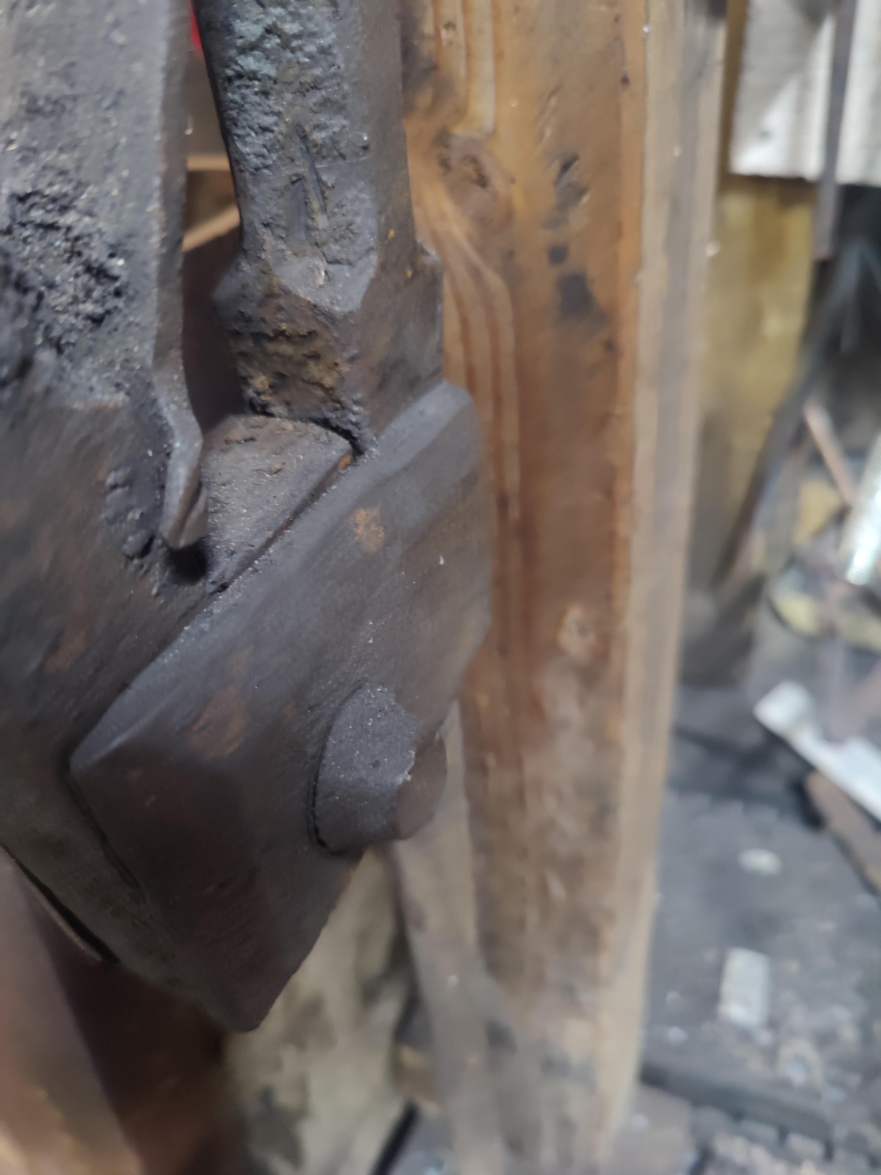

Just wanting some info on clues to when the vises were made. For instance i know that at one time the mounting bracket was held on with a tennon rather than a wedge and collar early on. Not looking for exact date just round about period dates. Like for instance around about when did they go from a rivet holding the movable jaw to a bolt? I am trying to get a round about date for my vise. It has a rivet while most i see have a bolt and you can see hammer marks on the components, uneven bevels, etc., so it definitely had some hand forging done to it when made. Thanks in advance for round about answers.

I don't recall seeing one riveted; but I've seen and owned several that had a mortise and a wedge.  Unfortunately the fellow out here who knew the most about vises was Frank Turley and he died in 2020.  (Dated one of mine with a tenon mount and mortise and wedge holding the pivot pin in place as being "pre-1800".  Not a bad deal for US$20 at Quad-State one year.)

A pic of the rivet and you can see how un even the bevels are on the side plate.
I ought to clean some of that junk out. On the leg side right above the plate was what i thought was a stamp until i scraped it off.
I checked one of my post vices yesterday and the rivet had a hole thru the other end of the shaft for a cotter key.  Necessity is the mother of
The pivot in my older Columbian is a pin with a small wedge in the end.

I know my big Trenton post vise is dated 1902, it looks to be barely used and in original condition, and it has the nut and bolt on the pivot, but it also has all the fancy looking bevels on the plates and body,
The Peter wrights I’ve seen had bevels on the bodies, but I never paid attention to the pivot pins,
fisher just went off on their own design lol:lol:
all The Arthur O Learys, Columbians, keen cutters, iron city’s and Indian chiefs I’ve had or seen
aren’t dated but they didn’t put the bevels on the body’s, and they all used nuts an bolts on the pivots,
I know Columbian made various vises all the way up till the 1980s? Till they sold out to Wilton, but I’m not sure when they stopped making post vises I’m sure that probably stopped in the 60s or 70s when smithing tool sales disappeared,
so I’m guessing that any post vise that has the wedged pivot pen an decorative bevels  has got to be mid to late 1800s,
but I don’t know what would identify a post vise made in the 1700s to early 1800S

The mount being tenoned in is a sign of an earlier vise as is the screwbox being assembled from multiple pieces and forge brazed together---including the screw thread in it!
