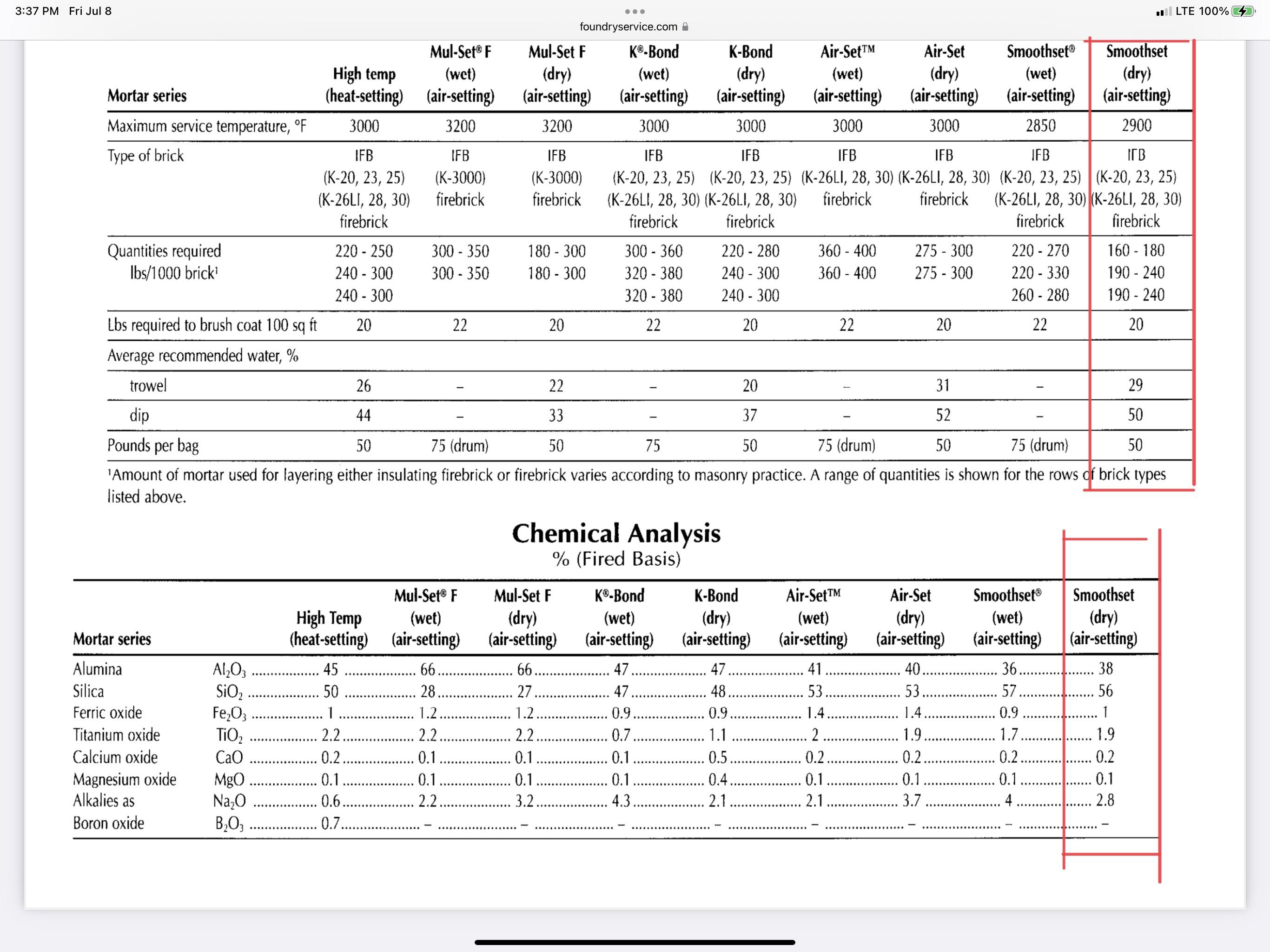

17 hours ago, jtyson said:
Smoothset refractory mortar which is comparable to Mizzou
This is an area where online how too videos not knowing enough to know what they're talking about and company marketing departments really muddy the waters. For decades, maybe centuries there was a clear difference between furnace "refractory" and refractory "cement / mortar" now unfortunately the misuse of the terms has caused companies to call proper refractories cement or mortar and now you're throwing the dice when you buy.
Also, in what way is the Smoothset comparable to Mizzou? Rated temperature isn't what makes the difference between a flame face refractory and a product intended to cement bricks together. Unfortunately you can't depend on marketing department guys to know or care. Nor do most of the guys on the interwebs where the only qualification you need to be an "expert" is a camera and connection.
That isn't on you, it's just a fact of breaking into a new craft via Youtube.
Unfortunately the 30% kaolin clay binder doesn't fire hard so it will rub off in time. Not firing hard is part of it's mechanism that prevents molten, glazes, glass, etc. from firing to the furnace work, the zirconium component is so far below it's vitrifying temperature at molten steel temps nothing sticks to it.
We are constantly shoving steel into HOT forges so if the kiln wash rubs off it just won't last.
ITC-100 used to be the only commonly known effective kiln wash and on the upside is about 70% zirconia silicate. When propane forges were beginning to be a common tool it was all that was known and it will protect from borax based welding fluxes. It's gone from legend to myth as a propane forge kiln wash. It works just not for very long. But with passing time better products have been discovered and developed.
Well I can’t totally blame the internet here. The “comparable to mizzou” was something I discerned by reading the SDS. Maybe I wasn’t looking at all the right info though. I don’t know if I have permissions to do so, but I’ll try to attach the two SDS’s to show you what I was looking at for comparison and why I figured it may not be just as good, but close enough to be a negligible difference for the application. As for the ITC 100 I paid way too much for it, so I’ll use it but I did expect to be recoating pretty regularly. Everywhere I read said that it does require that. I am curious though, could you point me in the direction of whatever product on the market now is better? That way I can look that way for the next one.
