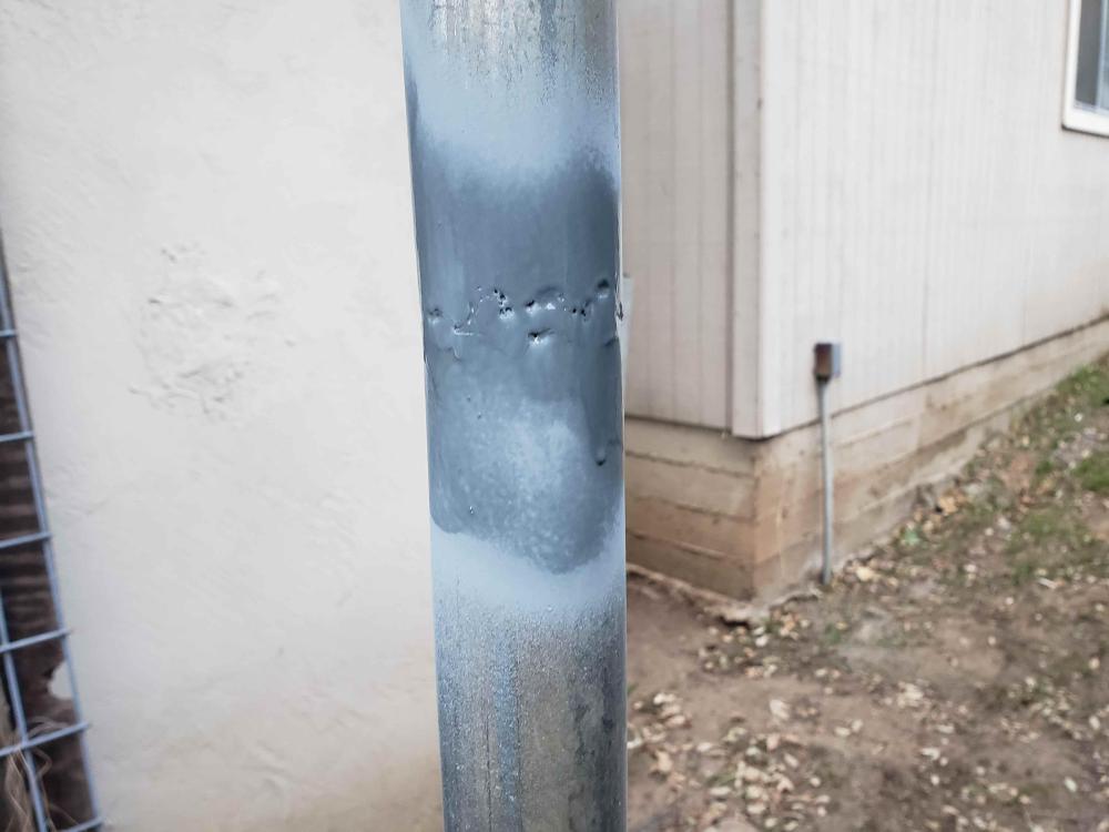

Anachronist58 Posted January 14, 2022 Author Share Posted January 14, 2022 Purple Bullet, I see that you show little resistance to dating yourself... Yes Scott, DCEP... Here is my weld in the only form you will see it on this forum. Not only is standing and walking more challenging these days, BUT, I will need to cut my electrodes in half, to control my newly acquired excessive whip tremors... The shorter the electrode gets, the better my welds... oh for days of yore... Link to comment Share on other sites More sharing options...
Scott NC Posted January 14, 2022 Share Posted January 14, 2022 I think we are all falling apart Robert. I know I am, at an accelerating pace... Keep at it best you can. My generators not for welding though. Lights, fridge, run the food chopper if needed in a pinch when the power goes out. Billy, it's a briggs and stratton. I dumped some gas in the cylinder and it ran for a bit and died. It's like new but 15 or so years old. Probly 5 hours on it. Small engines make me upset! Link to comment Share on other sites More sharing options...

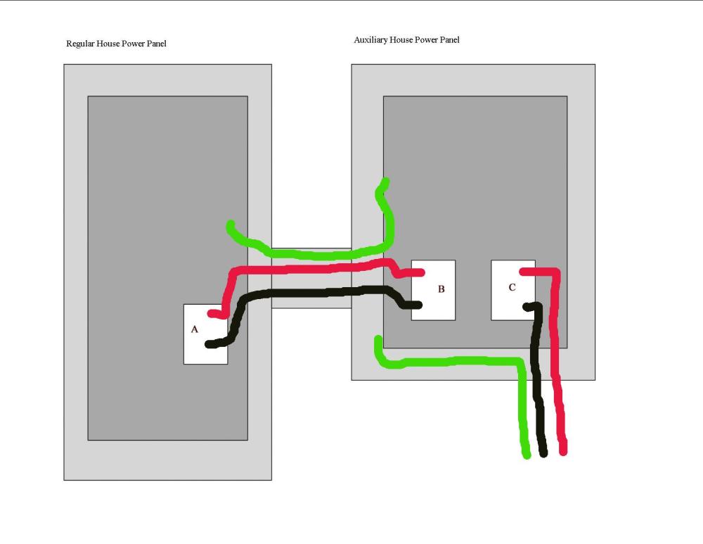

Steve Sells Posted January 15, 2022 Share Posted January 15, 2022 If you want auto start, you will also need a power transfer switch to prevent it putting out power to the system when the main power returns to service, plus its a major NO-NO to just plug it in with out protecting the linemen working on the lines due to your generated power backfeeding the lines Link to comment Share on other sites More sharing options...

TWISTEDWILLOW Posted January 15, 2022 Share Posted January 15, 2022 If a body doesn’t have a professionally installed transfer switch and standby generator, they make a special extension cord that plugs into a portables receptacles and distributes the power evenly, since we are talking about it I thought I’d mention to anyone reading that doesn’t already know, Always remember set your generator OUTSIDE!!! Never run one in the house or garage, Exhaust fumes are dangerous, With that said, you can run a extension cord through a window and use bathroom towels to seal up the crack around the cord, then hook up your fridge, heater, cook stove ect… I’ve only personally met one individual who was hmmm…. Let’s say Ignorant enough to use a suicide wire an when the main power came back on he was lucky to have a house… that generator was fried, Link to comment Share on other sites More sharing options...

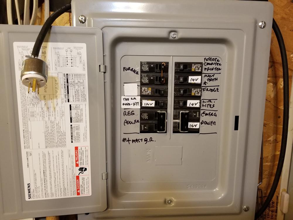

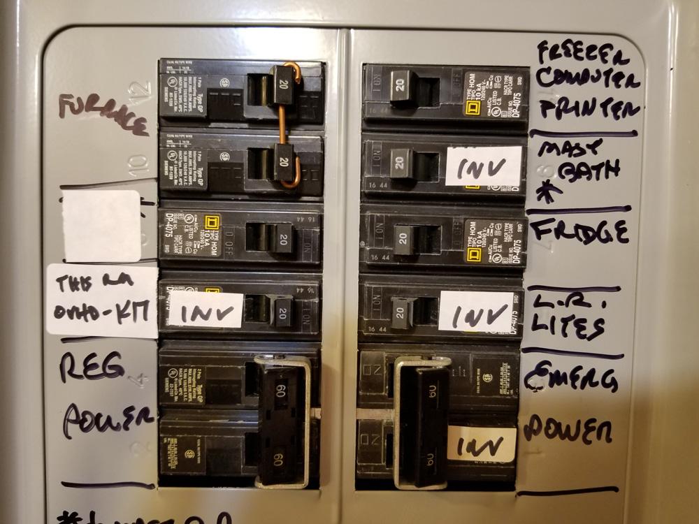

dwight55 Posted January 15, 2022 Share Posted January 15, 2022 As an Electrician's Mate in the Navy . . . I was taught the correct way to do generators . . . never have two of them on the line together unless they were absolutely designed for it to happen. But even then . . . there were accidents like described above. When I decided to fix ours up so we could use a generator . . . I started with an auxiliary panel . . . put the stuff over there that needed to be covered by the generator . . . as I could not afford a whole house one. It started with an auxiliary panel . . . and a dead man (for want of a better term) switch in the bottom. That switch has two sources of electricity coming into it . . . the main power . . . and the emergency power. They cannot intermingle . . . because the switch is designed so that when you move it . . . it turns off one circuit before it turns on the other. Pushing it to the left gives me normal power . . . to the right gives me emergency power. We started out just using an inverter . . . with all LED bulbs in the house . . . and surprisingly the inverter would give us computer and lighting power for several hours off of one 12v automotive sized battery. But the generator will power everything except the electric stove and the AC unit. I have a wood cook stove . . . and fans if necessary. Anyway . . . this design is safe . . . both for me . . . my family . . . and the linemen who would be working on our lines. Picture 1 & 2 shows the panel with the dead man switch in the bottom . . . picture three shows the electrical connection to the auxiliary panel on the right. The fridge, freezer, lights, TV, and computer all are hooked into that panel . . . powered normally by normal power . . . by the emegency power supply in other times. May God bless, Dwight Link to comment Share on other sites More sharing options...
Steve Sells Posted January 15, 2022 Share Posted January 15, 2022 Get rid of that cobbled up furnace breaker, get a real 2 pole. they wont always trip as a pair the way it is rigged, leaving the electrician a surprise when he thinks it is tripped and start to work on it Steve, who happens to be a Master Electrician for 34 years IBEW 305 Link to comment Share on other sites More sharing options...
