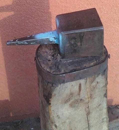

Since your time period is about 80 years too early for a cranked blower you would b e more authentic with a JABOD and either a great bellows or a 2 single bellows linked to give a constant blast.  Also, you should probably be using charcoal for fuel.  If you can lay hands on it, most of your material should be wrought iron with a bit of steel.
On the other hand, how many folk would be able to say that a hand cranked blower properly dates to the late 19th century or that coal as forge fuel came in later?  I lean towards rigorous authenticity when historical re-enacting but have been known to fudge a bit on the theory that the actual process of hitting hot metal to deform it is unchanged for thousands of years.  Better to use a slightly anachronistic tool than not to demonstrate/educate at all.

For a nice look at someone forging a low carbon real wrought iron sword using tools and equipment appropriate for the early Iron Age; may I commend to your attention:
Link removed due to advertising
(This includes a nice charcoal forge blown by two single action bellows and a cube anvil.)
