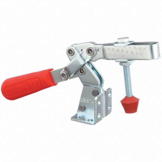

USANewbie Posted October 14, 2021 Author Share Posted October 14, 2021 I would like to try making a hold down out of one of these clamps. Quote Link to comment Share on other sites More sharing options...
JHCC Posted October 14, 2021 Share Posted October 14, 2021 That could work, but something self-adjusting (like a chain hold-down or the classic swan-neck that fits in the pritchel hole) would be faster and easier. Quote Link to comment Share on other sites More sharing options...
USANewbie Posted October 14, 2021 Author Share Posted October 14, 2021 JHCC, yes and the chain style would be more versatile too. Quote Link to comment Share on other sites More sharing options...
