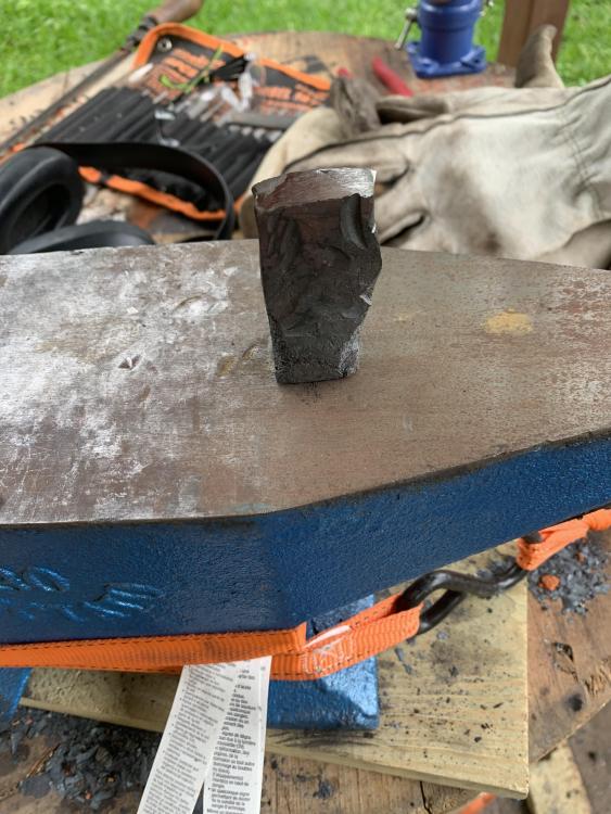

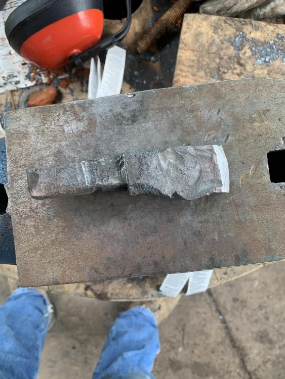

M.J.Lampert Posted May 3, 2021 Share Posted May 3, 2021 (edited) On 5/1/2021 at 2:24 PM, Bantou said: I’m not sure what steel mine is. It’s made from a piece of 3/4” sway bar off a truck. Im guessing it’s some form of medium carbon steel but I don’t know for sure. I’m planning on leaving it soft and just touching up with a file or grinder when needed. The next one I make will probably get hardened. I’m not planning on cutting anything big with it and my hammer control is so-so right now. On 5/1/2021 at 2:29 PM, Frosty said: M.J. Old pickup truck axles make FINE bottom tooling, no need to buy specialty steel and W-1 is NOT a beginner steel to heat treat and it's worse to forge unless you KNOW what you're doing. Frosty The Lucky. On 5/1/2021 at 5:26 PM, Irondragon ForgeClay Works said: I make most of my bottom (hardy) tools from the connector end of sucker rod 4130 if I remember correctly. Right off hand this is the only picture I have of one the computer ok thanks everybody i know my father has a few wrecks around the place se if i can snage 1 or 2 off him any extra cautions for working with such steels? frosty thanks the place i am able to sorce from i would have cost me 74$ for a 3/4 piece of W1 square or 38$ (USD) for 7/8 rod 3 foot for both????????????? will look into the jack hammer bits as well. M.J.Lampert Edited May 3, 2021 by M.J.Lampert spelling Quote Link to comment Share on other sites More sharing options...
