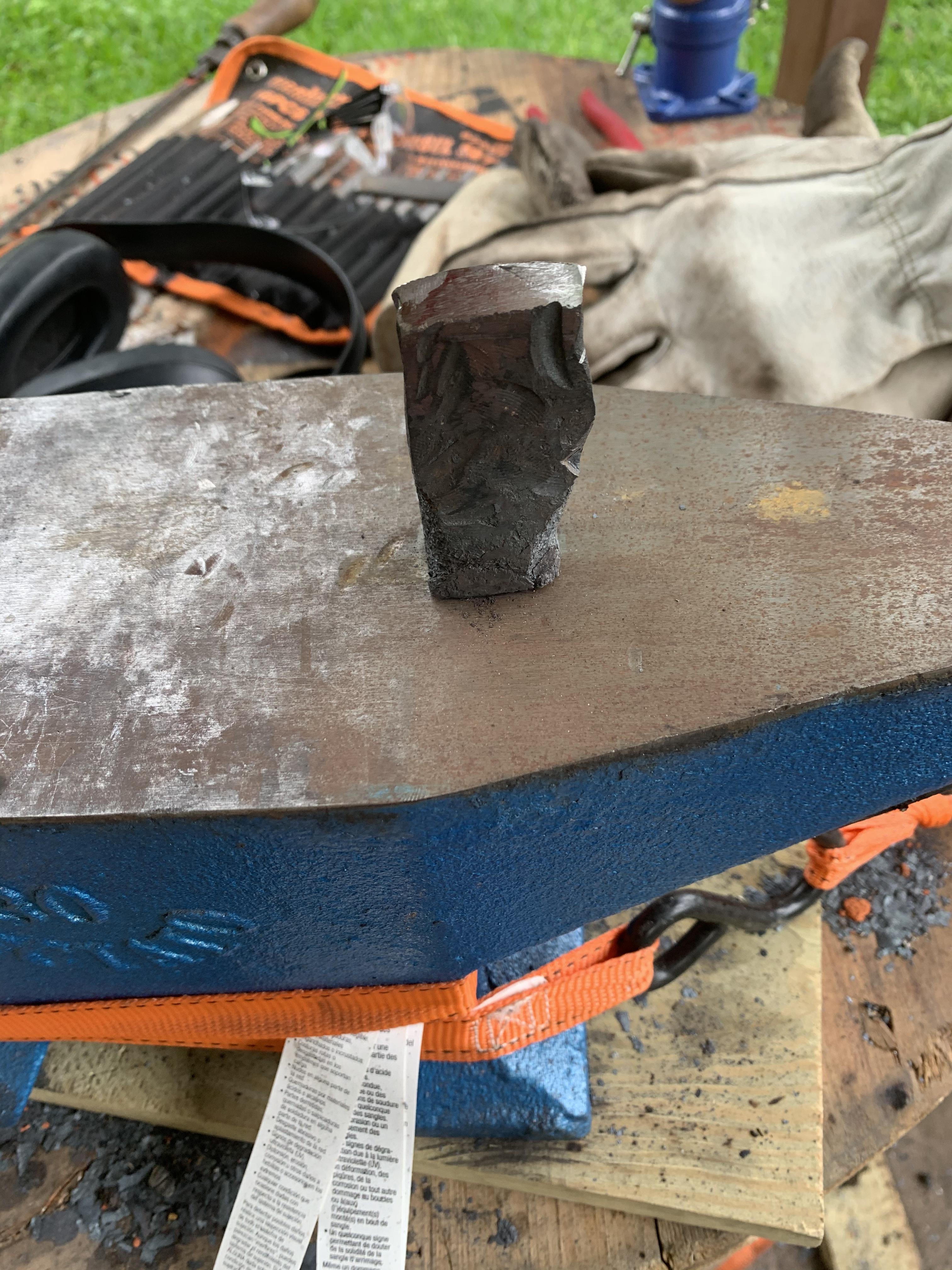

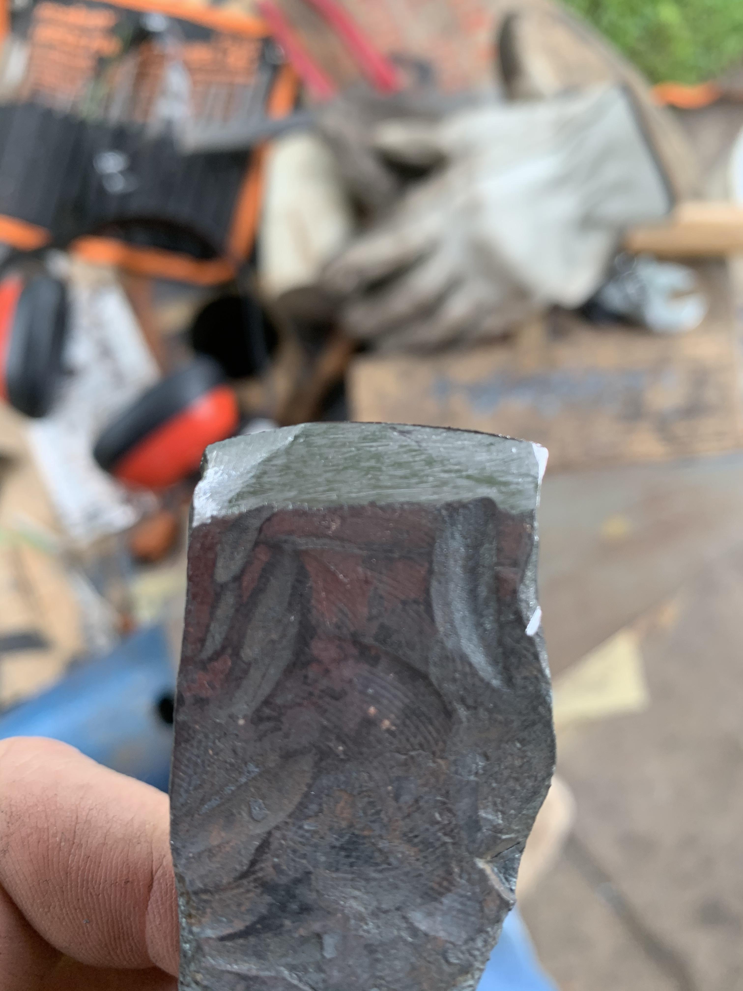

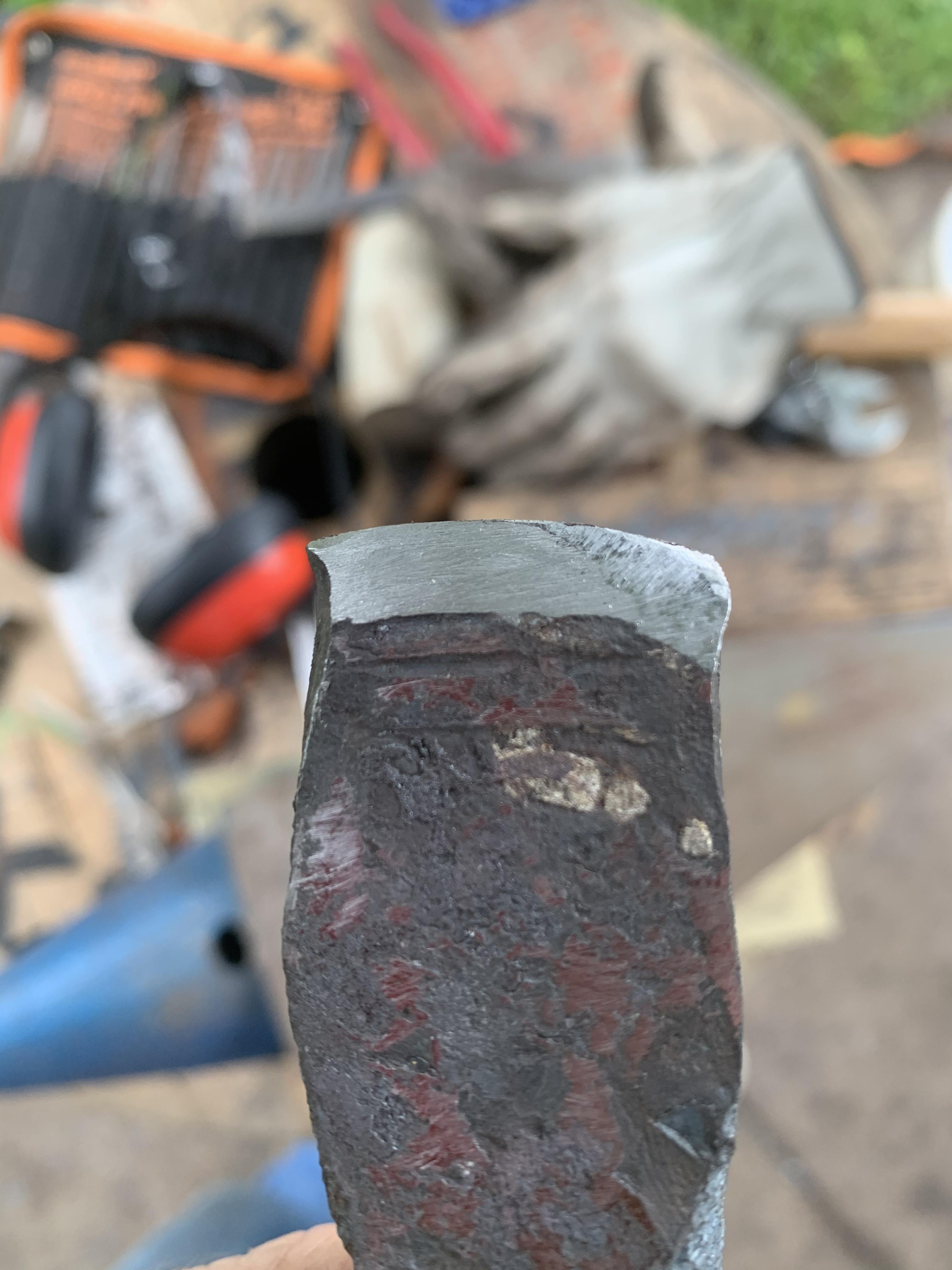

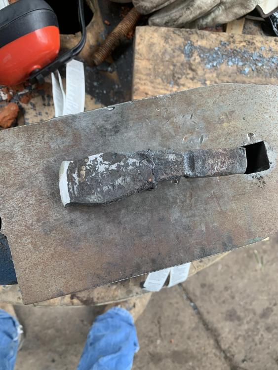

Bantou Posted April 30, 2021 Share Posted April 30, 2021 I made my first hot cut hardy over the last couple of days. Calling it rough would be an understatement. I’m not happy with the way the shoulder turned out and there is a cold shut right below the cutting edge that needs to be ground out. It is covered in marks from the cross peen that I didn’t get out fully and the shape isn’t exactly what I was going for. My biggest mistake was starting with stock that was too small. The starting size of the stock was the same as my hardy. After multiple attempts, I was able to upset the entire piece enough to make it work. The upset wasn’t even though and made it difficult to tell if I had the piece trued up perfectly. As a result, the portion that I drew down to fit the hardy wound up being slightly off center. When I set the shoulder, I wound up with barely a lip on two sides and an acceptable shoulder on the other two. Looking back, I could have saved myself hours of work and wound up with a better tool by just hunting down the appropriate sized stock. I’m hard headed though and was bound and determined to “make it work.” The cold shut was caused by a fish lip that I didn’t catch in time. When I tried to correct it, it folded over instead of flattening out. I was hoping that it had happened early enough in the forging process to not wind up on the cutting edge. I know better now. I’m going to pick up a HF bench grinder tomorrow (people around here on FB market place, Craigslist, etc want new prices for “antique grinders”) and try and grind out the shut. It’s just too deep for me to reasonably get out with a file. I was able to get a nice radius on the edge though and managed to shape it enough while forging that sharpening it with a file wasn’t unbearable. It also fits snugly in the hardy without being so tight that I will have to beat it out. If it fails, I’m not going to be heart broken. I learned a lot and that is my main goal right now. I’m going to be cutting small stock with it though so I think it will be ok. Quote Link to comment Share on other sites More sharing options...
ThomasPowers Posted April 30, 2021 Share Posted April 30, 2021 I would suggest a larger radius on the crosspeen as well. Quote Link to comment Share on other sites More sharing options...
Bantou Posted April 30, 2021 Author Share Posted April 30, 2021 It’s in the plan. I don’t have an angle grinder yet. I tried with a file and finally gave up. It was working but I would have been at it for hours. I’ll pick one up tomorrow when I get the bench grinder. I know HF doesn’t make the best quality tools but they will work for the time being. Quote Link to comment Share on other sites More sharing options...
Irondragon Forge ClayWorks Posted April 30, 2021 Share Posted April 30, 2021 I have an 8 in bench grinder from HF that has been going strong for about 5 years now. Quote Link to comment Share on other sites More sharing options...
Frosty Posted April 30, 2021 Share Posted April 30, 2021 2 hours ago, Bantou said: Looking back, I could have saved myself hours of work and wound up with a better tool by just hunting down the appropriate sized stock. I’m hard headed though and was bound and determined to “make it work.” A properly blacksmitherly attitude my friend. Don't use a cross or straight pein on a hardy. Use the horn as a bottom fuller to control the direction the stock moves. If you don't have a horn use a piece of round bar as a bottom fuller. Not to pick nits but the tool you made IS a HARDY, "not or cold" The square hole is a Hardy Hole. Other tools with a square shank are bottom tools though more and more folks call them hardy tools but - but. . . <sigh> You have enough shoulder to prevent the hardy being wedged in the hole so as long as you don't do any heavy hammering on it it should be okay. It may be kind of homely but if it works it's a tool. Keep it as a reminder of how far you progress. The curve only leads up so long as you walk it. Frosty The Lucky. Quote Link to comment Share on other sites More sharing options...
Bantou Posted May 1, 2021 Author Share Posted May 1, 2021 I’ll definitely try the horn on the next one. The marks in the shank came from an attempt to use a piece of 1/4” round as a bottom fuller to start the shoulder. I’m not planning on cutting anything larger than 1/2-5/8” on it. Anything bigger will get cut with the angle grinder for now. Once I get a little more experience under my belt, I’ll try to make a better on. My next several projects are going to be made out of 3/8” round. I’m making some decorative stuff for Mother’s Day. Quote Link to comment Share on other sites More sharing options...

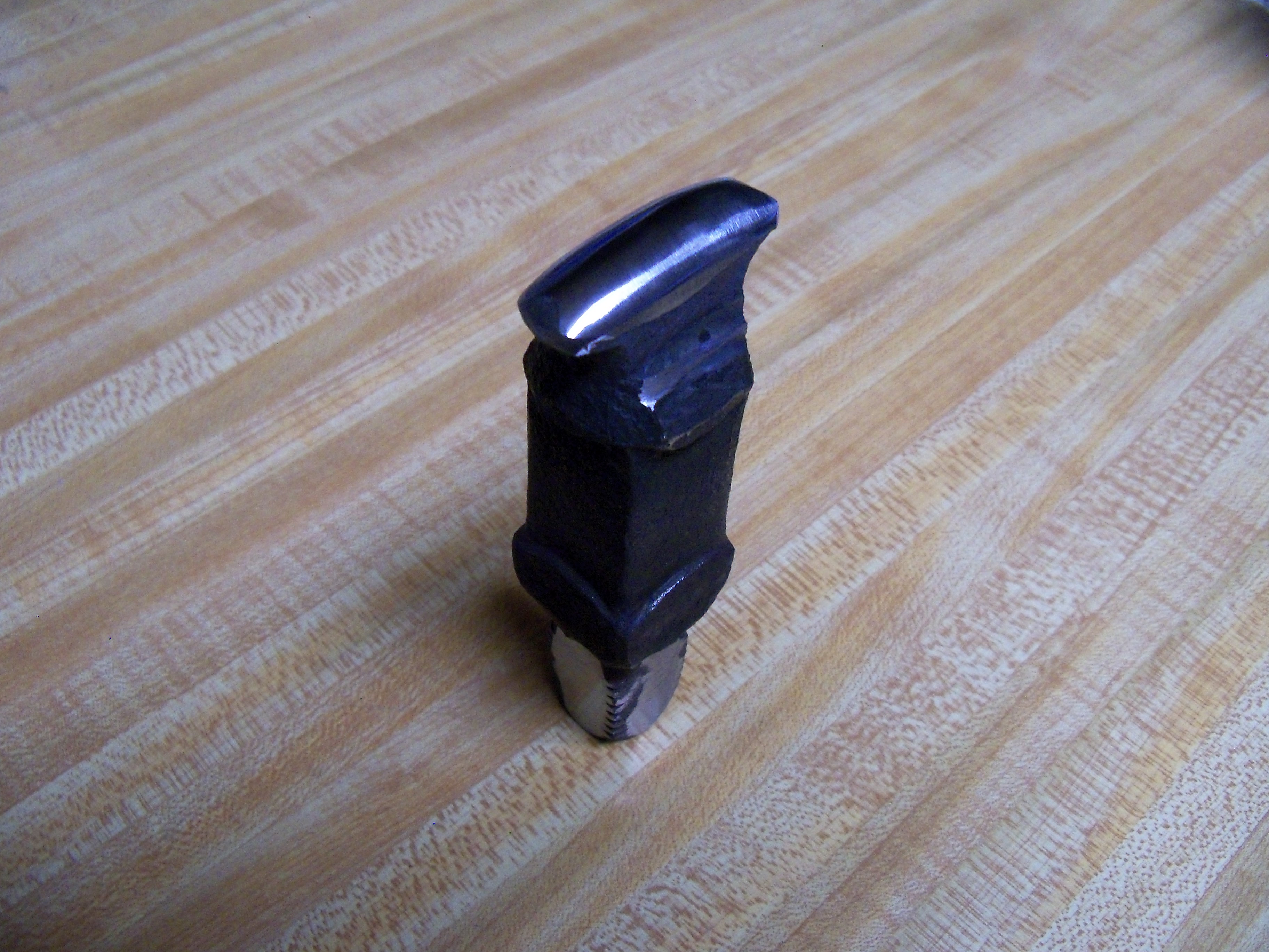

Irondragon Forge ClayWorks Posted May 2, 2021 Share Posted May 2, 2021 I make most of my bottom (hardy) tools from the connector end of sucker rod 4130 if I remember correctly. Right off hand this is the only picture I have of one on the computer. Quote Link to comment Share on other sites More sharing options...
