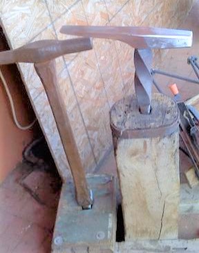

February 1, 20215 yr The "cube of metal" has been used as an anvil for about 3000 years, London pattern for about 300. I also built some anvil stands from rough sawn oak. I cut to length, with the outer two pieces longer and then aligned them on an H beam (I-beam on it's side). Clamped them with pipe clamps and drilled them with an electricians drill bit and used long bolts I got at the scrapyard to hold them together, been using them for years now... My cube anvil on it's side, the stake anvil I made to have a "horn" and an example of my anvil stumps:
