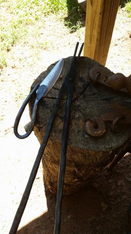

George, A locking, folding pocket knife, but the body of the knife is made from something like a .25" or .375" round rod, usually flattened on the side, and the attachment point for the blade is flattened into an offset medallion, like the half-penny on a scroll. There's a small place filed out in the top back of the blade, which holds the blade open with the body acting as a spring.  Schrade used to make a very ugly one. There's an older Gary Huston video showing him making one somewhere; I can't find it.  This is one of my early ones, if you couldn't tell by the terrible pairs of tongs.

Wire  jack knife      as a search string showed results right from the top!  I always assured folks I had washed my knife after skinning something before eating lunch with it.

Nobody:  Thanks.  I'm familiar with that style, I just didn't know the term.  Interestingly enough, I have been looking at making a similar sort of a knife using a folded horse shoe as a handle with a piece of spring steel sandwiched between for a latch for a horsey friend.
I had a friction folder I used to make by folding half a shoe.  It's heavy and clunky as is, but you can file down the inside to about half thickness or so and it works well. Back end works as a hoofpick.
