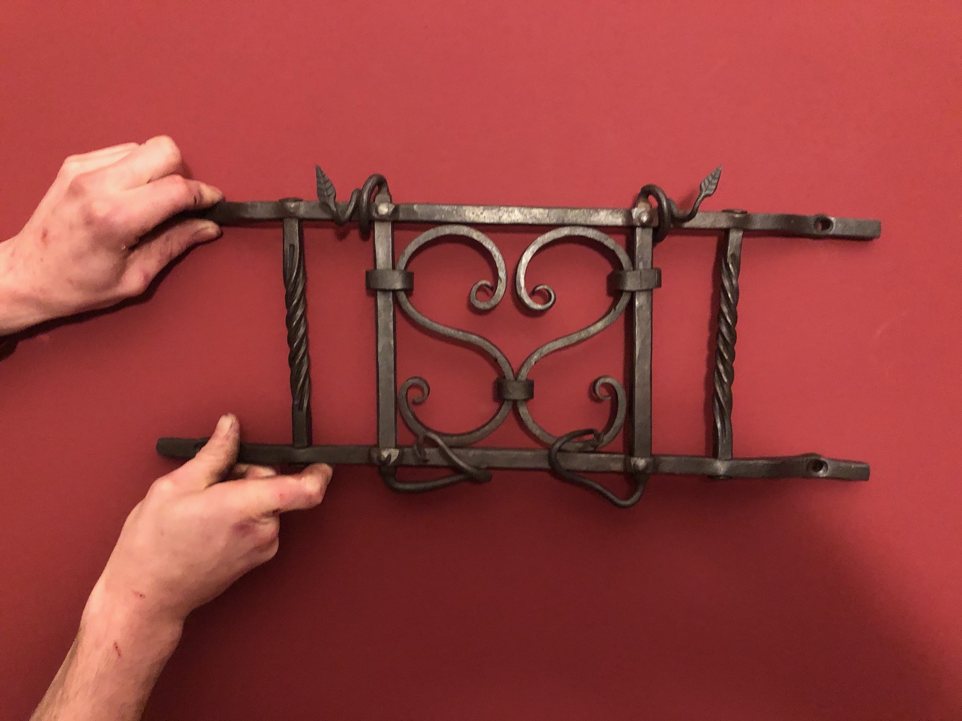

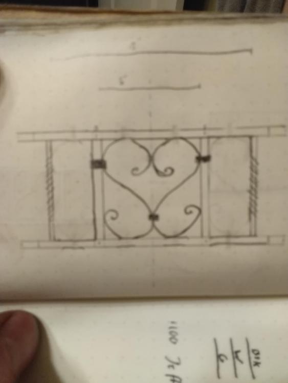

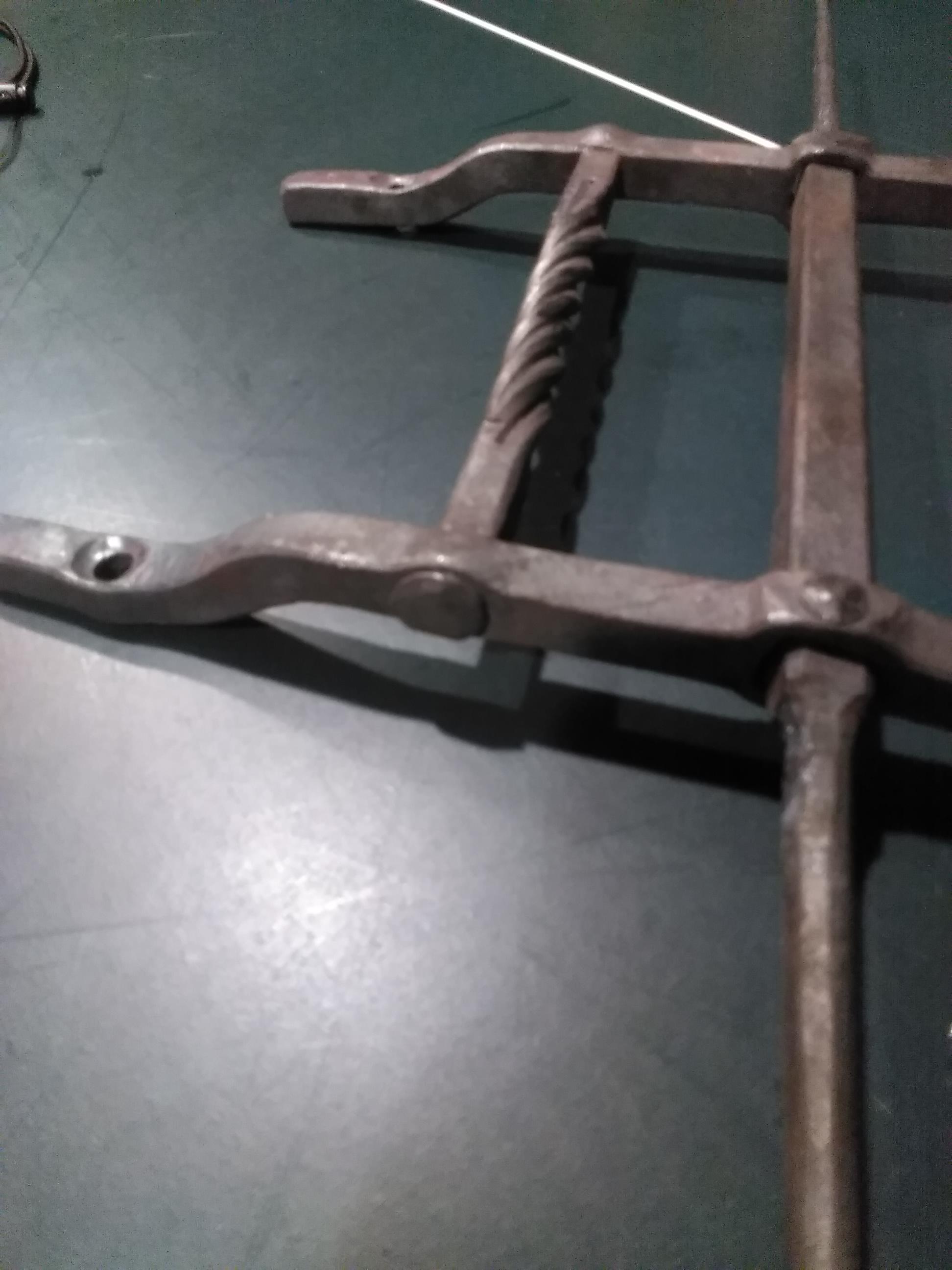

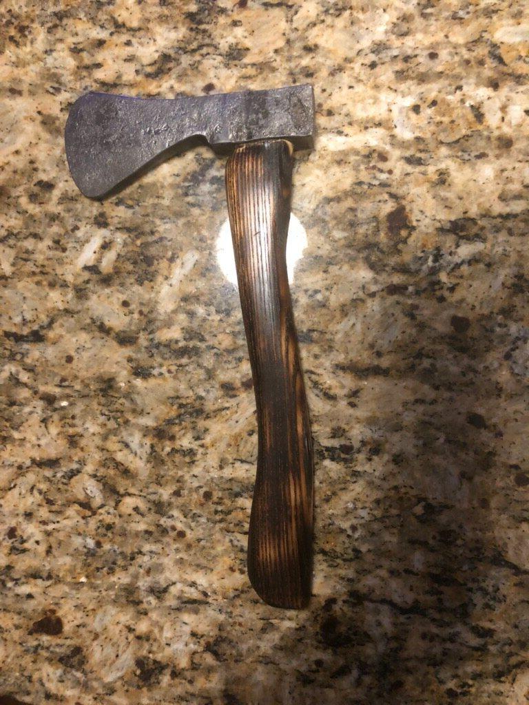

Frazer Posted October 10, 2020 Share Posted October 10, 2020 I decided to make my own thread where I can share some of the stuff I'm making. I just finished my dad's birthday present (only 1.5 weeks late this year). He likes the weapon side of blacksmithing, I prefer making the more practical/artistic side, so this is what I came up with. Initial design sketch My first axe (ok maybe its more of a hatchet..). Mild steel body, slit and drifted eye, HC steel (old tool thrift store file) edge, ash handle. Roughed out frame Finished. The arm under the head of the axe on the right should be sitting further back like it is on the left (I just didn't place it well before taking the picture) and the handle is a little longer than the other. Overall it's not perfect, but I'm happy with the results and I definitely learned a lot in the process. For example, when filing your butchering tool, if the angle is too steep because you are in a hurry to be done with hand filing, you are probably going to need to make the tenon multiple times until you go back and fix the root cause.. I read this week, "Sometimes you spend twice the effort to avoid doing half the work". That pretty much sums it up. The main thing is that it's nice enough for the wall and the sharp bits aren't going to fall out accidentally, and I got to make a bunch of tools in the process so I'm going to call it a success. Link to comment Share on other sites More sharing options...
Latticino Posted October 10, 2020 Share Posted October 10, 2020 Really excellent! I had no idea where you were going with the grate in the sketch. Love it as a display "shelf". Only drawback is lots of cool joints covered by the axes when hung. Link to comment Share on other sites More sharing options...
Frosty Posted October 11, 2020 Share Posted October 11, 2020 Beautiful Frazer! I'll bet your Dad's going to be bragging on his birthday present for as long as he can brag. I have to agree with Latticino, you've covered a lot of really nice work with a pair of nice hatchets. Frosty The Lucky. Link to comment Share on other sites More sharing options...

Frazer Posted October 12, 2020 Author Share Posted October 12, 2020 Thanks everyone! I hear what you're saying about the hatchets covering up some of the cool parts of the stand. I had originally planned for the axes to be crossed in an X across the middle, but ended up mounting them this way so a little less of the center scrolls got covered up. It ended up being somewhat of a balance between a cohesive object where the stand, where the majority of the work went into, and the axes were both done justice. I also wanted the stand to look good as a standalone object in case there ever comes a time where having two rather sharp objects hanging on the wall (kids birthdays and such) they could be taken down and it wouldn't look like there was anything missing. Link to comment Share on other sites More sharing options...

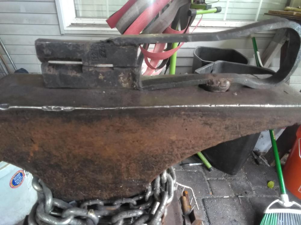

Frazer Posted October 12, 2020 Author Share Posted October 12, 2020 Here are a couple of the tools I made for the project: A spring butchering tool A long axe eye drift. Link to comment Share on other sites More sharing options...

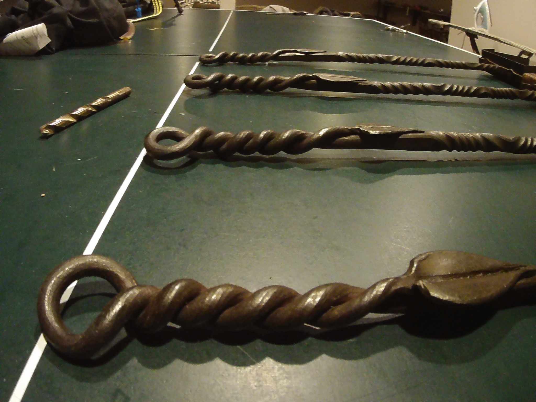

Frazer Posted November 4, 2020 Author Share Posted November 4, 2020 Fire set. The broom certainly could have turned out a lot better if I had a better plan for it going in.. or if I just bought the head . Set includes a poker, shovel, broom and roaster/additional poking tool. They all are ~26" long. The poker was riveted, then forge welded for a seamless rivet head. Apparently I didn't brush the flux off well enough, hence the discoloration by the twist. Link to comment Share on other sites More sharing options...
Frosty Posted November 5, 2020 Share Posted November 5, 2020 Nice looking fire tool set. Brooms are often the hardest thing to get looking pleasant, don't sweat it. You done good. Frosty The Lucky. Link to comment Share on other sites More sharing options...
