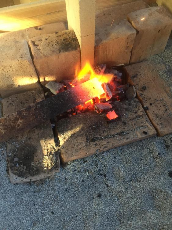

I made fire! :D
First test fire of my forge build today. Just wanted to at least fire it up before winter truly sets in, as I am in an unfinished, uninsulated building. Was able to get an orange heat on a piece of scrap with little effort. (The picture makes it look yellow, but it was really only orange) Whacked it a couple times just for fun. If it stays as warm tomorrow as today, I may actually try and make something out of a rail spike ;)
Already some changes I’ll need to make, will need some notches cut out of the sides for longer stock, a more stable base I think, and rig up a way to mount the air pump I’m using.
Its not much yet, but I’m super happy to finally get to even this point :)
1 hour ago, Irondragon ForgeClay Works said:
It weelll heat. Looks good from here. Probably won't even need the rim extension.
Hahaha! Thank you for that LOL.
Yeah, the box is already actually too deep I think, unless I double up the bricks, so I'm pretty sure the rim extension will not be needed (which is also good because it kinda fell apart when I moved it a while back LOL fortunately the rest of the forge is a bit more sturdy)
1 hour ago, Frazer said:
Very nice! That oughta serve you well. I'm sure you'll tweak it along the way, but that's half the fun.
I look forward to seeing some of the stuff you're making with it!
Thanks Frazer, yeah, I'm looking forward to learning the ins and outs of how it's going to work, and how it's going to work for *me* :)
1 hour ago, Frosty said:
Looks good from here. If at some time you need more depth for a job laying another brick blat on the one opposite the fire back will work a treat.
Nice job. Now we want to see pics of projects. ;)

Uh HUH, that piece of strap stock in the pic looked hot enough to project some hammer blows to. Maybe even bending the end 90* to make a brick scraper.
Rather than putting more bricks under it maybe more dirt? If it's flimsy how about a couple 2" x 4"s and a piece of plywood or 1 x boards and elevate the box. It'd: raise the fire, stiffen up the box and give you a 1 1/2" deep space you could use to keep: stock, poker, tongs, etc. handy at the forge.
Hmmm?
It's just a thought, the voices keep giving me ideas.
I didn't see a picture of the abuse you inflicted on that poor innocent piece of HOT steel, if we can't see it it didn't happen.

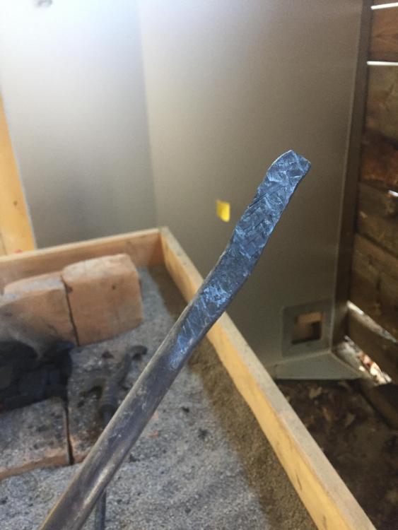

And as requested some pictures of yesterday’s inaugural metal whacking

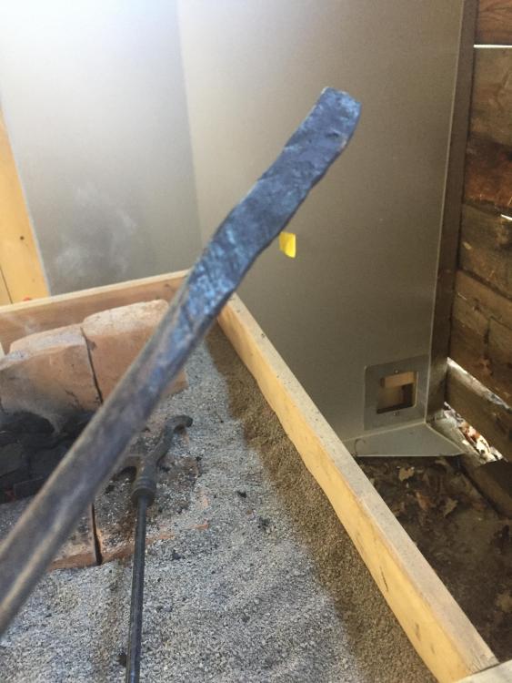

And here are some from today’s attempt. Wanted to play with a railway spike, but I do not have the proper tongs yet so switched to a 1/4 rod of mild steel instead. It was a bit awkward as it’s five feet long, but managed to hammer out what will become a little rake for the fire.
Need to dress my hammers still, they leave al kinds of marks. Had better results with the heavier 3lbs hammer but it’s a bit heavy.
After a couple hours, I have to say, It’s certainly not as easy as it looks! I expected flattening it to be a little faster than it was (though I was using a lighter hammer at that point) but the bend went even easier than I anticipated! Tried to even up the edges but ended up putting a bit of a twist in the flat part that was difficult to get out again.
All of it was made more difficult by the unwieldy length of my stock, and the awkwardness of holding it in the fire while pumping the air pump that’s not affixed to anything. All things that can be improved.
Overall not bad for my first go, but lots lots lots to learn.
Ayup, we believe! THAT'S been heated and beated! Congratulations, a forge tool. Pro tip: If anyone remarks on or even notices the marks, be sure to tell them how many YEARS it was before you could forge a texture like that. It's true! Any new project took (your age in years) to get that good.

Sounds like you need a hacksaw and a vise. Hacksaw to trim the stock to working size and a vise to help remove twists.   I once made a nice little 1/4" sq stock fire rake for my travelling forge, until my wife decided that it was perfect for her to work the house's wood stove...I generally make then so I can hang them from the rim of the forge to keep them handy!
Part of it being harder is the very light anvil, an 80# block of steel will work a lot better than a small chunk of rail, You have a nice anvil stand that will work with a larger improvised anvil!

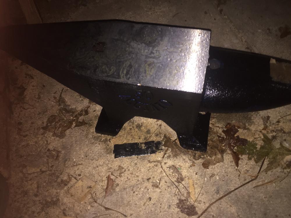

I decided to pick up a 110 LBS cast steel ‘beginner’ anvil for a couple hundred bucks. It will give me more mass to work on, a hardie hole and pritchell hole, and a horn, so I figured it was worth it considering the price of anvils around here. The face seems pretty consistent, only one side next to the hardie hole was a bit ‘dead-er’ than the rest, and the holes are both fairly clean and should only need minor cleaning. Going to leave everything else as is until I work on it and learn what I’m doing a bit.
Right now it’s just sitting in the floor of my shop until I either swap it out for my railroad track on my existing stand or build another stand for it. Sprayed it liberally with WD40 to protect it since my shop is not fully enclosed, hopefully that will do the trick. Want to try and get out there this weekend, but also have other chores and commitments this weekend :/
here’s a couple pics, should suit me for a good while at least
theres some sort of oil/wax on the surface from packing/shipping - all those marks are not surface dings or anything :)
