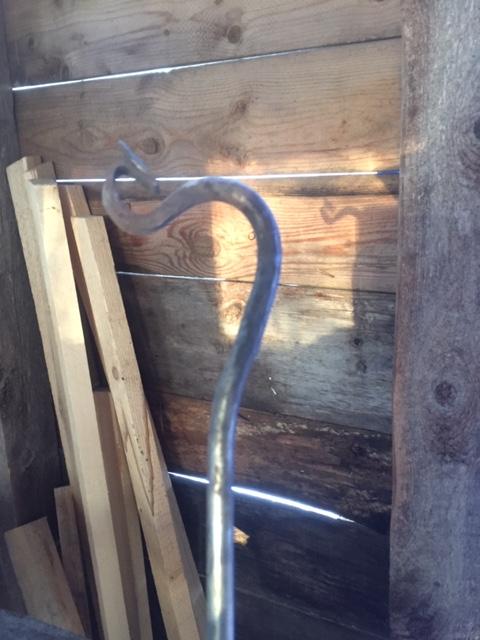

  5. *adds 'pig tail' to mental lexicon* I actually did do the pig tail first, and then discovered the crack, before I moved on to the main curve. I did not dip in water at all though (I actually don't yet have a slack tub) Stuff was cooling off very fast, and I think I pushed it one (or two) many hits past temp - unless there's something else that you can think of?
  6. Today I made a hook! Unfortunately, it developed a crack just above the tip curl, must've hit it too cold I guess. But I finished it anyway, since it's all a learning opportunity.
