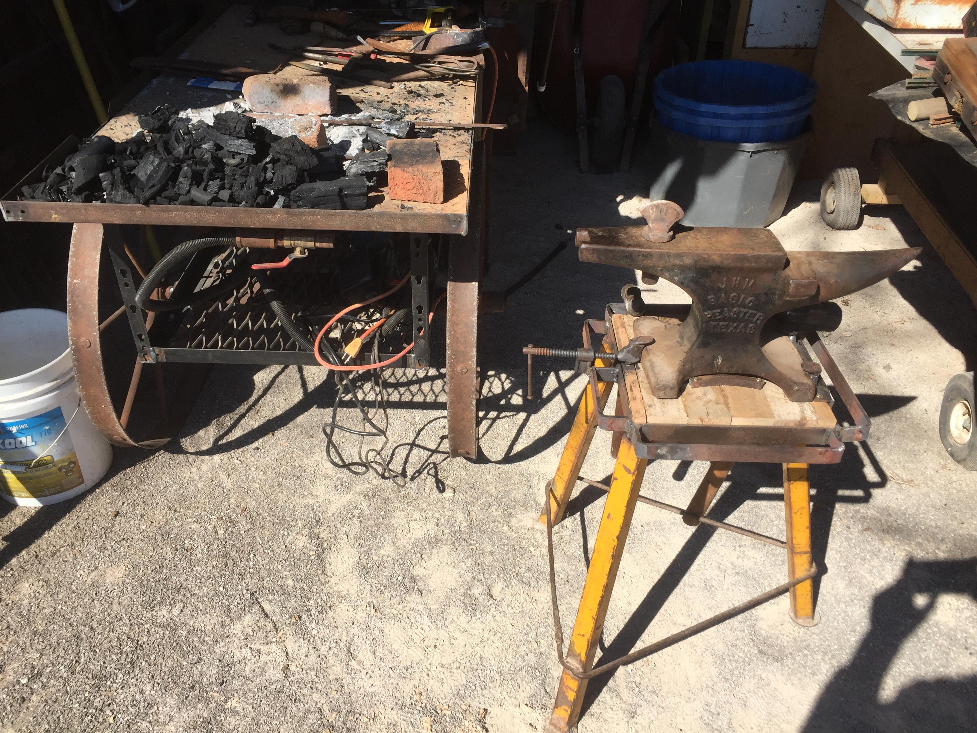

Charles R. Stevens Posted March 19, 2019 Share Posted March 19, 2019 Rebuilt my portable anvil stand. Lowered it two inches (buy replacing the block with one rabeted to fit lower) changed the tool loops for racks and rebuilt the clamps Quote Link to comment Share on other sites More sharing options...
jlpservicesinc Posted March 19, 2019 Share Posted March 19, 2019 Charles, how is the new forge working out? Love the stand.. Why lower? and how much compared to the traditional knuckle height.. Just curious nothing more.. Quote Link to comment Share on other sites More sharing options...
Charles R. Stevens Posted March 19, 2019 Share Posted March 19, 2019 I lowered it from wrist to fist high. That is 32 from 34”. This gives me first knuckle when wearing my riding boots. i bent the racks with the vise and heated it wit the forge. It’s a fuel hog compared to my JABOD experiments but it taught me what I needed to know to build a side blast fire pot. 6x11”, 3 1/2” to the top of the tuyere and 6” deep over all. 7/8” ID (3/4” schedule 40 pipe) tueyer. The 70# anvil is easer to tote around than the 120# one. Quote Link to comment Share on other sites More sharing options...
jlpservicesinc Posted March 19, 2019 Share Posted March 19, 2019 That is cool.. Thanks for the info.. For shoeing I use a stall jack that is maybe 36" tall.. For real forging it's only 31.. I find this give me full range of motion with the hammer... I'm a little curiours of your firepot design? You run coal or charcoal? I thought I saw charcoal in another picture.. Quote Link to comment Share on other sites More sharing options...

Charles R. Stevens Posted March 20, 2019 Share Posted March 20, 2019 The pot is set up for both coal and charcoal. Unlike bottom blast forges side blast forges with 3/4-1” tuyere burn either fuel equally well. I rarely carry a “real anvil” on the truck, having a track head welded on a piece of 2” shafting that handles 90% of what one needs an anvil for. Quote Link to comment Share on other sites More sharing options...
jlpservicesinc Posted March 21, 2019 Share Posted March 21, 2019 I'm with you.. I just prefer a charcoal forge side blast with the sides more like a Japanese side blast or more in line with the ability to push something through and build up depth via captured walls.. Was curious since you actually have a pot.. Nice.. so do you like the anvil lowered better? To soon to tell? Quote Link to comment Share on other sites More sharing options...
