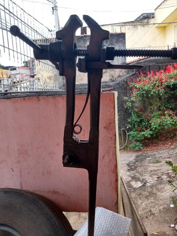

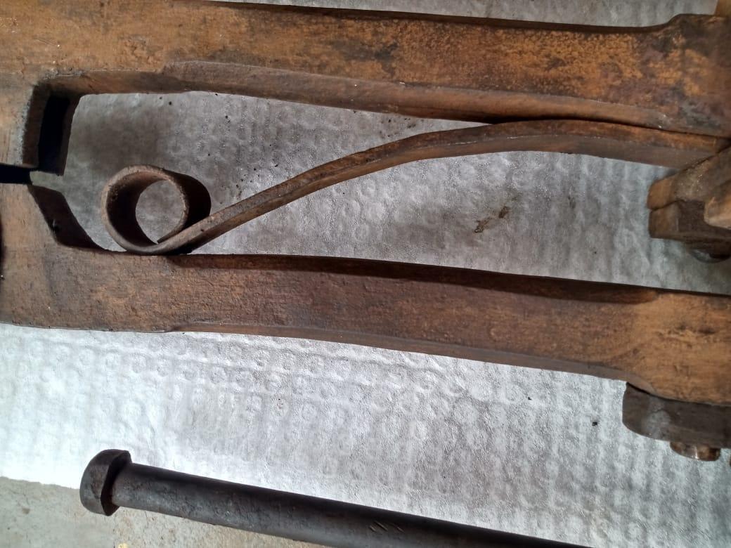

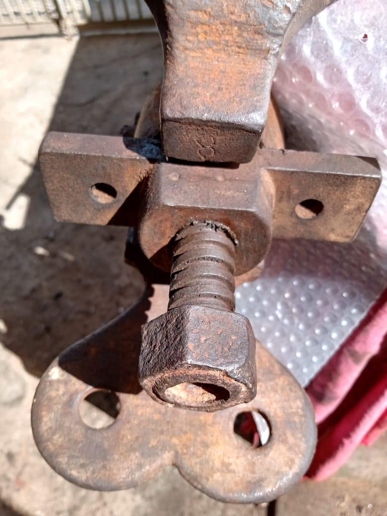

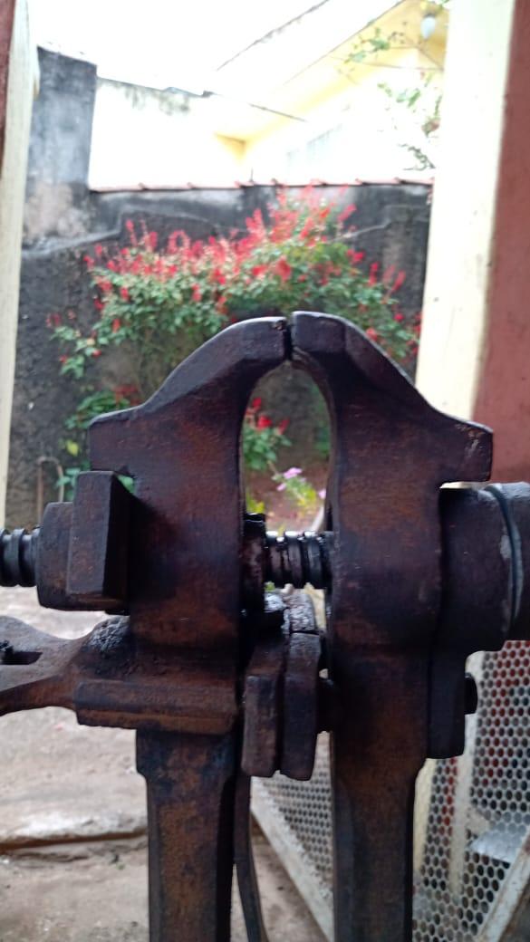

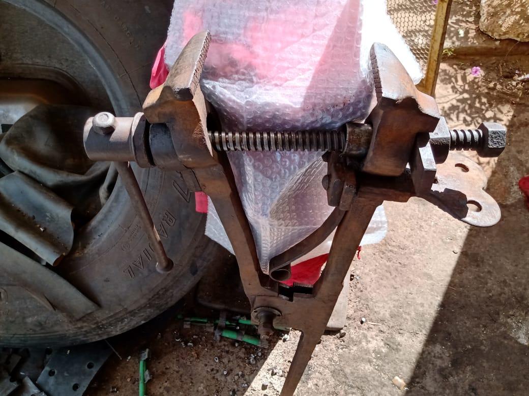

Found cheap leg vise. Worth buying?
Hey all!
I found this vise for about $80 (converting BRL to USD). It's a bit old, but looks fine, and the owner says it's "working perfectly".
I still have to go over there and check it in person, but do you guys think this looks like a good opportunity? Also, if I buy it, what can I already do to make it look better and last longer?
Cheers!

The screw is in good shape, which is the most important thing. It's clearly a replacement, but that shouldn't necessarily dissuade you from purchasing it.
Is that a comparable price to others in your area?  Just about six months ago 60-80 USD was about the going rate here. They jumped in price by double since then. Unless they usually are cheaper than that I don't see any obvious red flags.

I'd not know that the screw is a replacement. I still want a video of it working, though. Will share if I can get one.

No, this is way cheaper, actually. One thing you've gotta watch is that Brazil has no serious blacksmithing tradition, so this kind of tool is quite rare over here.
For instance, if I translate "post vise" or "leg vise" to pt-BR, I'd not find anything. I accidentally found this one and some other ones listed as "blacksmith vise" .
Even here I have to use all 3 terms when searching---as well as using the British spelling of "vice"!
It is clear that the screw is a replacement and way longer than necessary.  I would want to see how the fin/key to prevent rotation of the screwbox was handled; but even then it looks like an easy item to modify if necessary as they have the tube going through the yoke!
A working postvise is more important to smithing than a commercially made anvil in my opinion.  If that's cheap I'd grab it quick.  Here in the USA good deals on blacksmithing equipment have a lifespan of minutes to hours and by the time someone asks about it and gets an answer the original deal is gone!
Oh, you've seen the other post I made on those anvils. I'm getting anxious right now... hahahah
The problem I'm facing is the hard one: money. Buying one of those anvils means a bit more than half my monthly payment.
I was extremely lucky to tool up in an area of the USA that was heavily settled in the 1800's and with a lot of industry, both light and heavy. So it was awash with smithing equipment cheap; so much so that I had to put a limit on how much I would own and sell off a piece if I upgraded to a better one.   Of course I then had to move it 1500 miles when I switched jobs. I also did this on an "allowance".  At that time I got US$20 a week to spend on all my "vices" like: vises, coal, tongs, beer, books, scrap metal, ...
If it was my choice; I would go with the postvise as the improvised anvil thread lists a LOT of ways to get forging without a commercial made anvil; but you may notice that there doesn't seem to be the same for "improvised postvises".  I would also trim that screw shorter so it would work for the maximum useful jaw opening and not more.

Since you said it's substantially cheaper I hope you've already bought it. One thing I've learned the hard way is that good deals won't wait for you. I hope you get it if you haven't already done so.
Pnut
So 4" wide jaws----Jaw width is how we usually rate the size of a postvise + whether it is a light vise or a heavy one, I use the term "gracile" and "robustus".   Gracile vises are a lot easier to travel with; robustus vise can withstand a lot more heavy pounding.  In my smithy I try to have both types---the 4" light vise is sure a lot faster and easier to close using my knee on the handle than the 6.5" vise!

Jaw width is 100mm == 10 cm and at 2.54 cm/inch = 4" within blacksmithing tolerances.
200mm is the throw---how far it will open and so about 8".
Well within tolerance, You can dress them when you own it, or make jaw covers, or just use them as they are.
Note: since the moving leg describes and arc the jaws often only touch along the top when closed and will be parallel somewhere in the "using arc".  Don't dress them parallel when closed except if you will be working a lot of thin sheetmetal.
Looks well worth the money to  me.
If you want to pretty it up a wire brush and the finish of your choice. I painted mine my shop colors, green and gold but some folk wipe them with boiled linseed oil or similar. I've had good luck with Trewax a caruba paste wax ad apply it to steel about fresh cup of coffee hot. The Trewax is very fluid and penetrating when melted and when cool is very hard.
