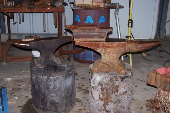

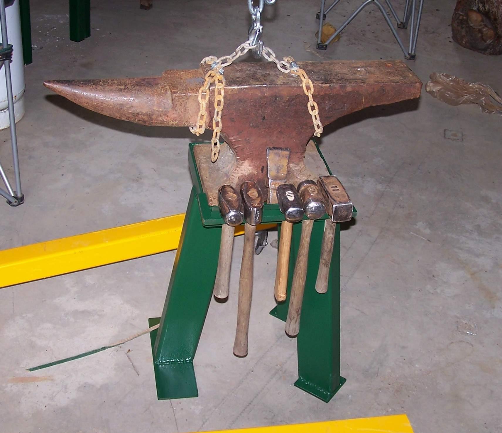

Frosty Posted May 16, 2020 Share Posted May 16, 2020 The first picture is from when the Trewax was only maybe 10 years old on the Soderfors it's the one on the left. I took this pic just after I got the Trenton home, the large one on the right. The little one is the rail anvil I made years before I scored my Soderfors. The second pic is the Sodorfors on the steel tripod stand I built to make it easier to move and damp the extremely loud ring. It looks really weathered but the Trewax is still going strong, Condensation is extreme in my shop in the spring if snow is bad there's even water on the floor. Using it has shined it up and gone a long way to cleaning the rusty off the black carnuba. It's still getting close to needing refinishing. The Trenton has a steel tripod stand now for the same reasons as the Soderfors, I'll probably paint it my shop colors. Maybe paint them both to match. Frosty The Lucky. Link to comment Share on other sites More sharing options...
HumanAfterAll Posted May 16, 2020 Author Share Posted May 16, 2020 (edited) 13 hours ago, notownkid said: . As we were told in the Army "He who Hesitates is Lost". Note taken. Thanks! Frosty, How many years are the photos apart? And maybe I missed something, but isn't it the Trenton on the green tripod? Edited May 17, 2020 by Mod30 Trim quote & remove @tag Link to comment Share on other sites More sharing options...
Frosty Posted May 17, 2020 Share Posted May 17, 2020 DANG, you're right! That is the Trenton when it's stand was new! I must've been half asleep when I attached those pics. Every time my computer updates the software it scrambles things, I have to search to find pictures and sometimes entire files get displaced. I literally just came in from the shop and that is definitely NOT the Soderfors on the tripod in this pic. I can NOT believe I was that asleep. The spruce block stand under the Soderfors was rotting from the bottom, you can see bits of rotted wood on the floor around it, it got a tripod first. That pic had to have been from around 2007 when the shop was new. I mortised the Soderfors into the spruce block in 1980-81. I trewaxed it in the mid late 70s right after getting it. The best I can piece together in my dented head, the Soderfors had been wearing the Treewax you see in the pic about 27-30 years at that time. I'll have to search my files when I'm more rested, I have more current pics. Frosty The Lucky. Link to comment Share on other sites More sharing options...

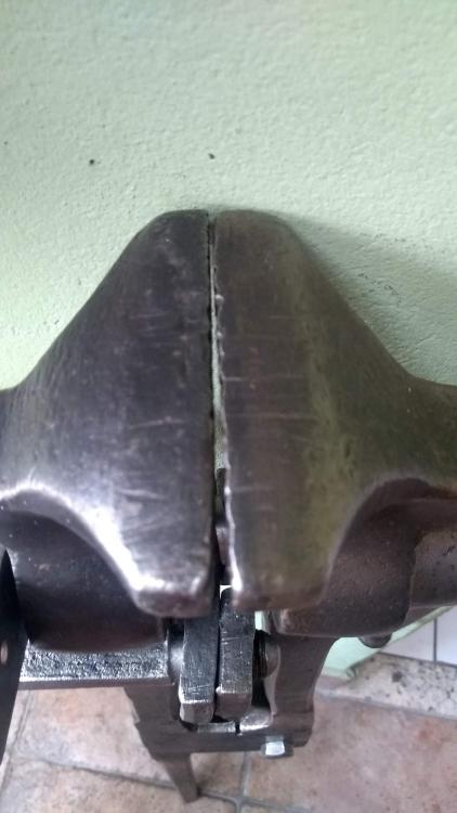

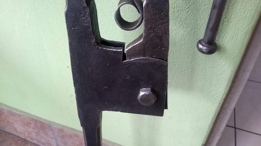

HumanAfterAll Posted May 17, 2020 Author Share Posted May 17, 2020 27 minutes ago, Frosty said: I'll have to search my files when I'm more rested, I have more current pics. That's quite alright. Thanks for sharing and please, do get some rest! =) Oh, the vice is really greasy. All over it. You know, when grease is old enough to not function as grease but still steins everything around it? Should I remove it before wire brushing it? Also, if you need any sort of help with computers, feel free reach out. I work all day long with them! 21 minutes ago, Irondragon Forge & Clay said: Or as my late FINL said "If you snooze, you lose." I tried looking for the definition of FINL and got some interesting results, which I believe are wrong: Cheers all! Link to comment Share on other sites More sharing options...

Frosty Posted May 17, 2020 Share Posted May 17, 2020 1 hour ago, HumanAfterAll said: Oh, the vice is really greasy. All over it. You know, when grease is old enough to not function as grease but still steins everything around it? Should I remove it before wire brushing it? That kind of grease is the norm for old blacksmithing equipment. Both the vises I bought worked pretty well but the screw and box were caked pretty solid with old grease. I loosened it by soaking it a couple days with regular applications of spray degreaser. Then I took them to the car wash and took the high pressure hot water spray to them. I don't know if you'd have to clean out the old grease but if you take a power brush to something greasy it will sling old grease on everything. Frosty The Lucky. Link to comment Share on other sites More sharing options...
Donal Harris Posted May 17, 2020 Share Posted May 17, 2020 It is redundant to say, but Frosty is certainly right about the dangers associated with using a powered wire brush. When cleaning my vice after bringing it home I ended up wishing I had been wearing a leather apron. Those bristles may as well been needles as easily as they buried themselves in my abdomen and thighs. If you go without PPE normally, you will not want to do so when using a wire cup brush. The worst part happened after I had been using the brush for an hour or so. I got careless and caught my left hand with the brush when it kicked back. That hurt so badly I couldn’t look at my hand for a bit. I was sure I was going to see a broken, mangled mess. Link to comment Share on other sites More sharing options...
Marc1 Posted May 17, 2020 Share Posted May 17, 2020 Use a polisher not a grinder for steel brushing. The speed is too high and the brush disintegrates. Link to comment Share on other sites More sharing options...
pnut Posted May 17, 2020 Share Posted May 17, 2020 I use my drill with a cup brush. Nice and slow and your completely out of the plane of rotation. Pnut Link to comment Share on other sites More sharing options...
HumanAfterAll Posted May 17, 2020 Author Share Posted May 17, 2020 13 hours ago, Frosty said: I don't know if you'd have to clean out the old grease but if you take a power brush to something greasy it will sling old grease on everything. I brushed it a little bit with the cup brush and it seems like I do not need to clean it before. Thanks! 3 hours ago, Marc1 said: Use a polisher not a grinder for steel brushing. The speed is too high and the brush disintegrates. I don't own one, unfortunately. I'll go with a cup for my drill, like @pnut. Thanks for the advice, though. Link to comment Share on other sites More sharing options...
Frosty Posted May 17, 2020 Share Posted May 17, 2020 4 hours ago, Marc1 said: Use a polisher not a grinder for steel brushing. The speed is too high and the brush disintegrates. This is would be a good reason not to use cheap, dollar / closeout store wire brushes. I've been using wire brushes, cup and straight, in right angle disk grinders 4 1/2" to 9" for 50 years and while they all throw bristles I've never seen nor heard of one "disintegrating." Except this one "warning". They ARE extremely dangerous yes, no question but this kind of linear extrapolation doesn't help. When people discover wire brushes don't disintegrate they're more likely to disregard legitimate warnings. Frosty The Lucky. Link to comment Share on other sites More sharing options...
