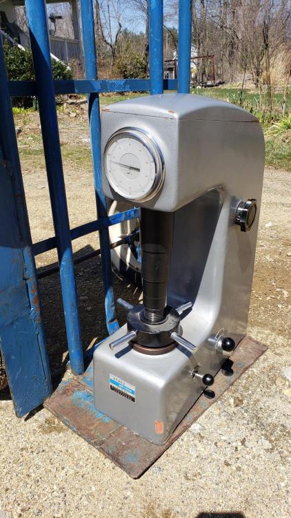

Rockwell Hardness Tester. Model HR-150A
WOW!  What a purchase!
Hardness tester.  Used by bladesmiths to see if their heat treat is right.  (By other people too who are making items that need to have certain properties.)
Pretty expensive piece of equipment if purchased new.  I would think every serious bladesmith would want one in their shop.  Probably the majority don't have one, but if you wanted to sell a blade and "claim" a Rockwell hardness number, I'd think you would want to be able to verify your claim.
A less expensive (if less accurate) method is to use a set of hardness-testing files, but a proper Rockwell tester is really the most accurate way to go.
I know a lot of bladesmiths who provide a sheet of information when they sell a blade.  It contains method of making the blade, (forging/removal) type of material by name, Rockwell hardness and handle materials.  Those that do that typically use testing equipment such as Jennifer just purchased.

So one of my buddies who ran a machine shop called me because I had mentioned to him when I was there about his Rockwell hardness tester..
This was like 3 years ago..  about 2 years ago he said he was selling off his shop and was I interested in the tester.. I jumped at it and said.. "Of course"..
That was that..  We never talked about it again..  Back in December we connected and he was like.. Hey, you still want this thing, It's the last thing int he shop and it's gotta move out.
So, we established a price and I bought it with the word that he had to hold it at his place for a few more months.. Well here we are and now I own a Rockwell tester.
This model will do A, B and C scale and work on all metals even case hardened ones..   (this might be interesting from a Damascus/layered billet stand point).
It is a model HR-150A and has all the parts with it and original instruction sheet.
I bought this to do several different things in the shop..  1,  is to verify the Hardness of items for testing purposes..   2, to show students the results of hardening and tempering and how this effects hardness.. 3,  to put Text book, information into real life application and to understand it vs  the "I saw so and so, do such and such and do it that way."..
Again, this is a tool for learning..
