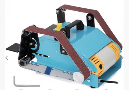

Neddy Posted October 9, 2020 Share Posted October 9, 2020 Hi all. I’ve appreciate reading the posts in this thread. For a while now i’ve been using a Ryobi belt and disc sander for stock reduction on steel but needless to say it’s not ideal - too much bulky metal housing making it’s difficult to get the steel in nice and close to the belt. so I’m looking at cheap belt grinders to get me started - anyone know if something like this would do for a while? Remove link to commercial site. Im not a pro nor and I’m on a budget so not looking for pro equipment at this stage. Alternatively if this is just cheap junk can you please suggest a suitable and affordable belt grinder for a relative beginner. One that doesn’t need someone with an engineering degree to set it up. Thank you all for your time m and kind regards Neddy Quote Link to comment Share on other sites More sharing options...
swedefiddle Posted October 9, 2020 Share Posted October 9, 2020 Good Morning, Good, Cheap, Fast. Pick 2!! Neil Quote Link to comment Share on other sites More sharing options...
ThomasPowers Posted October 9, 2020 Share Posted October 9, 2020 Do the slots on that motor allow grit to get into the innards? I'd consider anything not using a TEFC motor a toy. Also the big cost of a grinder over time is the abrasives. Does that model use easily sourced belts? Paying extra for odd sized belts builds up fast, especially for relatively small ones that wear fast. Quote Link to comment Share on other sites More sharing options...
Neddy Posted October 10, 2020 Share Posted October 10, 2020 Hi all. Thanks for the responses. (I got warned for that post as I didn’t realise I couldn’t post a link in it. I tried posting a pic of the unit but it didn’t let me so...) this is the description ... 950w Bench Belt Sander Grinding Machine Double Axis Variable Speed 40x680mm that's definitely a fair point about the odd sized belts and how difficult or expensive it may be to replace them. I’ll do some googling on that point. .. Ah this time it’s let me post a pic of it. Let me know your thoughts on if it would work for a relative beginner. thanks and kind regards neddy Quote Link to comment Share on other sites More sharing options...
pnut Posted October 10, 2020 Share Posted October 10, 2020 Like Thomas said, I would definitely be worried about filings destroying the motor pretty quickly. Pnut Quote Link to comment Share on other sites More sharing options...
Latticino Posted October 10, 2020 Share Posted October 10, 2020 Other potential drawbacks as seen from photo: Belt tension system missing, or difficult to use Belt tracking micro adjustment missing. Idler wheels are stacks of ball bearings? General flimsy construction Drive wheel diameter (what is belt SFPM?) I'd take a Grizzly, or homebuilt over that any day. Quote Link to comment Share on other sites More sharing options...
Neddy Posted October 12, 2020 Share Posted October 12, 2020 Thanks everyone for your responses regarding this! I can definitely see all your points/concerns with this item so i’ll keep looking. Quote Link to comment Share on other sites More sharing options...
Kozzy Posted October 13, 2020 Share Posted October 13, 2020 Wow--that grinder has a lot of potential expletives one could attached to it. Its chief benefit would be in the health category--because you should get plenty of exercise in your quest to run away. There is no great solution that is also "cheap". There are some passable solutions--for instance many get good results using a flat disk in an angle grinder if they work carefully. There are also chinese 1 x 30 machines that are in the $ 120 USD range which, though underpowered and a bit frustrating, can get the job done if you don't push them too hard. (put your money into only high-quality abrasive belts/discs--going with the best there is where things pay off well). One thing to keep in mind though: It's expensive to get into quality but the value remains--quality can be resold in a short period to recover the majority of the purchase cost. Junk will only be worth junk prices later if anything at all. You are basically putting money into the "bank of iron" for a while. That means if one can scrounge a bit more money for quality to begin with, it isn't really a loss to your wallet, it's just banked for a rainy day or later upgrade. Not everyone can weasel the cash up front for a larger purchase but it will pay back better over time so should at least be considered among the possibilities. Quote Link to comment Share on other sites More sharing options...
