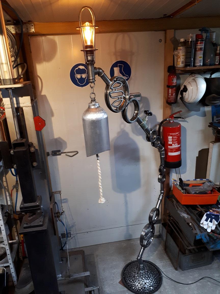

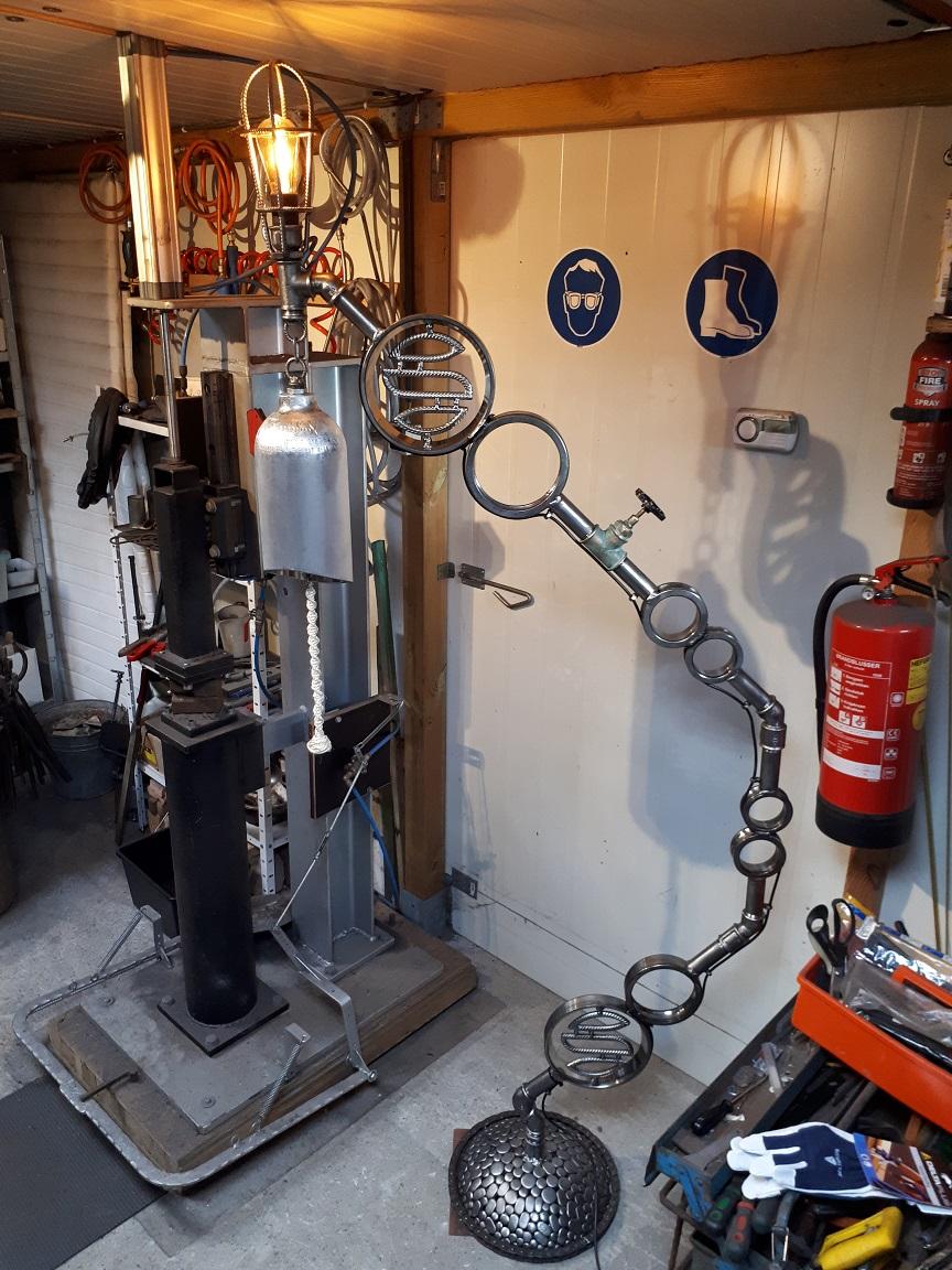

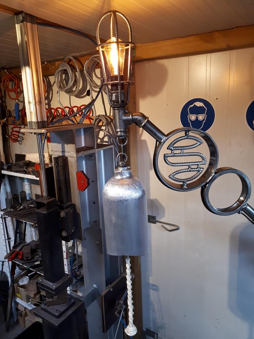

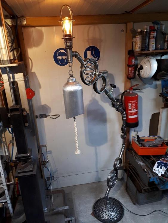

Hans Richter Posted March 2, 2020 Author Share Posted March 2, 2020 Aric, thank you for your compliment, as far as imagination is concerned, let me tell you that 8.5% Belgian beer and my stock of scotch whiskey are very helpful in the realization of such a project. Anyway, just before the Christmas holidays I started with the 'Shark Sub 1.0' with multiple attacks of 'creative constipation'. In the meantime, a commissioning work has been completed, 'The Eight B (e/a)ll lamp' a quickie of 3 days for a customer who needed a bell at his counter for waiting customers and suppliers who need attention. Everything brushed and deburred again. Including the processing of his company logo in the work. The challenge here were the welds, given that mild steel (tubes & fittings) and the ball bearing rings (CrV) had to be welded together. If these connections are welded with 'under matching' welding additive material (S355 MIG weldings) there is a risk of brittle fracture. Not important for small work but of great importance for load-bearing constructions. I used the good old stick welder and AISI 309 electrodes for these welds Link to comment Share on other sites More sharing options...

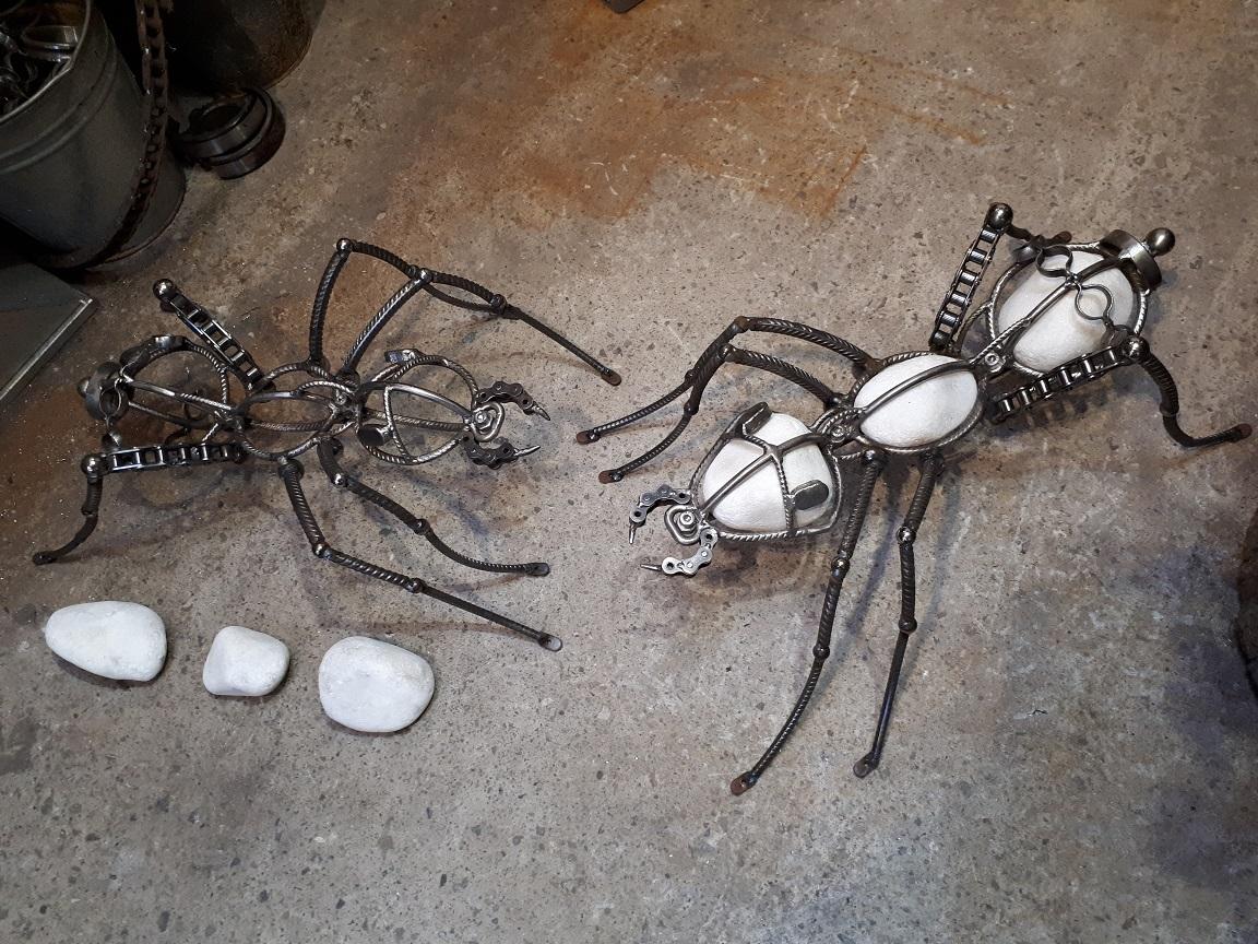

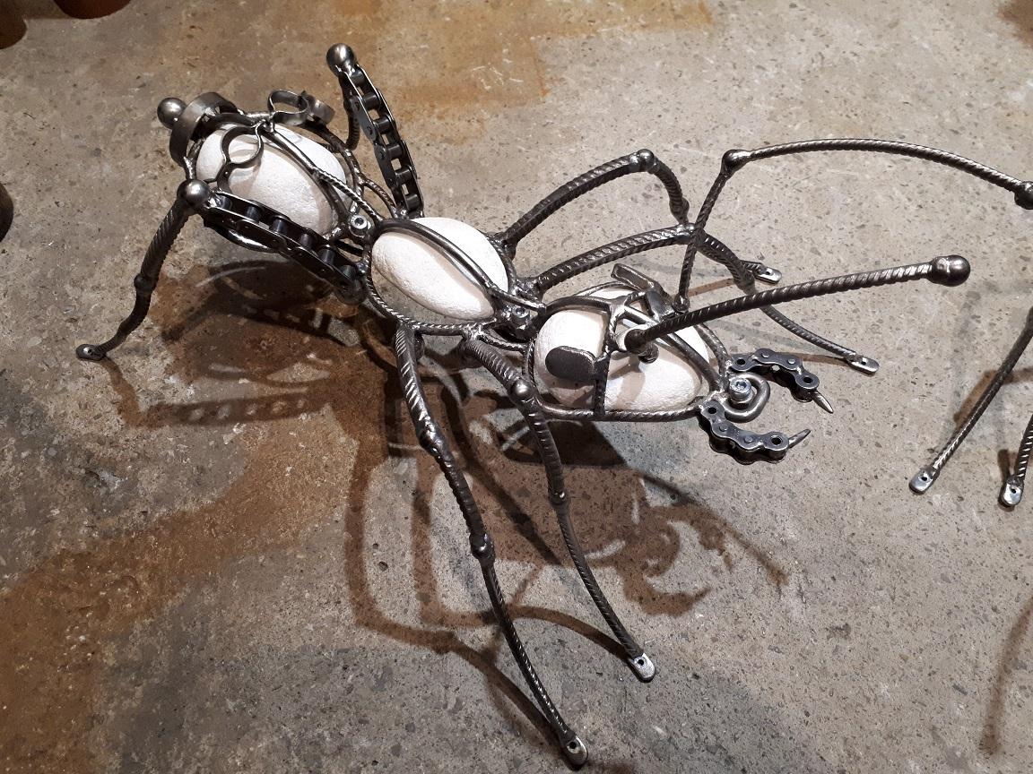

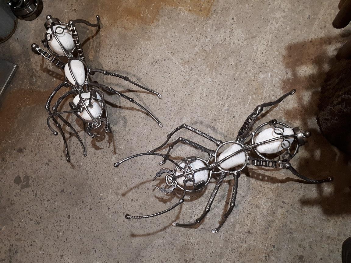

Hans Richter Posted March 23, 2020 Author Share Posted March 23, 2020 Don't really stay in my room, but do stay in my work shop (and solitary). Et voilà, there they are, the hybrid "Marble Ants" a mix of stone and scrap. Almost ready to the varnish layer and a decent pedestal ("darn" the hardware store is closed). Hope that this time of imprisonment is over soon. Until then, like all other creatives, I have been handed over to our dear lord and the Belgian health system. Pray for all of you, and our family that even this chalice (such as SARS, MadCow-desice, AIDS, etc ...) will pass us by. Extremely happy to have the activities in the studio as an outlet, because what is happening is hurting my nerves and peace of mind. Sleep restlessly, and listen to every cough and sneeze in our house. Above all, stay healthy, and be welcome @ F & F Tumulus when the storm dies down. Cheers, Hans Link to comment Share on other sites More sharing options...
jmccustomknives Posted March 23, 2020 Share Posted March 23, 2020 Cool! Link to comment Share on other sites More sharing options...
ThomasPowers Posted March 23, 2020 Share Posted March 23, 2020 Where's the picnic? With ants that size it must be a *big* one! Link to comment Share on other sites More sharing options...
Shabumi Posted March 24, 2020 Share Posted March 24, 2020 Those are really nice Hans. The rebar texture looks almost like the hair on the ants legs Link to comment Share on other sites More sharing options...

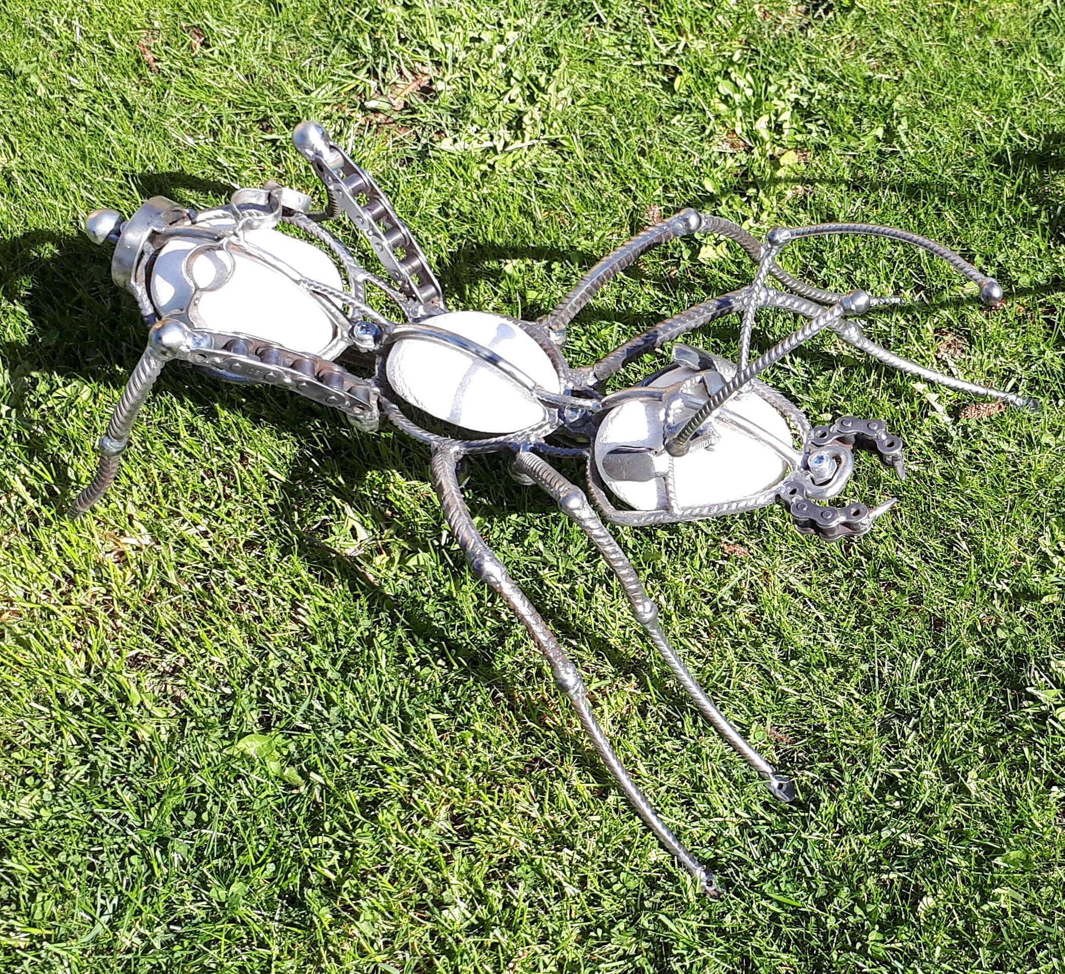

Hans Richter Posted March 24, 2020 Author Share Posted March 24, 2020 Ants sunbathing Link to comment Share on other sites More sharing options...
Frosty Posted March 24, 2020 Share Posted March 24, 2020 Ants sunbathing eh? Is that a the nude lawn or did they sneak onto a public lawn? Might not make sense as a joke in Belgium but this side of the ocean the only nude beaches tend to be private and out of sight. If you want to do any nude sunbathing on the beach you have to sneak it till the authorities tell you to get dressed or haul you in. If I tried they'd probably beat me with sticks. Nice pieces Hans. I love scrap art, wish I were better at it. Frosty The Lucky. Link to comment Share on other sites More sharing options...

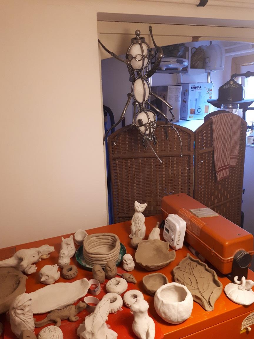

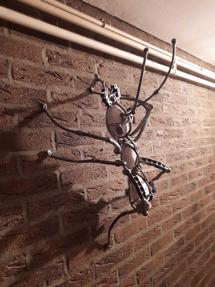

Hans Richter Posted March 27, 2020 Author Share Posted March 27, 2020 NO space on the floor anymore because of overcrowding sculptures there and luck of expositions at this moment. So I placed the little crawlers on the walls. To protect them from oxidation (in the wet outside atmosphere) and give them a place at our home. As you can see on the pictures there is also a new stock for Raku-firing of Lisa’s owls and other primitive clay ready to dry for the next biscuit-firing. Link to comment Share on other sites More sharing options...

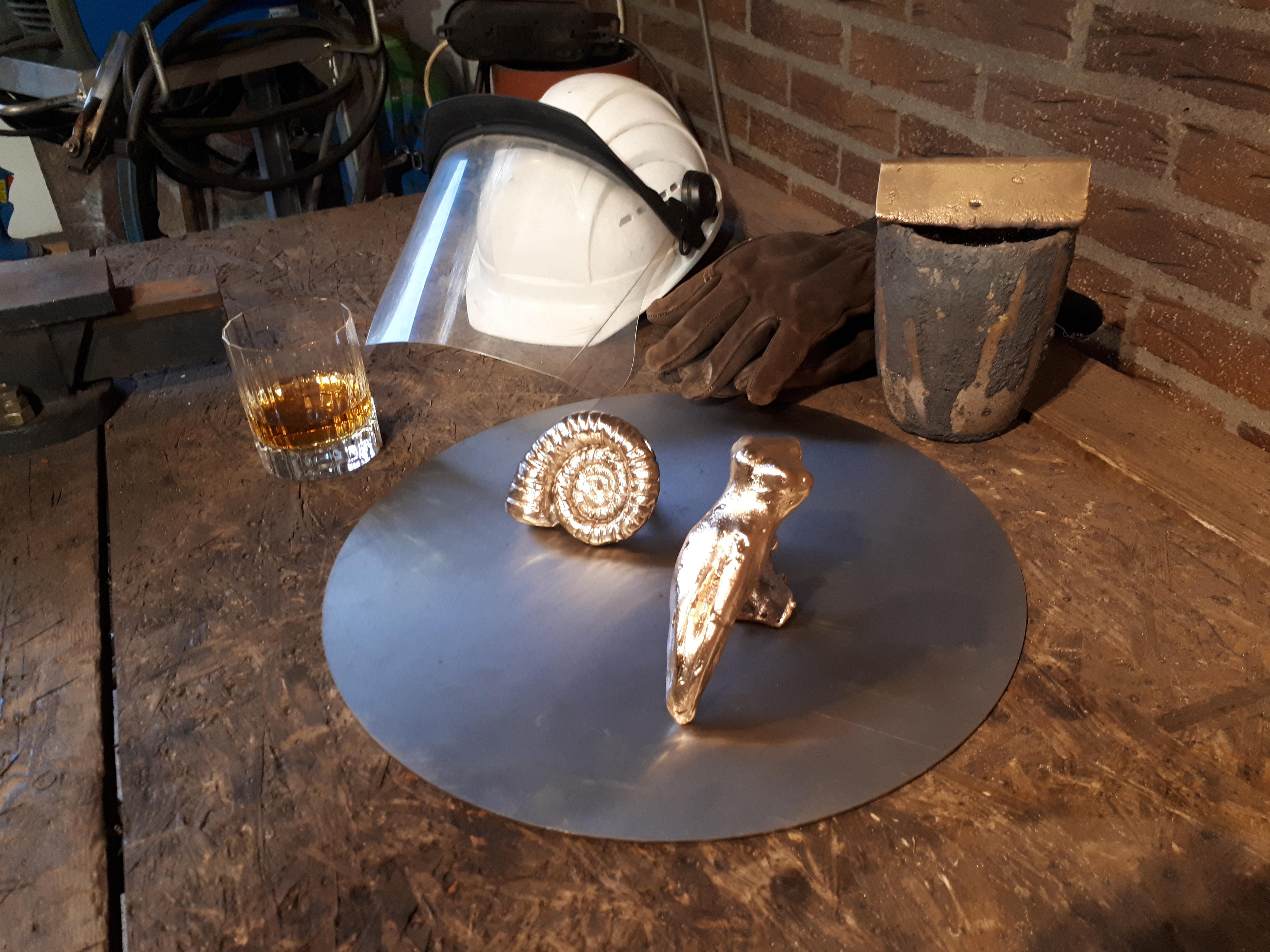

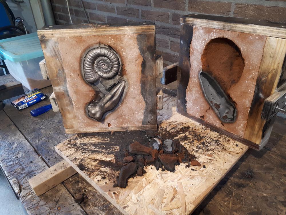

Hans Richter Posted April 2, 2020 Author Share Posted April 2, 2020 Keep on rolling, ............... Another bronze cast, this time a female torso and a the next ammonite. Nice finish but like me with several imperfections. Tomorrow I will take care of the worn out Raku-furnace to prepare him for the next firing after Lisa and Diana made up a lot of new biscuit Link to comment Share on other sites More sharing options...

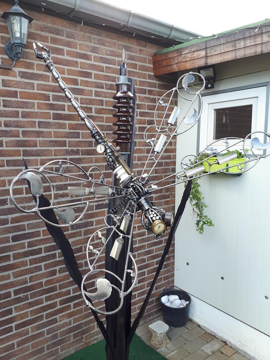

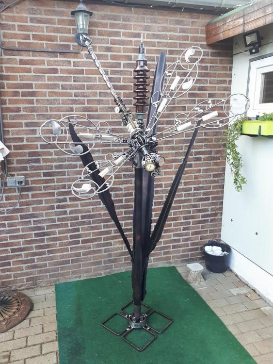

Hans Richter Posted May 11, 2020 Author Share Posted May 11, 2020 Hello Ausfire, thank you very much for the kindly response, you can hardly imagine what this means for me. After all, you are the real teacher and I may be a reasonable apprentice. As for the Anglerfish, the Cassowary and the Mosquito, these are spin-offs of works where I got my inspiration from highly regarded artist colleagues, and tried to interpret them in my own interpretations of steam-, diesel-, and atomic punk version 2.0. As for the shark, dragonfly, fire ant and owl, these are self-contained sculptures that were created solely on the basis of macro photos and entirely made from my gut feeling. Now I'm waiting for better times to exhibit the entire animal collection and sell some of the work. Since all works are finished in such a way that they are suitable for body contact, they were therefore very laborious and took a lot of time and work. A curse and blessing at the same time because they can be placed both indoors and outdoors and the public to paying customers here in Belgium is quite thin. Have seen a lot of nice new inspirations from you again (bullheads, business card holders etc.) and do not get exhausted to indicate my own interpretation here as well. You will continue to follow closely and are grateful for all the inspiration you give us (the IFI community). Link to comment Share on other sites More sharing options...
