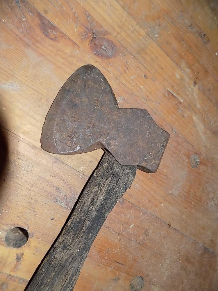

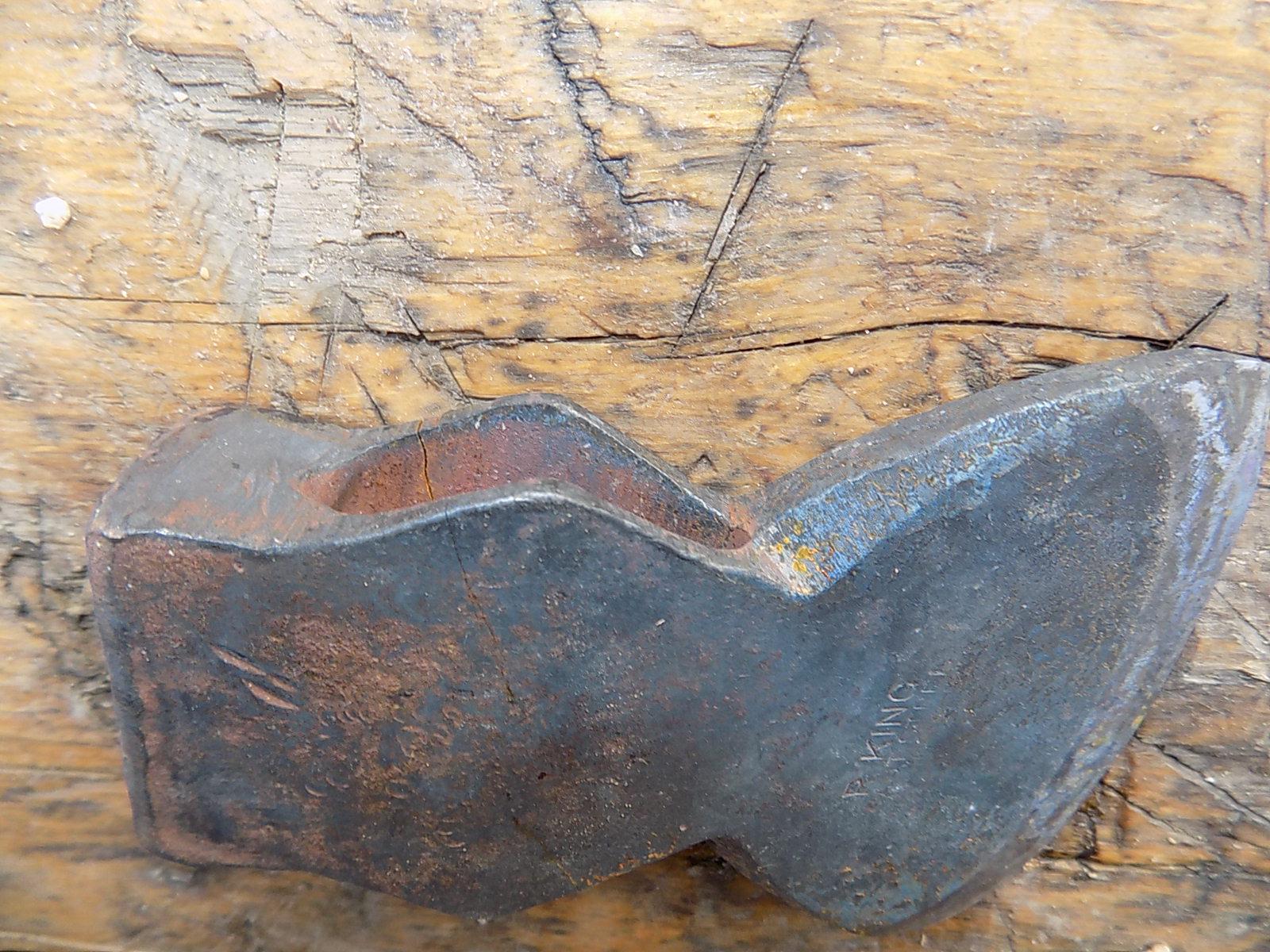

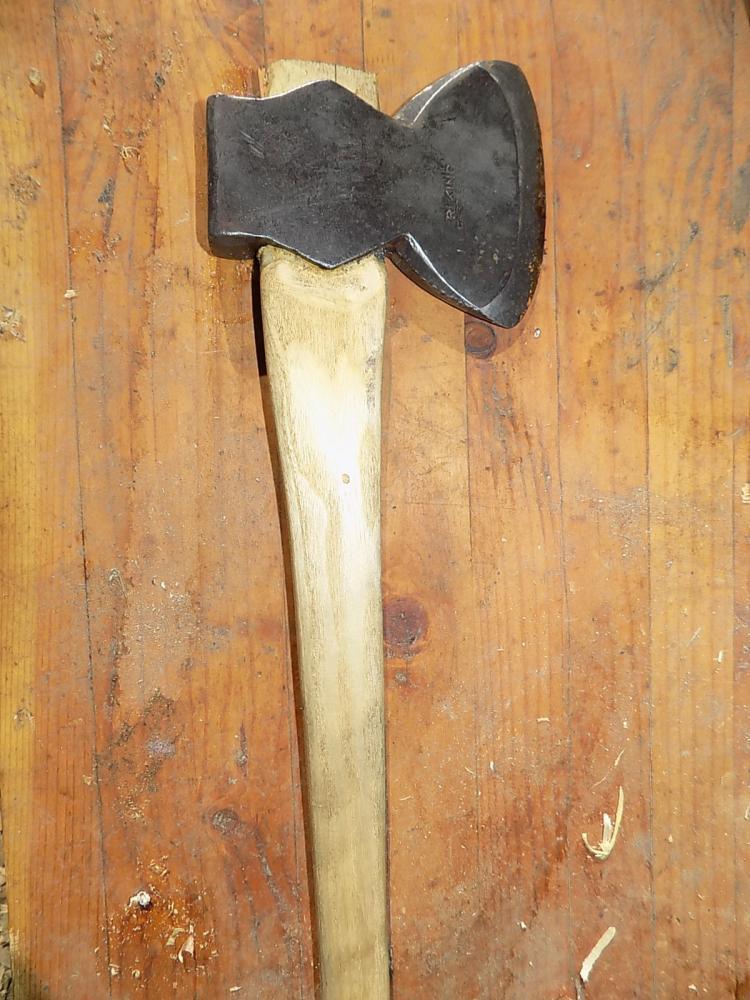

Cleave Posted December 4, 2019 Share Posted December 4, 2019 So I got this old half hatchet recently. It is marked "R. King Cast Steel Made in United States." A quick wire wheel de-rust, flatten the back a bit, new handle from a honey locust tree. Then filed the bevel. It filed very easily, too easily. Sharpened it up a bit on the stone, and tried it out. The edge rolled over pretty easily confirming my suspicions that the steel is too soft. Now, I've done a bit of blacksmithing recently (still a total newbie), and am wondering if it is worth pulling off the handle and re-heat treating this? Anyone have experience with this? I'd bring just the blade edge up to non-magnetic heat, then try oil quench first, then water quench if it didn't harden enough. Then temper it in the oven (I have a great wife). I suppose since the tool doesn't hold an edge well now, there's really nothing to loose if I'm careful and don't burn it up. Link to comment Share on other sites More sharing options...
ThomasPowers Posted December 4, 2019 Share Posted December 4, 2019 Is that a hewing hatchet, bevel only on one side, or a felling hatchet bevels on both sides. If you want to use it I'd try heat treating, much the way you mentioned save that I might go with brine if oil didn't work. Link to comment Share on other sites More sharing options...
Cleave Posted December 5, 2019 Author Share Posted December 5, 2019 Yes the other side is flat for hewing beams. I have no real reason to keep tools that don't get used. Also, should I normalize 3x before heat treat or take it straight to heat treat? Link to comment Share on other sites More sharing options...
ThomasPowers Posted December 5, 2019 Share Posted December 5, 2019 Don't know that without you telling us---Al foil hat must be working. Did you flip the blade around when rehafting? And if so did the eye support that? (Bevel side up to the left in first picture and bevel side up to the right in the second picture.) Some eyes have an even hourglass and others have a biased hourglass. Anyway go for it! Link to comment Share on other sites More sharing options...

Cleave Posted December 16, 2019 Author Share Posted December 16, 2019 Well, my hasty side got the better of me. I got the campfire forge going, heated the blade side to a red, checked on the magnet, let it cool for maybe 10 minutes. Put back in, heated blade side a bit hotter (to make sure the whole way across the blade was hot enough). For some reason, I went straight for the water quench as I only have about a gallon of used motor oil and a #10 can on hand........ Got some warm water in the 5 gallon bucket, and quenched, held her in there and stirred it around for a while. There were a couple ominous pops. A file couldn't touch the edge. My gracious wife didn't complain while I tempered it in the oven at a bit over 500 F, got a nice blue color on it. Then I noticed, twin cracks halfway through the sides of the eye one on each side. Should have heeded better wisdom and quenched in oil first! Or maybe don't hold it in the water so long, or don't heat up that hot. Not sure which it is. But still, a good experiment and learning experience. Now.... I have access to the father in law's welder but am pretty new to that myself... would it be a good idea to grind a v groove on the cracks, preheat, and weld the cracks back, then re heat treat??? Really this is just for the learning experience at this point. Link to comment Share on other sites More sharing options...
ThomasPowers Posted December 16, 2019 Share Posted December 16, 2019 Why was the section that did not need to be hardened that hot? I would have suggested only the edge be heated for hardening. Link to comment Share on other sites More sharing options...
Cleave Posted December 16, 2019 Author Share Posted December 16, 2019 With the campfire forge, I don't know if I'm capable of getting the heat that localized. Or perhaps the forge can do it and I haven't figured out how yet. Link to comment Share on other sites More sharing options...
