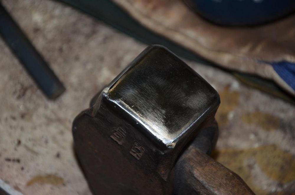

Got a problem with my favourite Hofi hammer. It never hits anything cold, but it's developed a bad nick on one corner and a crack extending down the face. It's not impossible that I could have hit the anvil at some stage, but I can't recall having done so.
So do I grind it back, keeping it cool, or what? I don't want to make it worse! It's a very comfortable hammer and I use it a lot. Also quite expensive when you take into account freight from Germany. I would like to rescue it.

Can you include a photo of the Hofi logo, and other markings, usually on the side of the hammer?  This will help determine if your hammer is forged or cast.
Either way I see a narrower hammer face in your future.  Unless you can get some kind of warranty replacement you will need to grind that crack out.  The crack will most likely continue to run, so I would address it before using the hammer further.  I have made similar "repairs" to a Swedish style MOB hammer that I got at a flea market by grinding around 1/4" off the width of the face on each side.  Definitely keep it cool while grinding.
It looks like the initial crack was made by dropping the hammer face on that corner onto a hard surface (concrete floor?).  It is hard to tell from the photo, but it is possible the head was not correctly normalized and the grain structure a little chunky.  Or perhaps Hofi hammers have particularly hard faces.  I drop hammers in my shop pretty regularly, but maybe I've been lucky.  Of course the only Czech style hammers I have are custom made (mostly by me), so YMMV.

Appears to be stamped in the photo.  I would expect this is a forged hammer head.
No matter the cause, you have a problem.
Either its under warranty or you have a repair to do.
grind the face down until the crack is gone, then file out the sharp edges on the corner crack.
You may have to take the face down to the bottom of the chip in the first pic. This may mean you will need to re-heat treat the face.
With a bit of luck, the crack is not deep and you will only need to dress the corner chip.

If your bent on repairing, you could probably have it gouged, then tig it back in. If done properly it shouldn't seriously affect it. This isn't a garage deal tho, to properly weld the alloy steel it should be preheated, and then reheat treated after welding. A tool and die shop could probably fix fairly well if you don't want to remove the affected material/alter the hammer geometry.
Reading a little more in the sticky about the hofi hammer, he mentions he used C45 for the forged hammers, which to me sounds like a 1045 carbon steel. Really nothing to special about it. If it was welded with an appropriate medium carbon filler at the appropriate heat treat, annealed well, and the reheat treated, it probably wouldn't be worse for the wear.
Or if your feeling really adventurous, you could take off a known amount to remove the crack. And then forge weld on a new face. Beyond my skill, but should be possible.
To me it appears to be a forged hammer and the chip and crack are superficial and not past the hardened area.
Depending how you feel about doing this, you can grind the crack out, fill the crack in with stick rod and heat treat.

The old one is all but useless apart from the cross pein end, so I have given it to a local engineer/welder to rebuild. A couple of pics of the damaged one and the newy:

OK, so our local welder removed the cracked section and welded in a new piece. I reckon he did a superb job, and the hammer is now back in use. Here's a picture of the repair:
