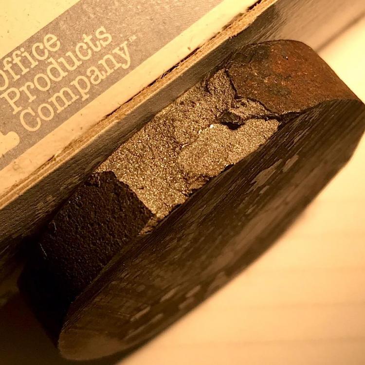

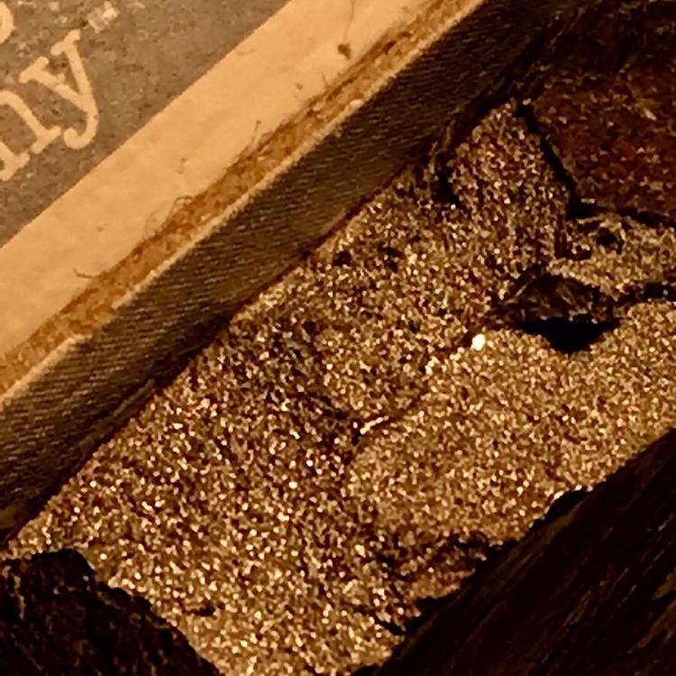

May 18, 20197 yr I have two 3 to 4 foot long pieces of 1.5” round stock of an unknown type of steel. I picked them up sometime last year at Nimmo’s, a salvage yard here in Purcell (now closed due to family illness). I spark tested them after I got them home and could see they contained carbon. I cut an inch off one of the bars to see if I could harden it. I was using a steel chop saw and it took a very long time to cut. I have never cut anything that thick before, but have quite a lot of experience with cutting angle, channel iron, and flat bar used to manufacture utility trailers and truck beds. Those cut like butter compared to this. It didn’t harden much at all when I quenched the piece in oil, but hardened very well in water. Chris, one of the guys who posts here and is also a Saltfork Craftsman member is interested in making a hammer, so I took one of the two rods and a very large tie rod end to give him his choice of one or the other. With Korney’s help, we cut of a slice of the rod, heated it and quenched it in water. Chris then put the slice in a vice and hit it with a hammer to see if it would break. It did. I’ve attached the pics. The grain structure looks very small. The slice itself feels unusually heavy, which brings me to the point of this post. Is it possible to get even remotely close to an ID based upon density? I work in a clinical lab so access to a certified scale and a graduated cylinder is not a problem. The density calculation itself is easy if you have that. The steel also feels ‘funny’, for lack of a better word, when sanding it by hand. It doesn’t sand easily but when sanded, the surface just looks great and has a wonderful feel to it. Lame description that doesn’t give any useful information, but it is the best I can do. I have always carried bits of wood, stone, or metal in my pockets to fiddle with when thinking or waiting. This little sliver of steel is very satisfying to carry. Any ideas on how I could identify what sort of steel it is? Are there labs that could ID it for me? Cost isn’t really a concern for me.

May 18, 20197 yr Gas chromatography or xray spectrometery will give you a good idea but neither is perfect. Calculating it's mass and density might tell you how far from low alloy steel it is but won't tell you what's in it. The higher the carbon content the lower the mass. The break looks darned granular to me, I wouldn't call it good but I'm looking at a pic on a computer so it's FWIW. Steel that thick tends to bog hot saws down and cut slowly so that's no indication. The sparks coming off the blade is a better indicator but not a good one. Spark testing was reasonably accurate in the day of simple steels when there were only trace elements in them. Now steels are designer stews, things like: vanadium, manganese, chrome, molybdenum, cobalt, tungsten, copper, lead, aluminum, etc, etc, don't spark like steel, they aren't. If what the stuff is really matters it's lab time. You'll want to decide how accurate a result you want first. Running an xray spectrometer over a sample might run you $10 in a scrap yard where gas spectrometry is probably significantly more expensive and if you want a full blown chemical analysis you're looking at crazy money. Frosty The Lucky.
